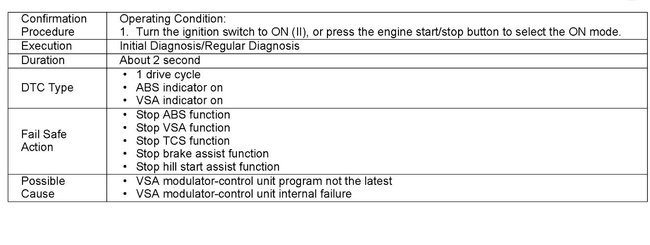

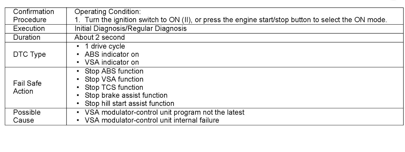

Good morning,
Did the parts store clear the code? If they did, shame on them. That is why they will not do the repair.
The code is an ABS code and has no connection to the other code.
NOTE
- Initial Diagnosis:
The initial on-board diagnosis occurs right after the ignition switch is turned to ON (II), or engine start/stop button is pressed to select the ON mode, and the ABS/VSA indicator comes on, and continues until the indicator goes off.
- Regular Diagnosis:
The regular on-board diagnosis begins right after the ABS/VSA indicator goes off, and it continues until the ignition switch is turned to LOCK (0), or engine start/stop button is pressed to select the OFF mode.
- Review "How to troubleshoot the VSA system" before doing the DTC troubleshooting procedure.
- Test-drive the vehicle according to local traffic conditions and regulations. Do not test-drive on a lift unless specified.
- The possible causes shown may not be a complete list of all potential problems, and it is possible that there may be other causes.
