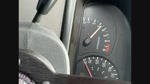

Video of RPMs.
Jun 5, 2025 at 12:40 PM
Wow, yep that is not right, the throttle bore must be open, can you remove the air intake and inspect it with a flashlight? The butterfly must be closed. Please upload an image.
