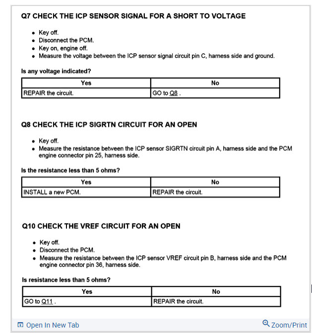

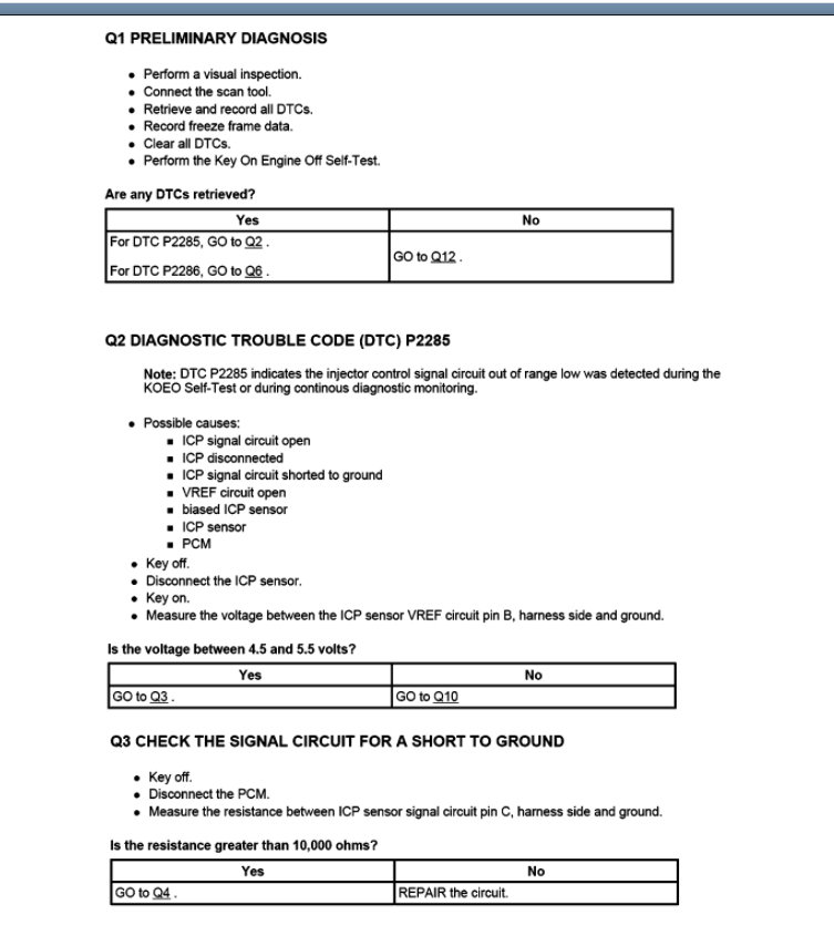

(6.0 power-stroke) My truck will not start. I have code for low ICP, EOT sensor high input, and ECT circuit high. I have ruled my ICP is bad by the oil leaking, but it will not start when I unplugged it, and it should start. The ficm Voltage is at 48 cranking and not cranking. The batteries are good to go, the fuses are goods. Have any idea what is wrong and what I could do to test?
