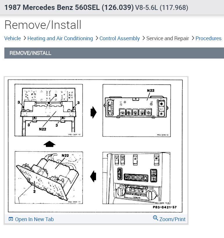

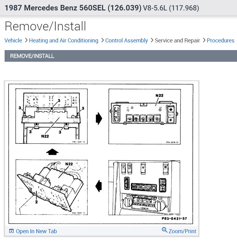

Yep, common when the control head goes out in these cars. here is a diagrams to show you how to replace it. Check out the diagrams (below). Please let us know what you find. We are interested to see what it is.
