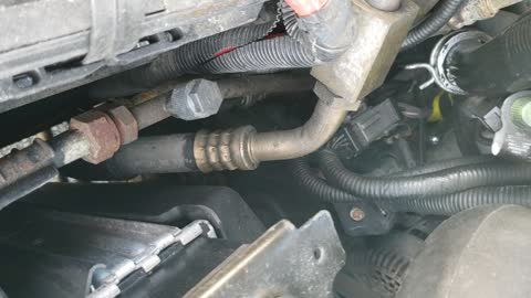

Hi, I purchased an E150 conversion van and noticed a knock that one mechanic said was catalytic (somewhat common from my research) and another said it was a rod knock (wallet visibly scared). I'm hoping its the catalytic converter. The knock does seem to speed up when gas pedal is pushed. I have driven it about 70 miles (city and highway) and have not lost oil pressure and no lights have come on. I did an oil change immediately with synthetic 5w20 and the old oil looked fine. I can't find exactly where the noise is coming from. Please let me know what you think. Thank you
PS: sorry about the door ajar alarm on the 2nd video, but you can still hear the knock

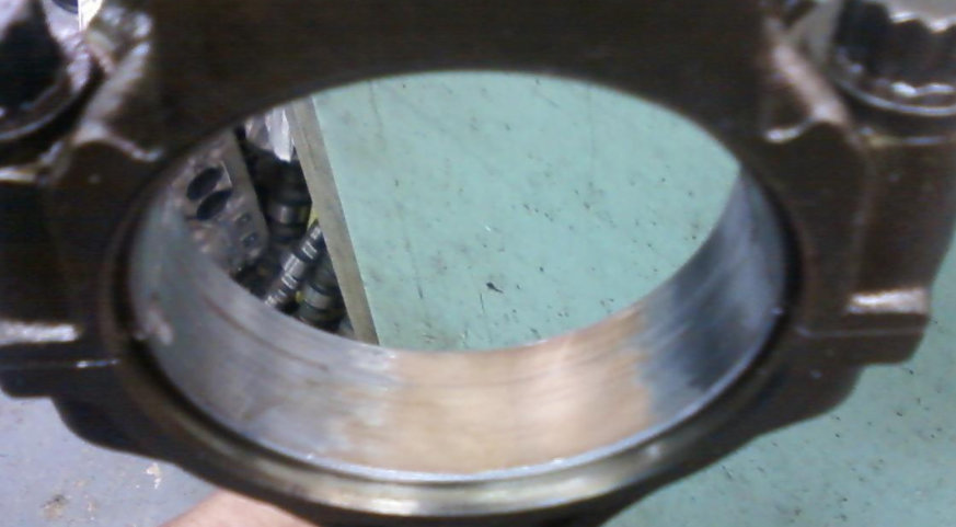

Below is what bearings that are worn look like or worse they have grooves cut into them which means the motor was only a short time away from locking up.
Please let us know if you have questions on this. Thanks
