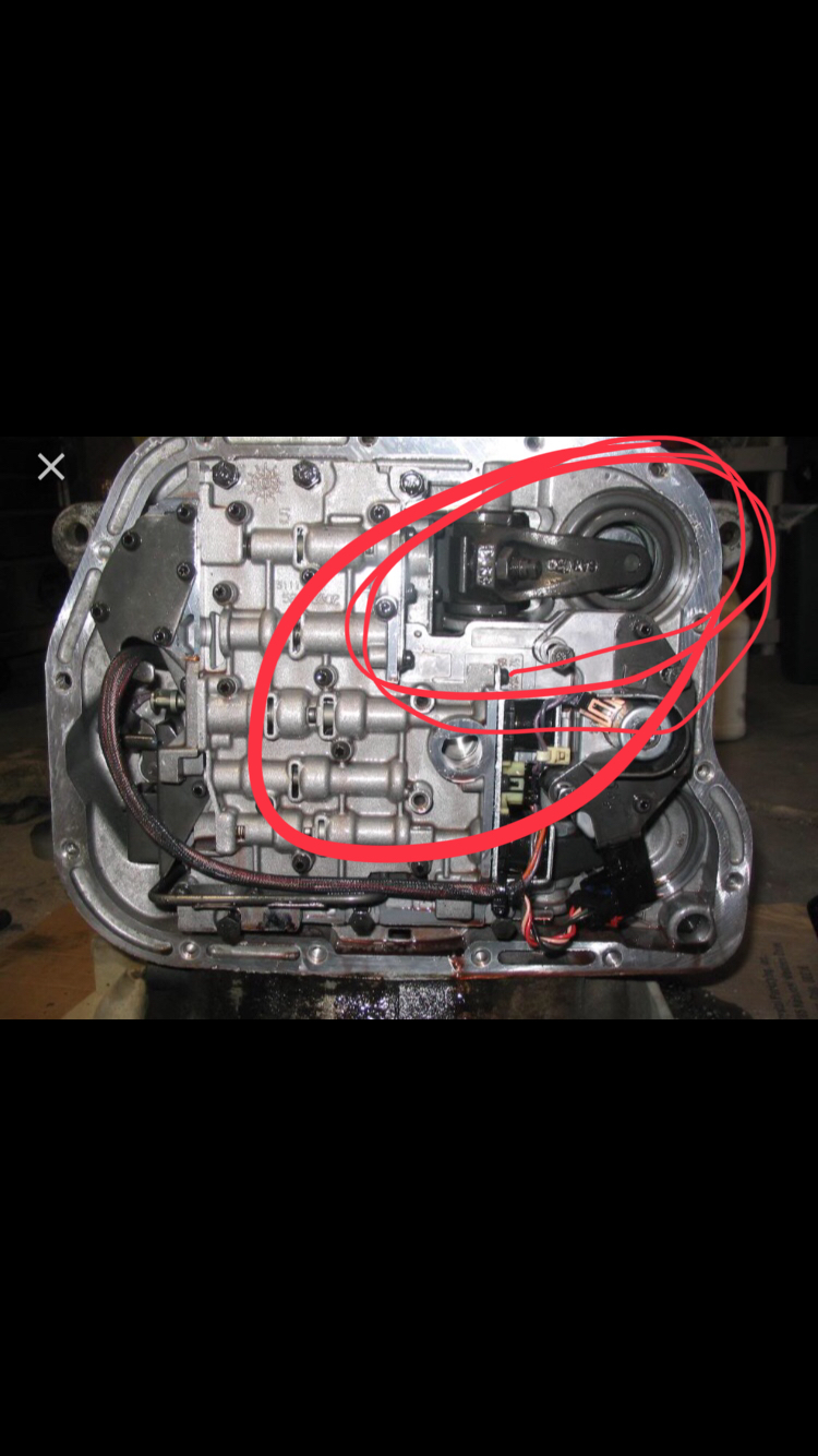

Usually the servo housing is part of the case. Do you have a picture of what you are looking at?

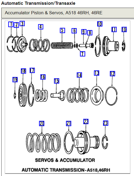

Yes, just found one on the internet. The housing is not cracked it is the bottom round piece.
Jun 24, 2018 at 4:11 PM

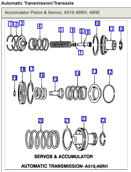

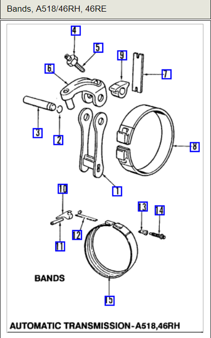

It looks like you can change that out without removing the transmission there is a pin that holds the lever arm in to the case which you will need to remove. Here is a guide on the servo so you can see what you are in for it will be spring loaded so be careful.
