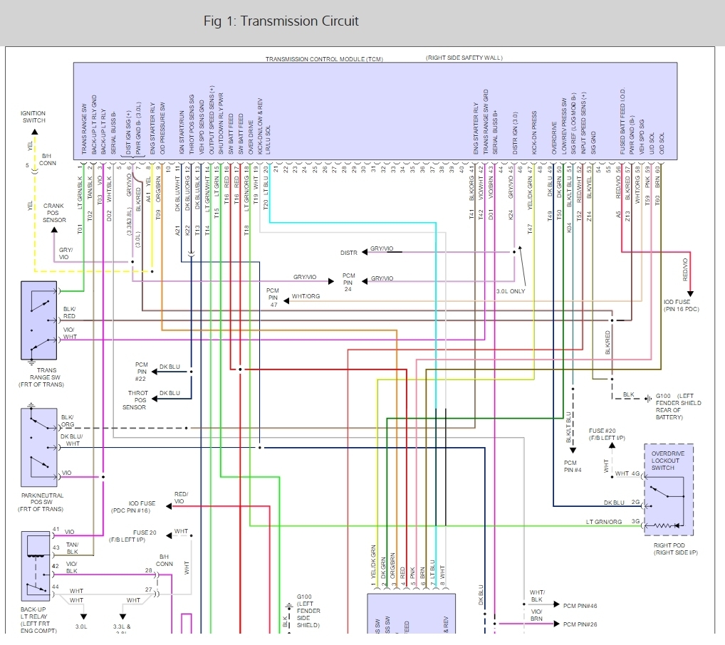

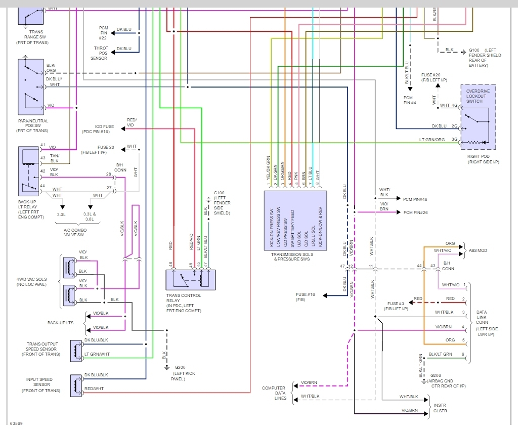

Hey Dodgepodge,
Like I dream of Jeannie, love it cant belive that didn't work. Here is a complete wiring diagram so help with all that blinking and swearing.
Please let us know what you find so it will help others.
Best, Ken
