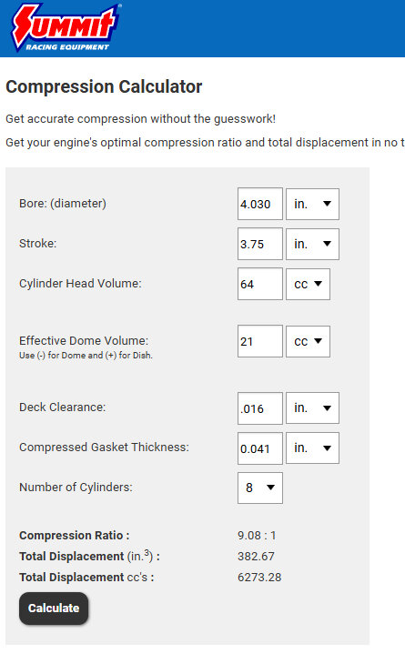

Thank you so much for watching the 383 series! So for lowering the compression ratio you either need a bigger combustion chamber in the heads or bigger dished pistons.
To decide on which to do check out this awesome compression calculator from Summit Racing https://www.summitracing.com/popup/calcsandtools/compression-calculator?srsltid=AfmBOor9OVeILCrtBhOANTvZvfXQiMxU7D7B85aI_YPnNPpKLJ2HGuih
If you use the same cylinder heads I am using, you can put these pistons in and get 9:1 which could run on 87 pretty easily and have good power still. https://www.summitracing.com/parts/uem-kb101-030/make/chevrolet
Just double check the wrist pin size and the cylinder bore!
For a camshaft something like this would be a good bet for a truck 4x4 application https://www.summitracing.com/parts/sum-1102/make/chevrolet
I have uploaded the calculator to show what it would look like with this combo.

It would change the wrist pin height and affect the total volume of the cylinder a bit. My apologies. These should be everything right https://www.summitracing.com/parts/uem-kb121ktm-030/make/chevrolet but again check the wrist pin diameter. With these your compression ratio should be high 8's which is still solid for a street truck.
