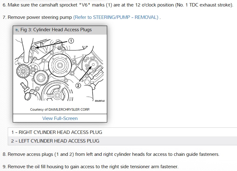

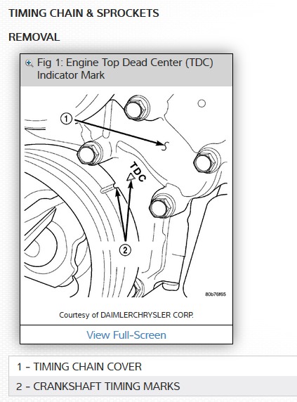

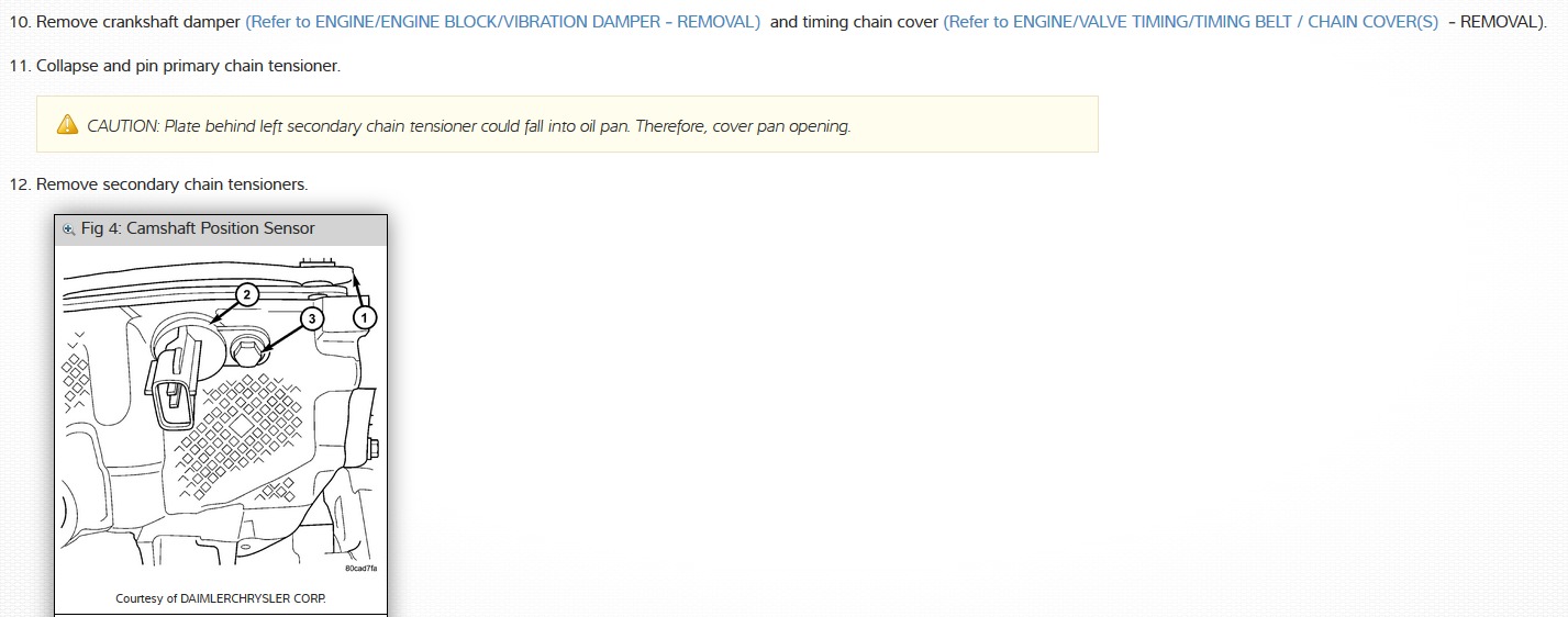

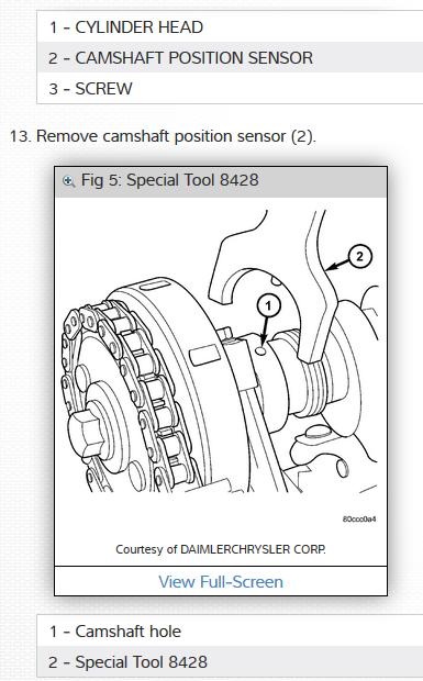

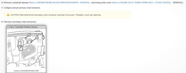

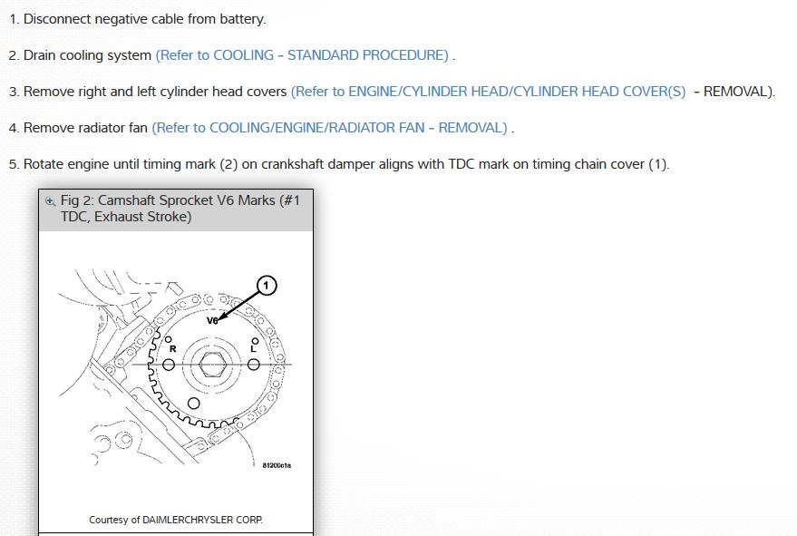

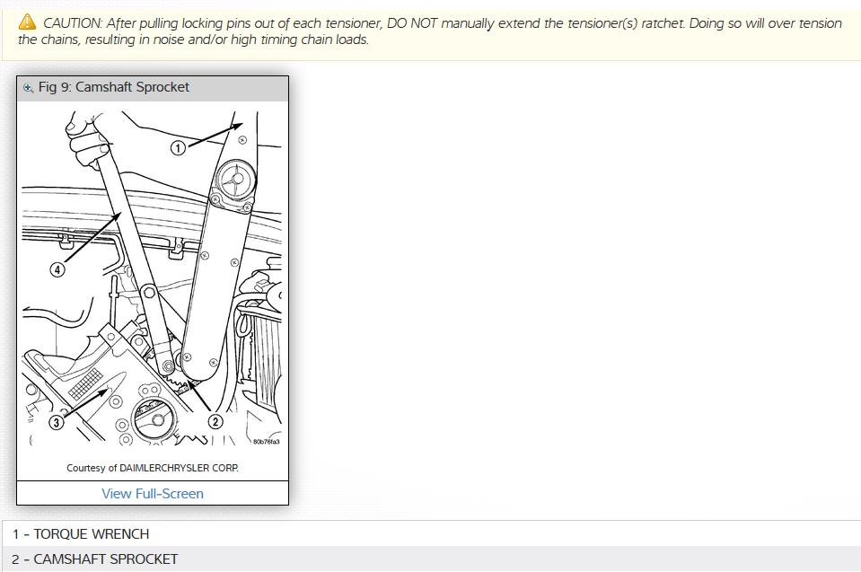

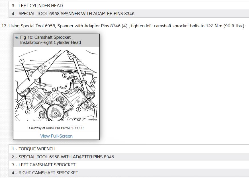

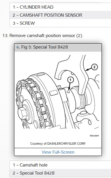

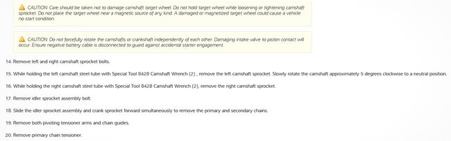

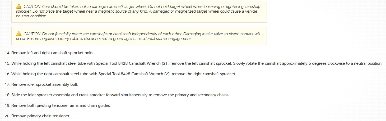

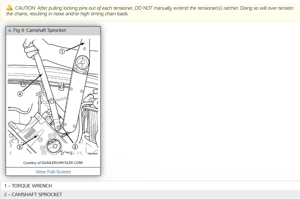

You will need the Timing Cover Gaskets and Valve Cover Gaskets. Here is the removal process. If you need anything else please let me know.
Jan 23, 2015 at 5:27 AM

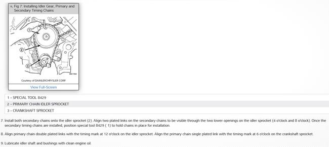

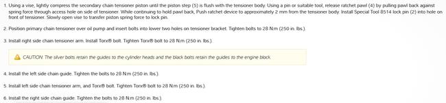

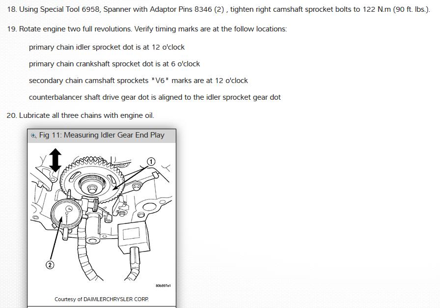

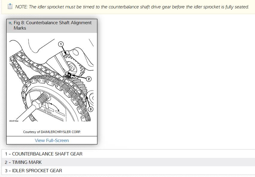

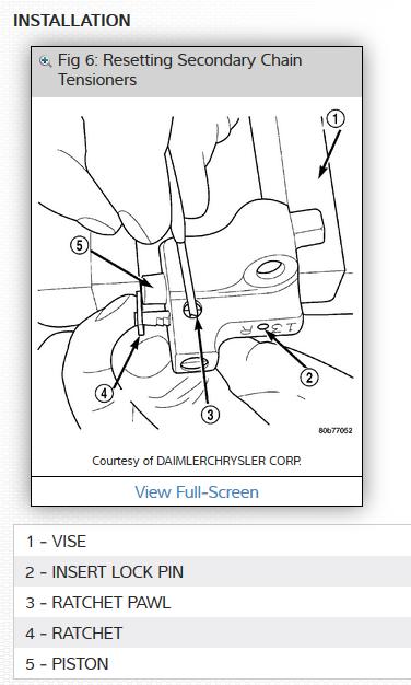

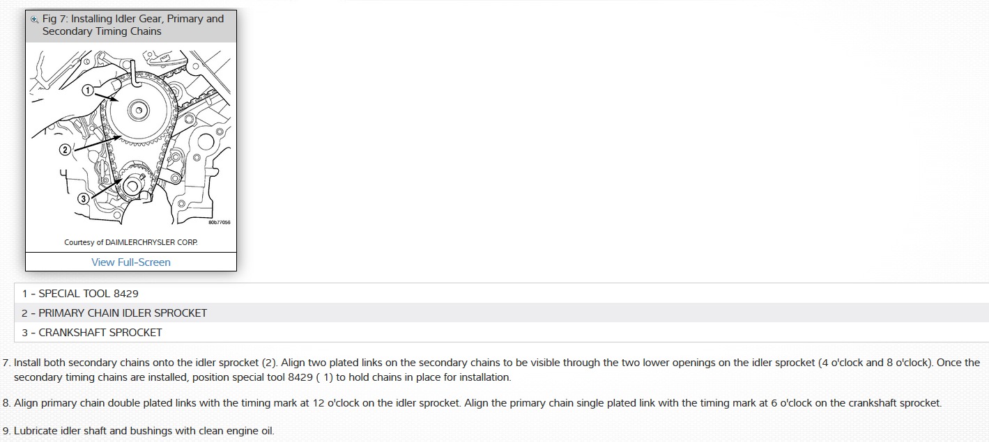

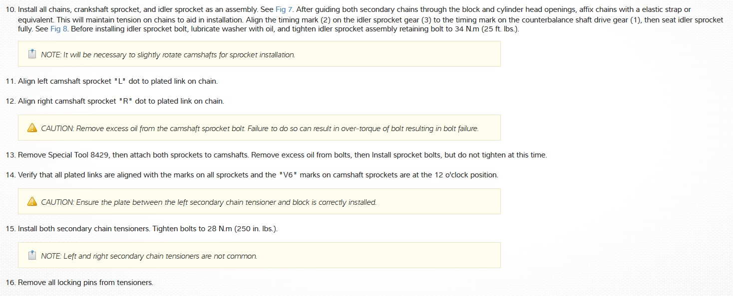

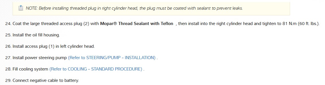

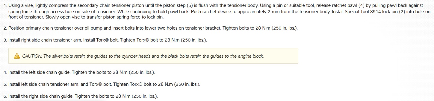

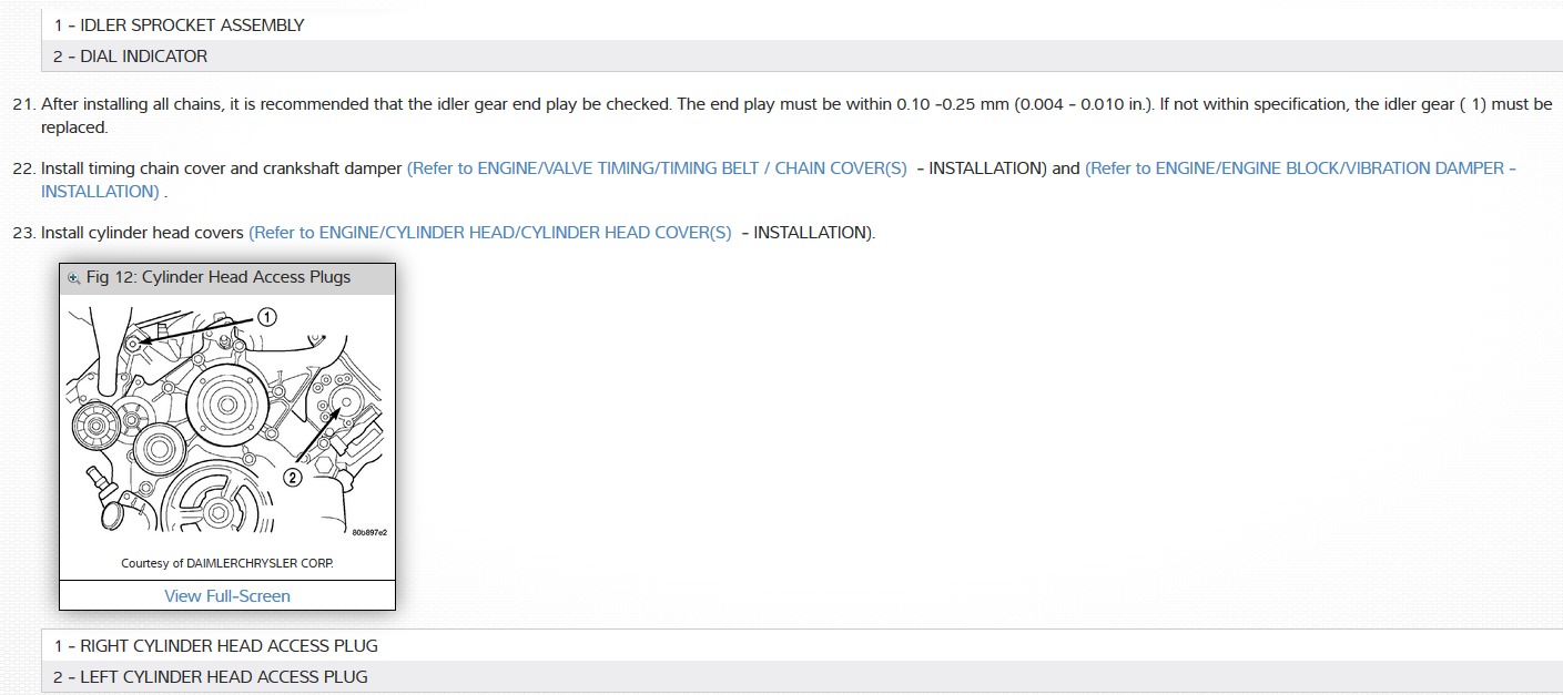

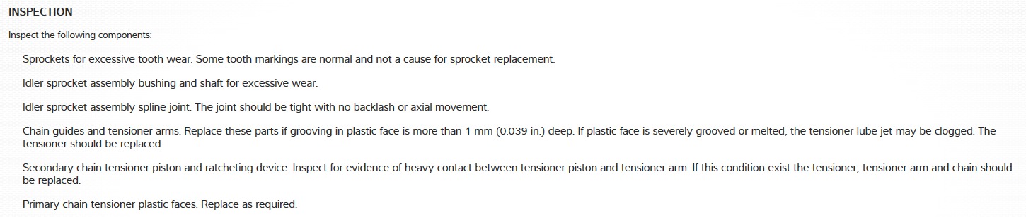

Here is more on the install
Jan 23, 2015 at 5:46 AM
