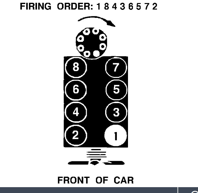

I took the spark plug boot off that goes to the distributor and determined no spark; would not arc. I think it's called the coil pack. no fuel to the carburetor.

So I did it; codes 12 15 22.

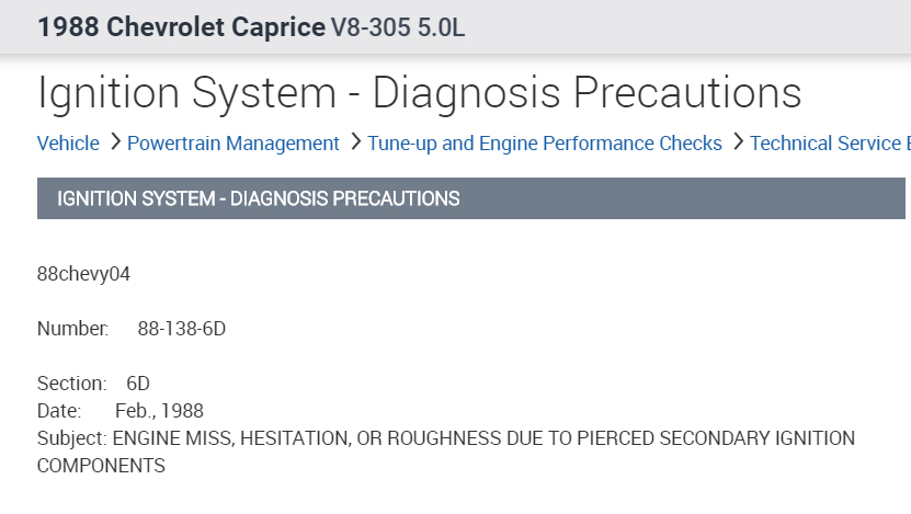

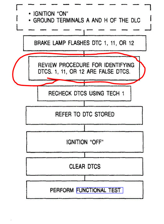

According to the manual, code 12 is a false code. Take a look at the attached pic. That is what I find when looking for a code 12. Are you certain that is the number?
Apr 22, 2020 at 4:32 PM
GEE 91
  • 19 POSTS
Yes 1 flash then 2 flashes.
Apr 22, 2020 at 8:26 PM
GEE 91
  • 19 POSTS
I'm confused about what you mean by the picture. can you explain it a little bit?
Apr 22, 2020 at 8:27 PM
GEE 91
  • 19 POSTS
Yea, I have done it more than 1 time.
Apr 22, 2020 at 8:29 PM
Basically, I attached the pic so you could see, according to Alldata, there is no relevant code for 12. Have you checked for a good ground and power to the PCM?

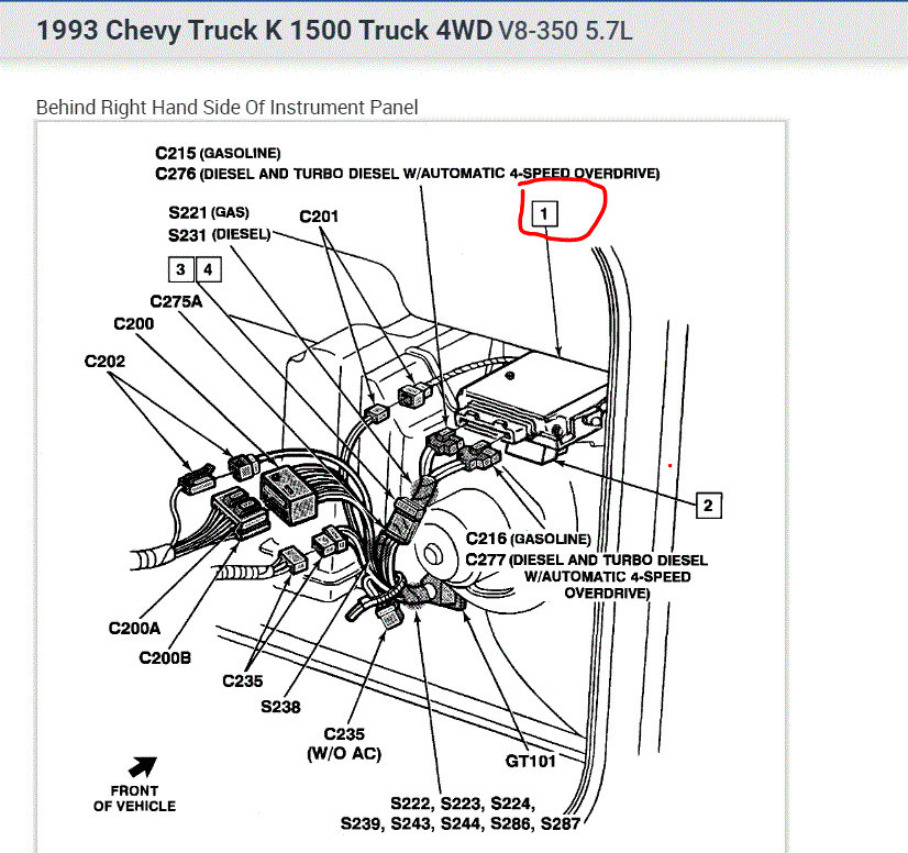

First, before you unplug or reconnect any control module (PCM) make sure the battery is disconnected. You can reconnect the battery after the component is disconnected or reconnected.
I attached a pic of the location of the PCM. To start, first locate and confirm the connections are tight. If they are, disconnect the battery and then unplug the PCM. Check for corrosion, dirt, or any damaged pins.
