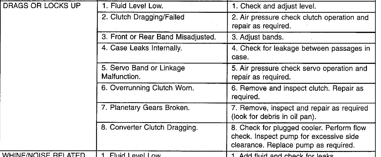

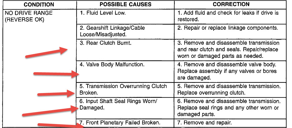

see pics but it may be the overrunning clutch bad or seal rings on input shaft. especially if you didn't replace them or bushings worn to much. you might have a trans guy look at this.
