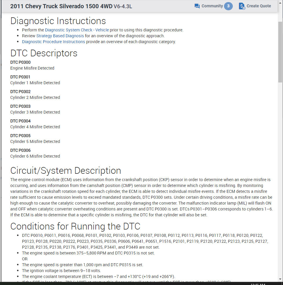

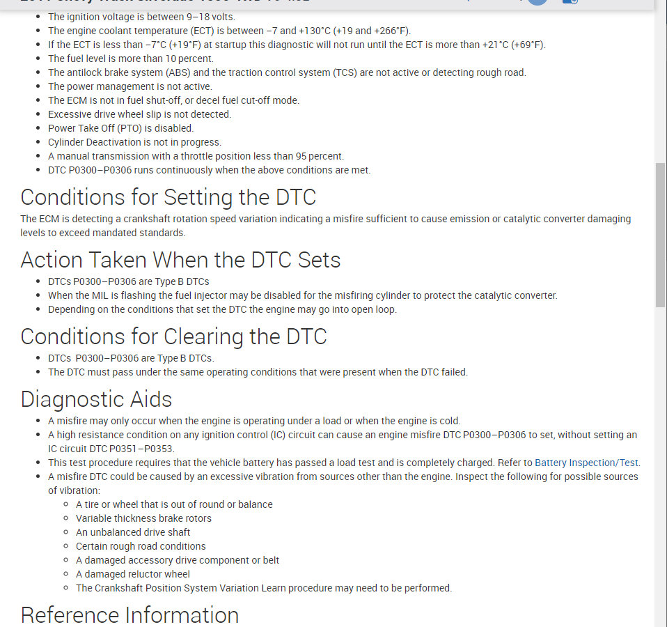

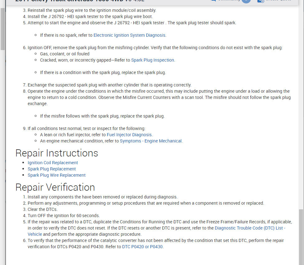

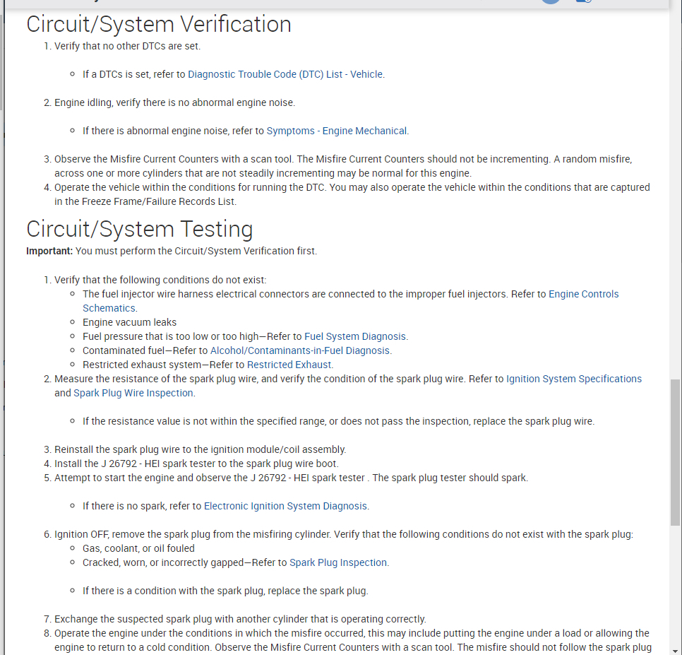

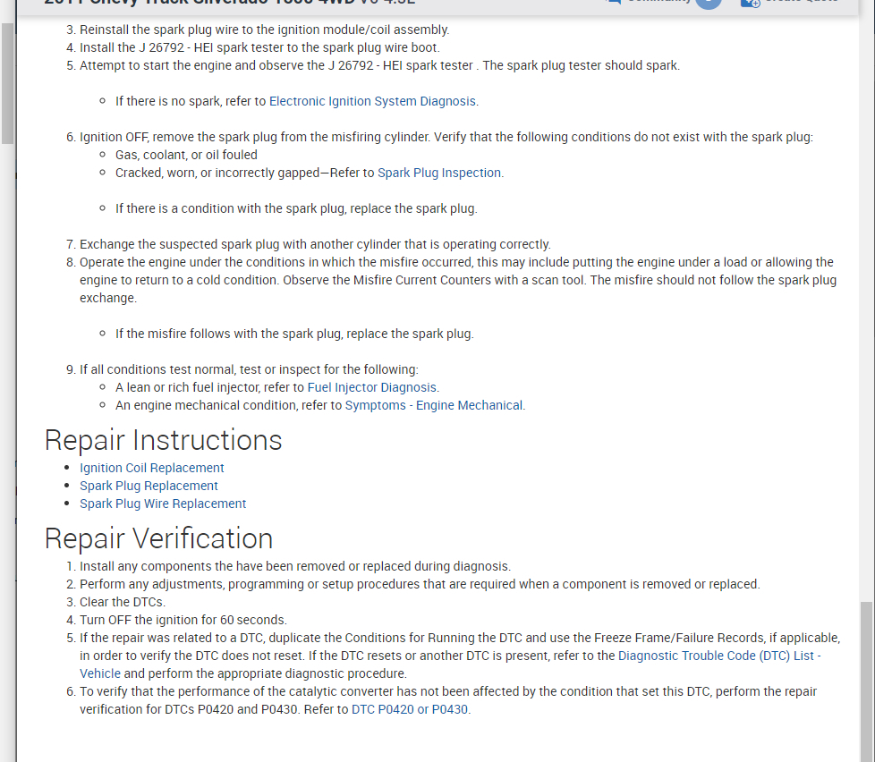

Below is a chart that will help with identifying issues with spark plugs and the process for this cylinder 3 misfire.
However, the sputtering points more to a fuel issue only because you don't have multiple cylinders with misfires. A single cylinder will cause a vibration and slightly less power but if it has considerably less power then that sounds like a fuel issue so we need to eliminate it.
Please let me know what you find. Thanks

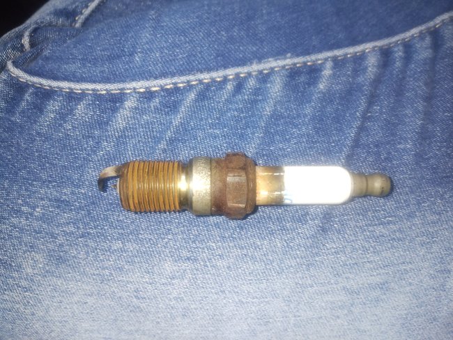

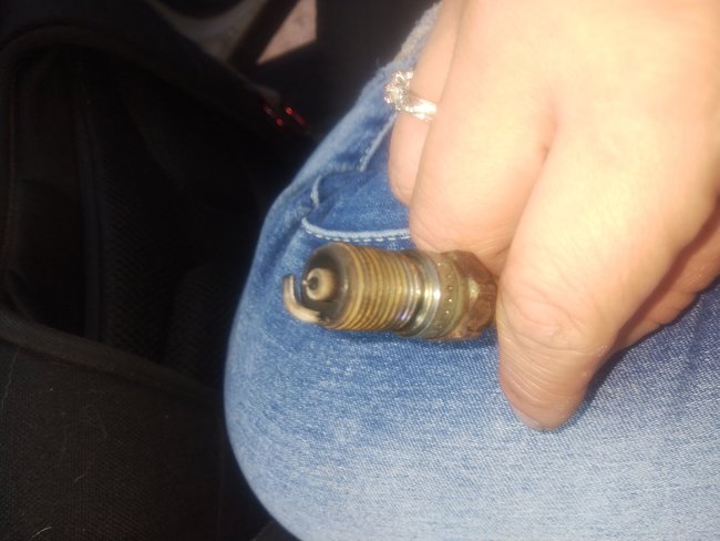

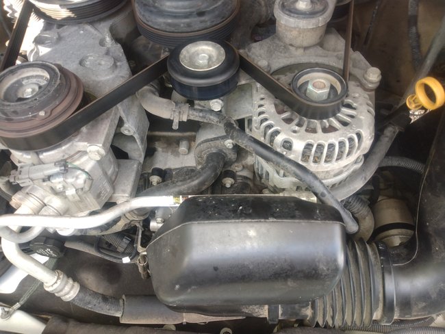

My check engine light came on first then the other ones. Yes it flashes when sputtering.not sure if the pictures help any.
Jun 25, 2021 at 8:35 AM
It looks like the spark plugs need replacement. I would service the MAF and throttle bore as well. Here are guides to help us get the services done:
