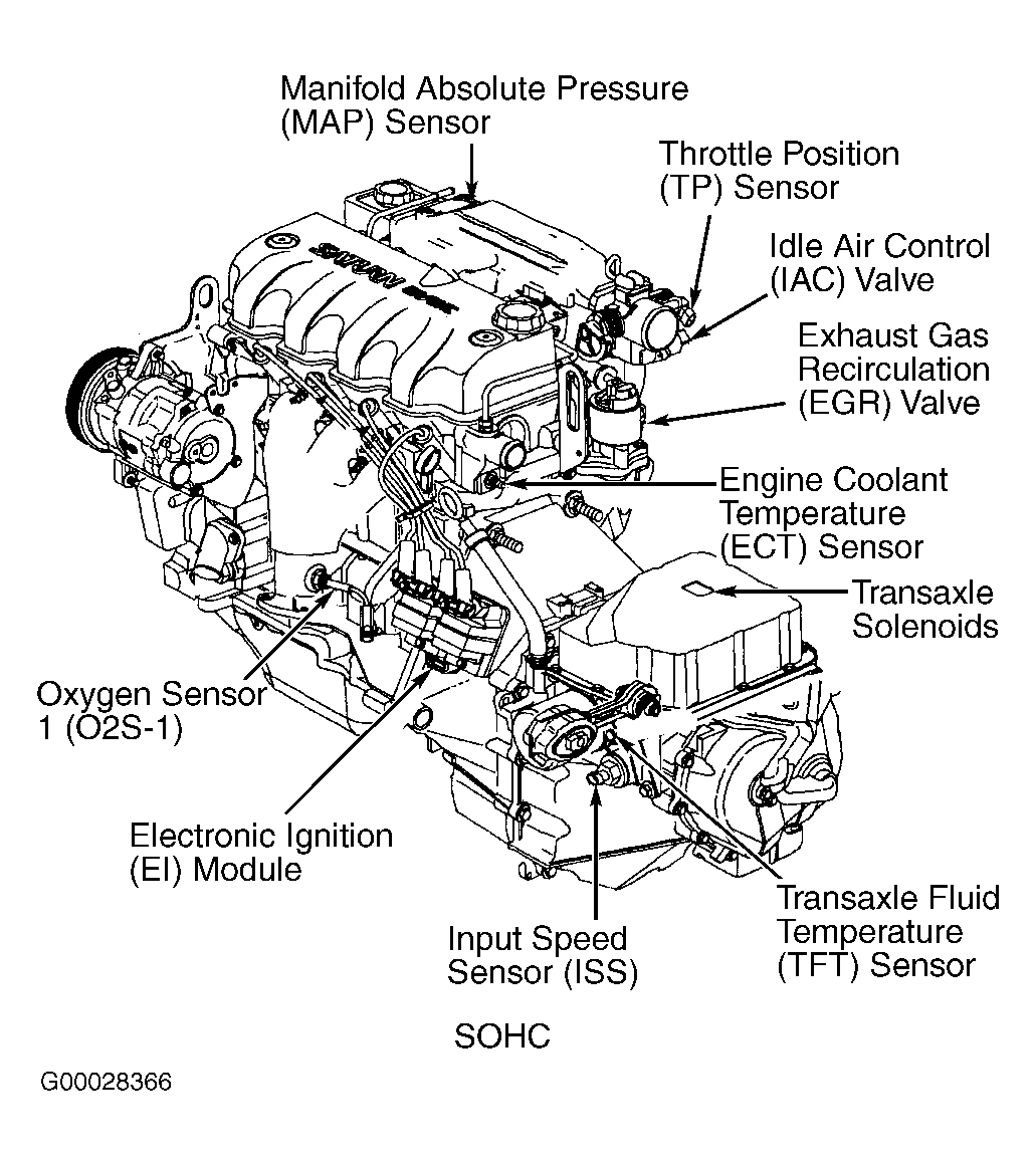

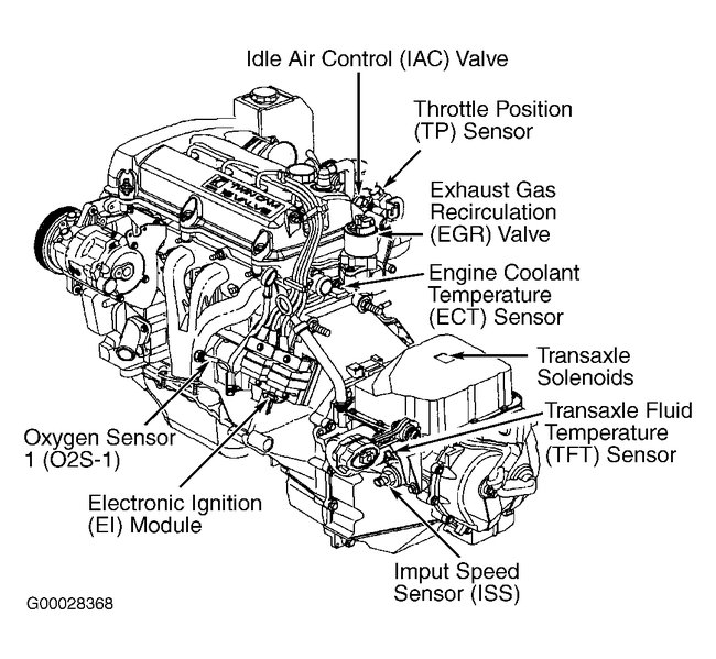

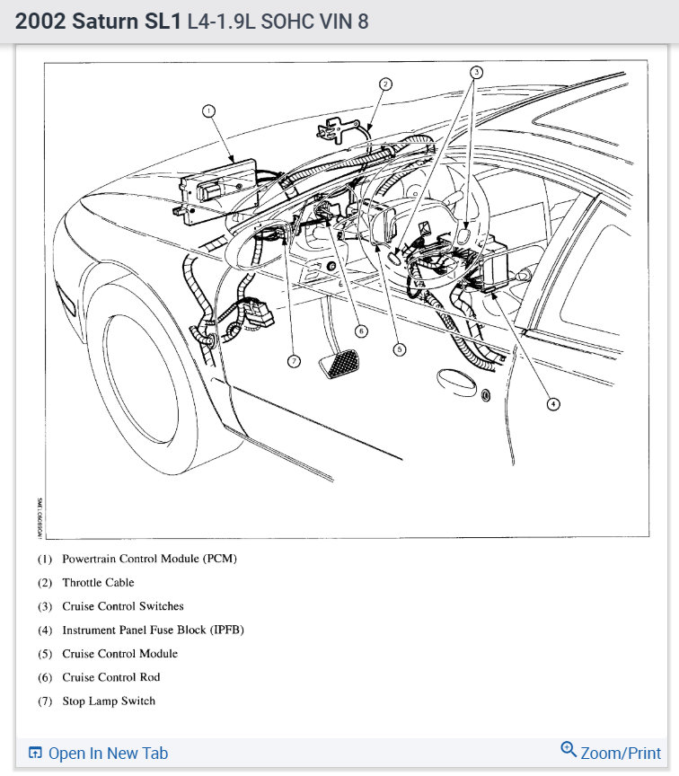

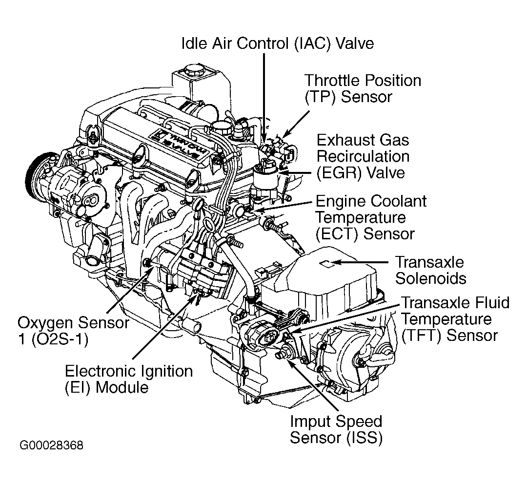

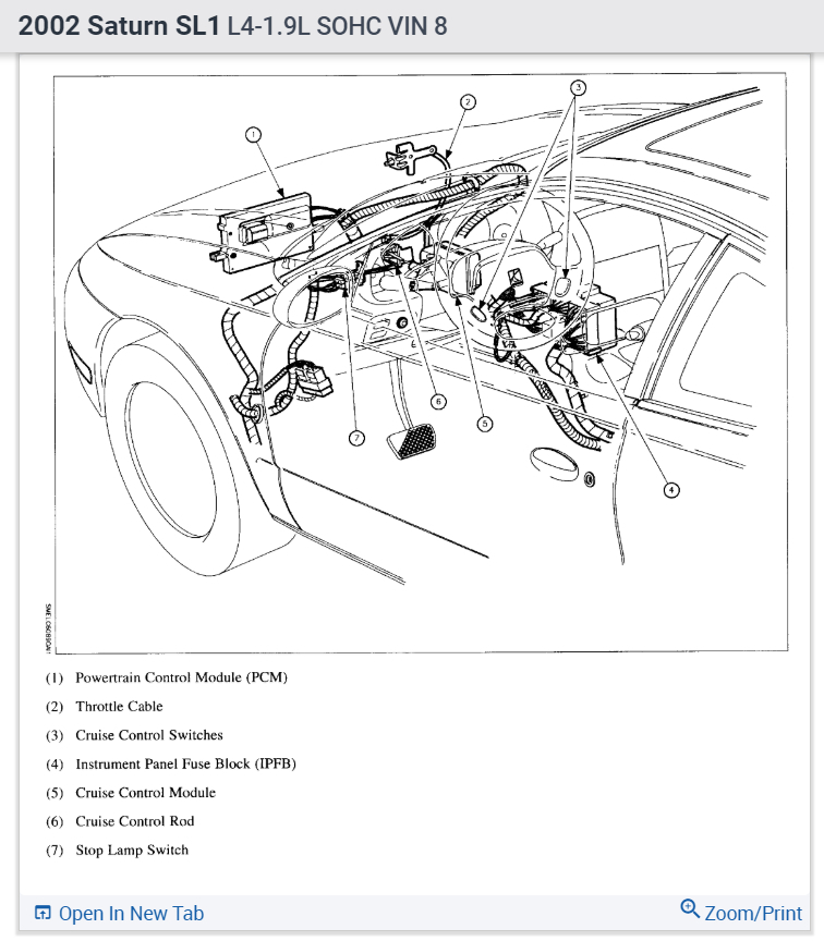

I have seen the PCM go bad and cause this problem as well. I would try a used one because there is no code for this problem to tell us for sure. Here is the location. Check out the diagrams (below). Please let us know what you find. We are interested to see what it is.
