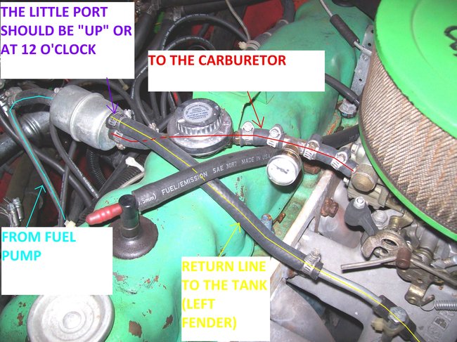

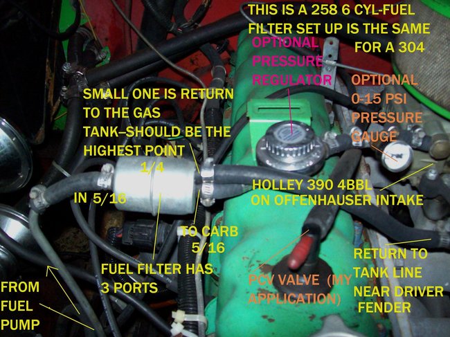

Do you still have a return line outta your fuel filter?
This would be my 1st test/ attempted fix
A separate regulator for each carb might give you more volume, just jacking up the pressure on just one regulator (feeding 2 carbs), may not make up for decreased volume trying to push thru the regulator's internals.
I bet the mechanical pump woulda provided enough fuel! But I'm guessing!
If you are experimenting, maybe increase the fuel line size from the pump on.

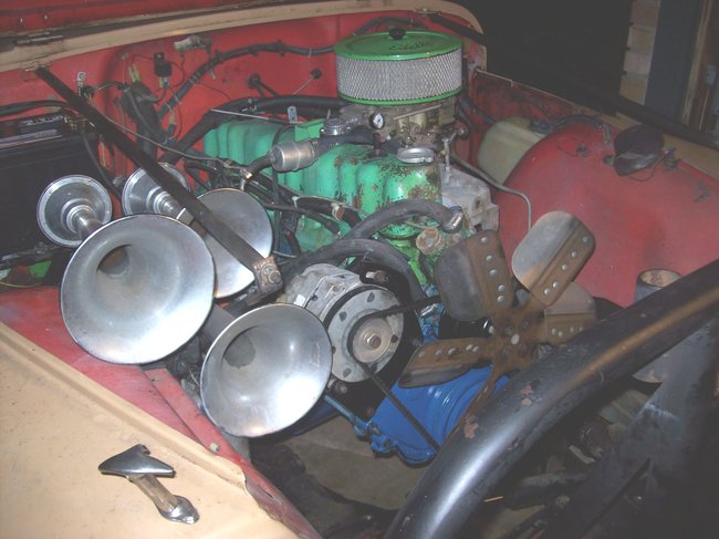

I have a Holley 390 on mine (pic above)
Your turn
