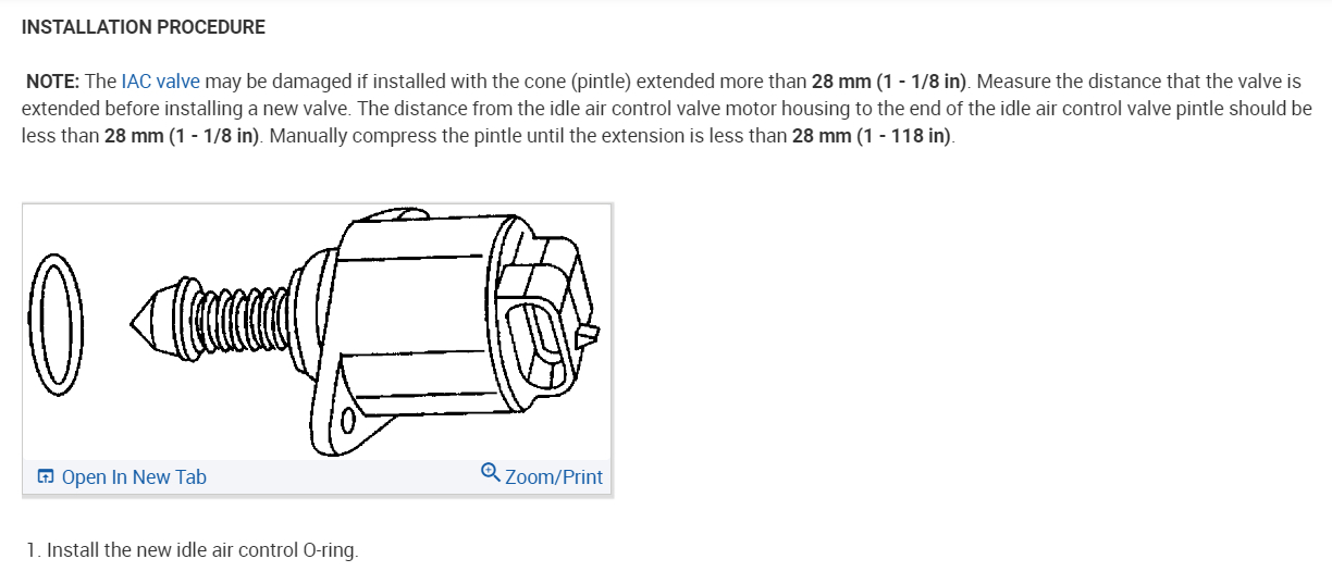

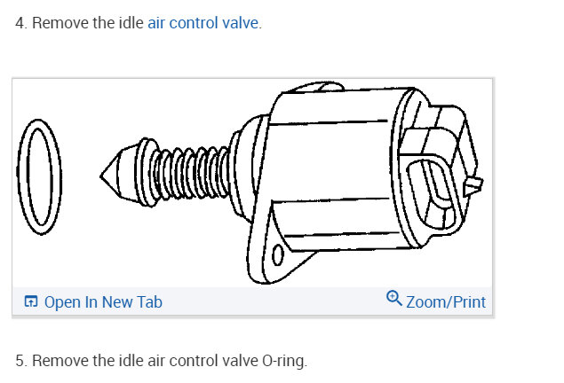

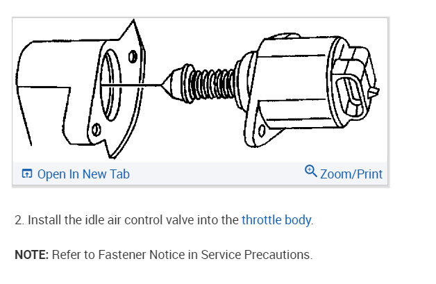

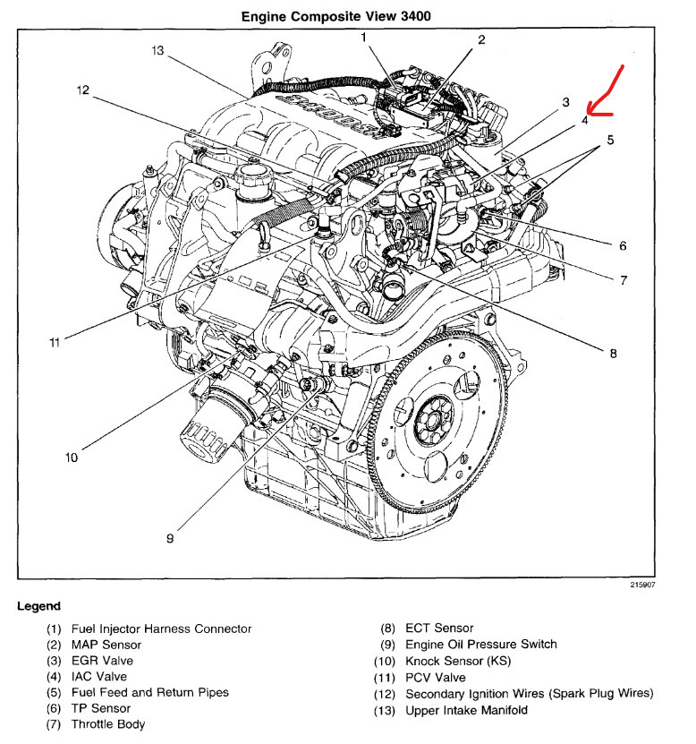

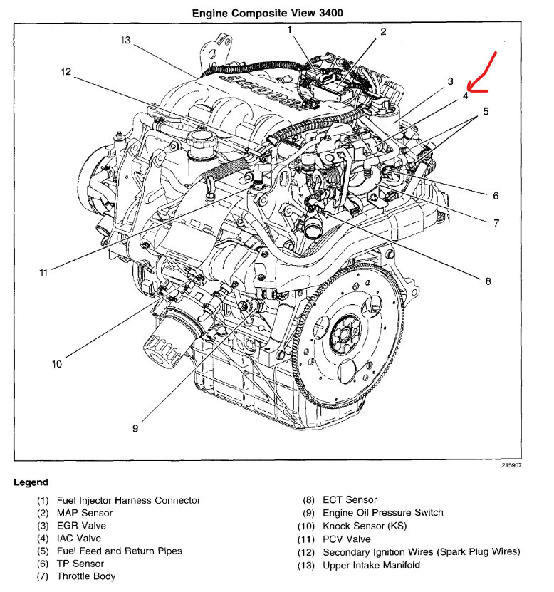

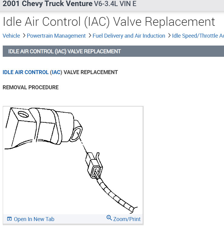

When driving 50+ miles or more the engine will start to idle at 2,500 RPMs. The temporary fix is to turn the key off then on. The RPMs go back to 700. When driving on the highway. I can put the car into Neutral and turn the key on/off and that will temporarily fix the issue. Cleaned the TB, replaced the TPS. Same issue. What is strange is the recycling of the ignition fixes the issue right away. If I continue to drive after a while the rpms will return to 2,500 +. Driving 25 miles to a destination does not seem to activate the issue.
