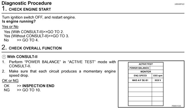

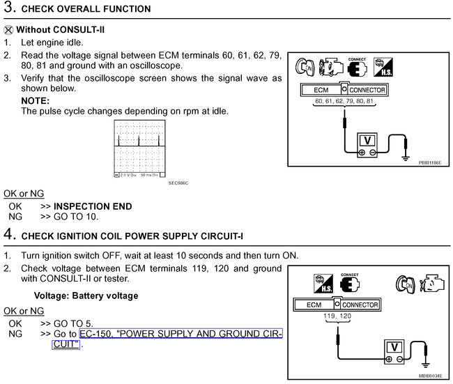

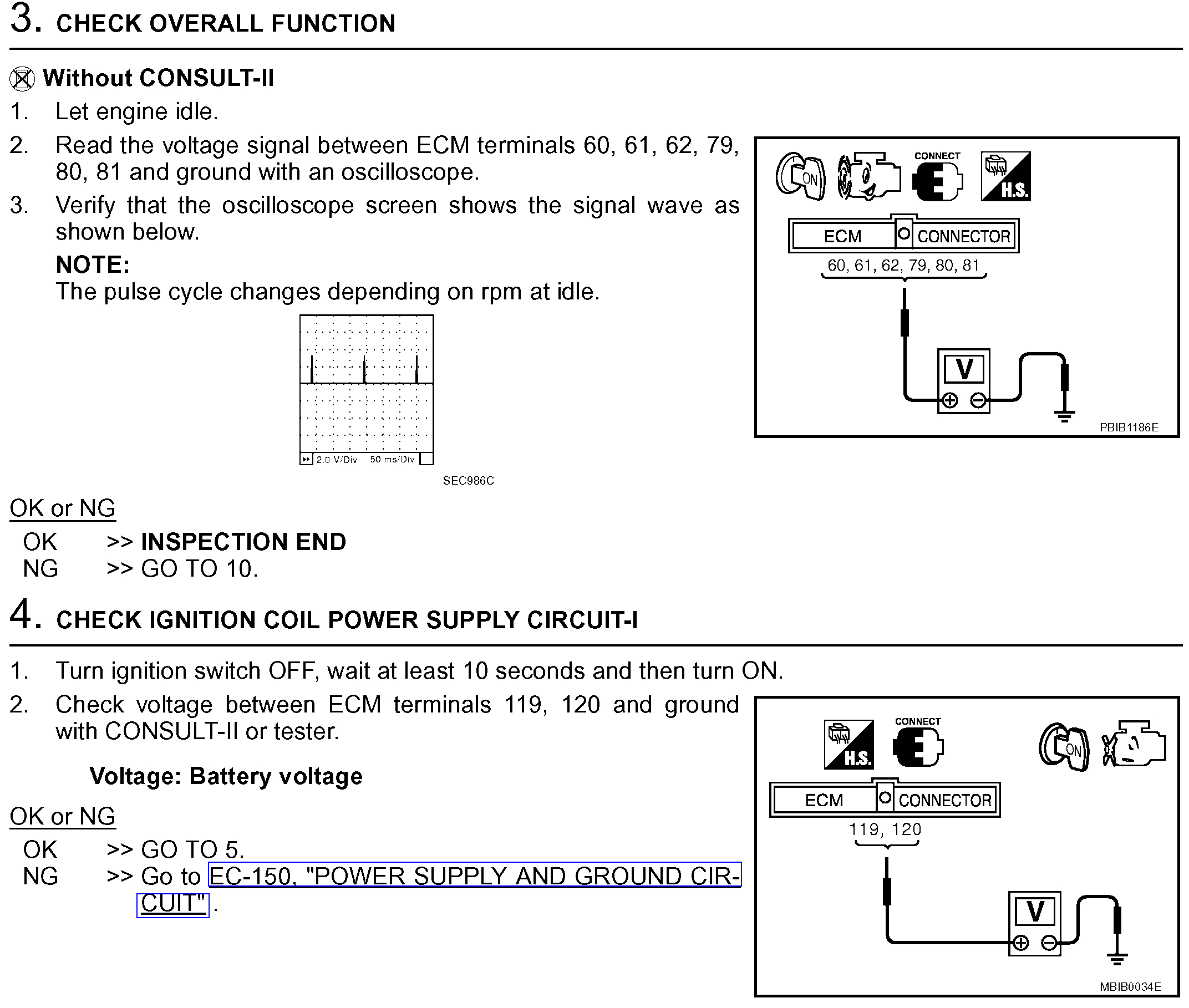

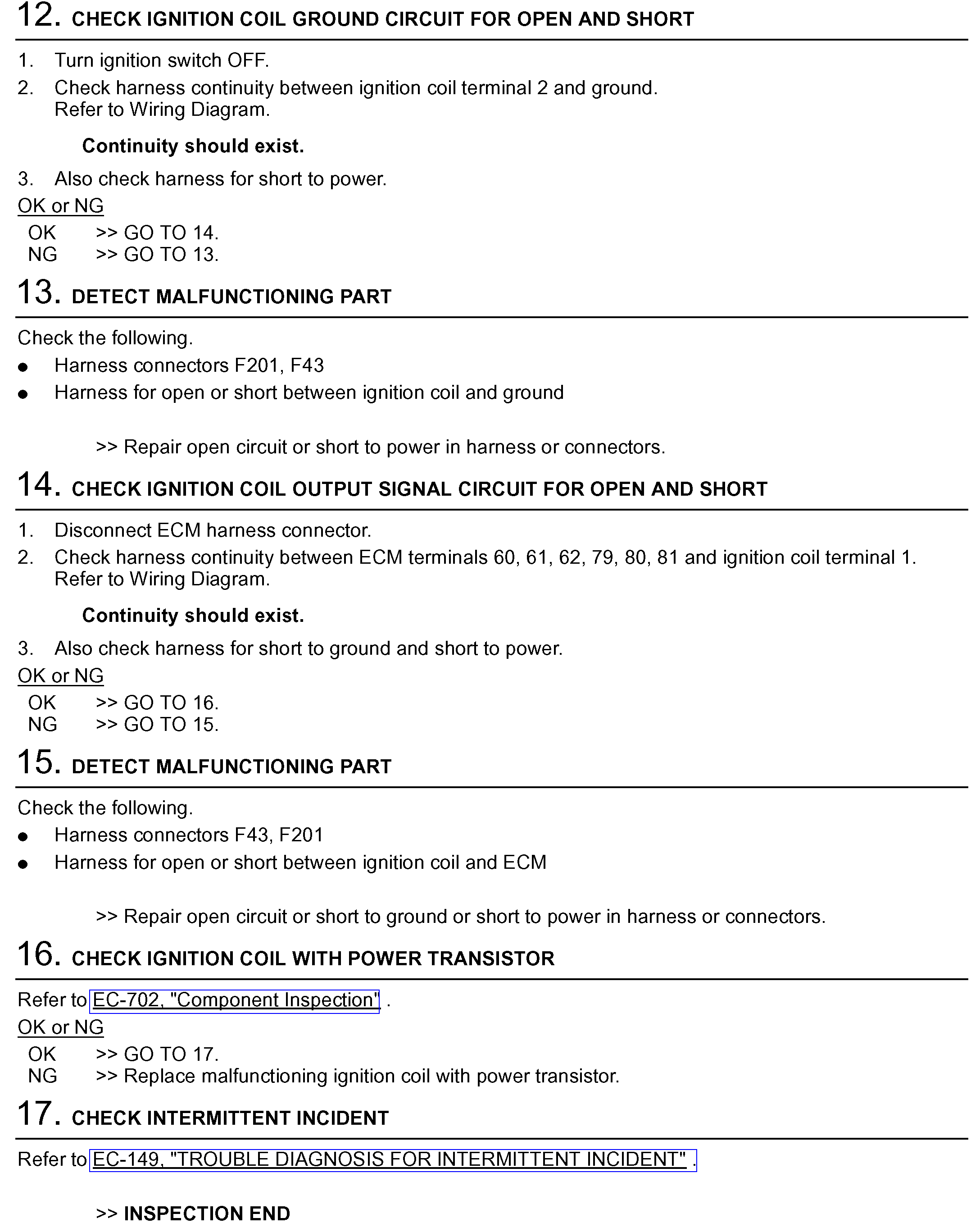

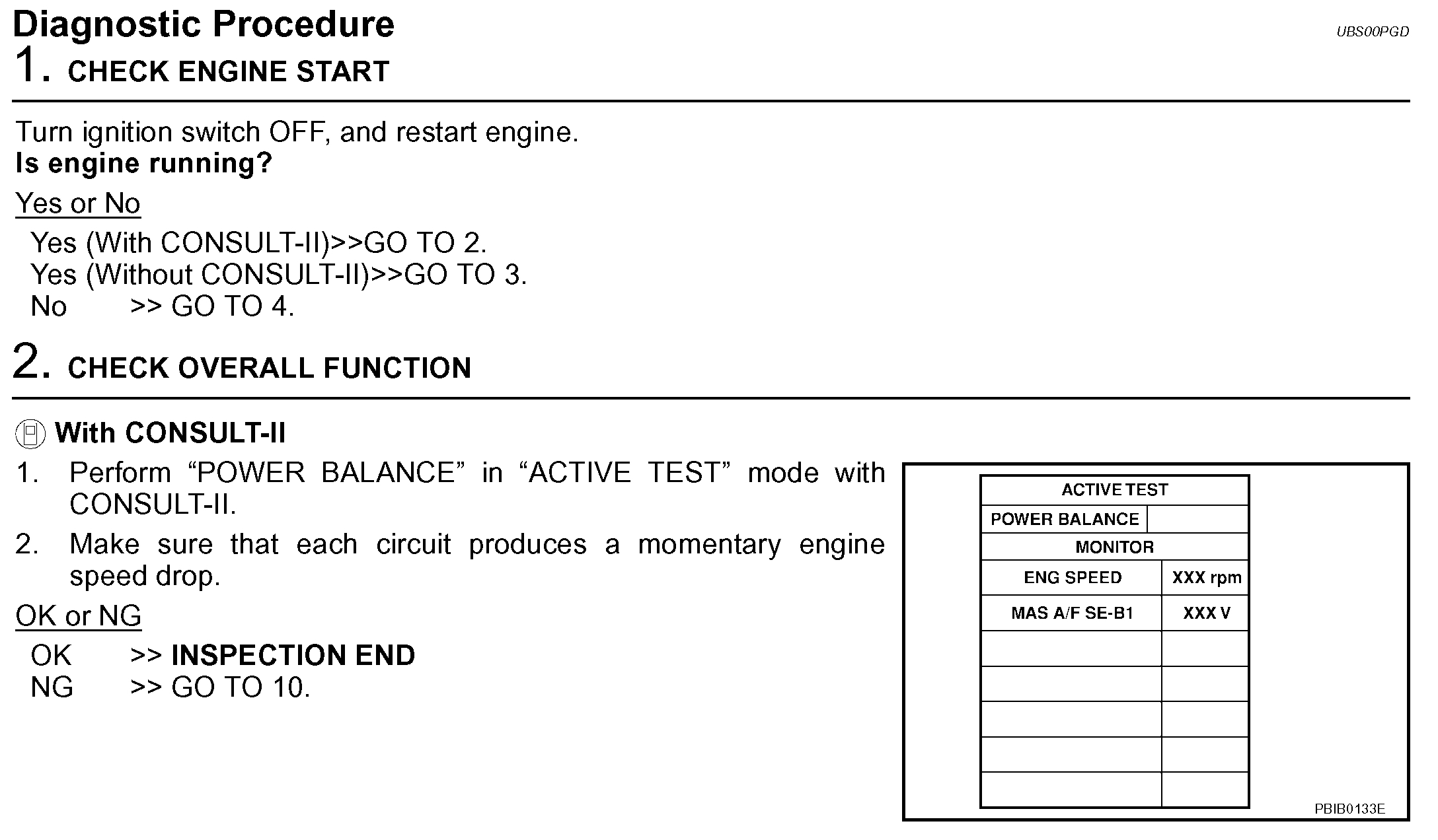

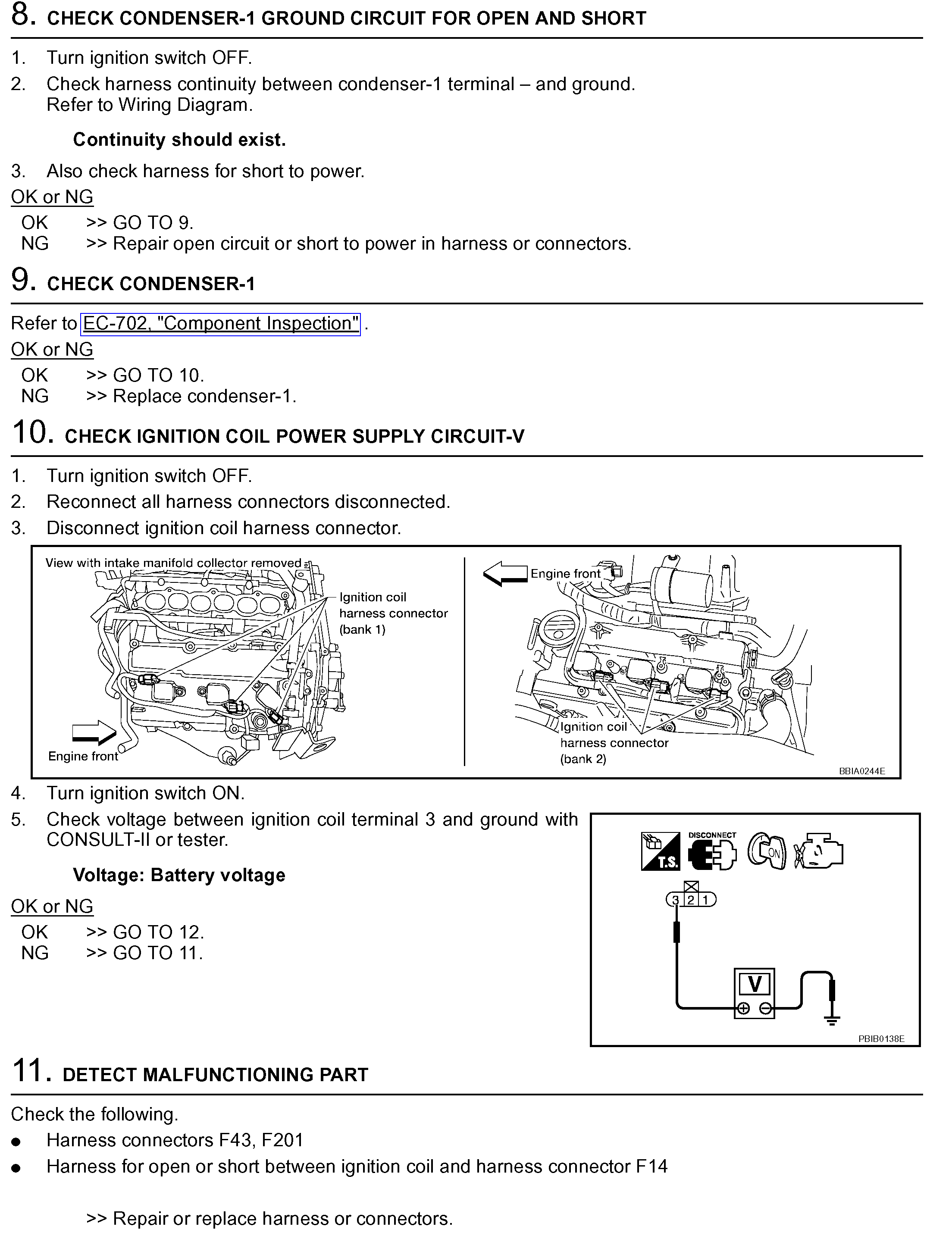

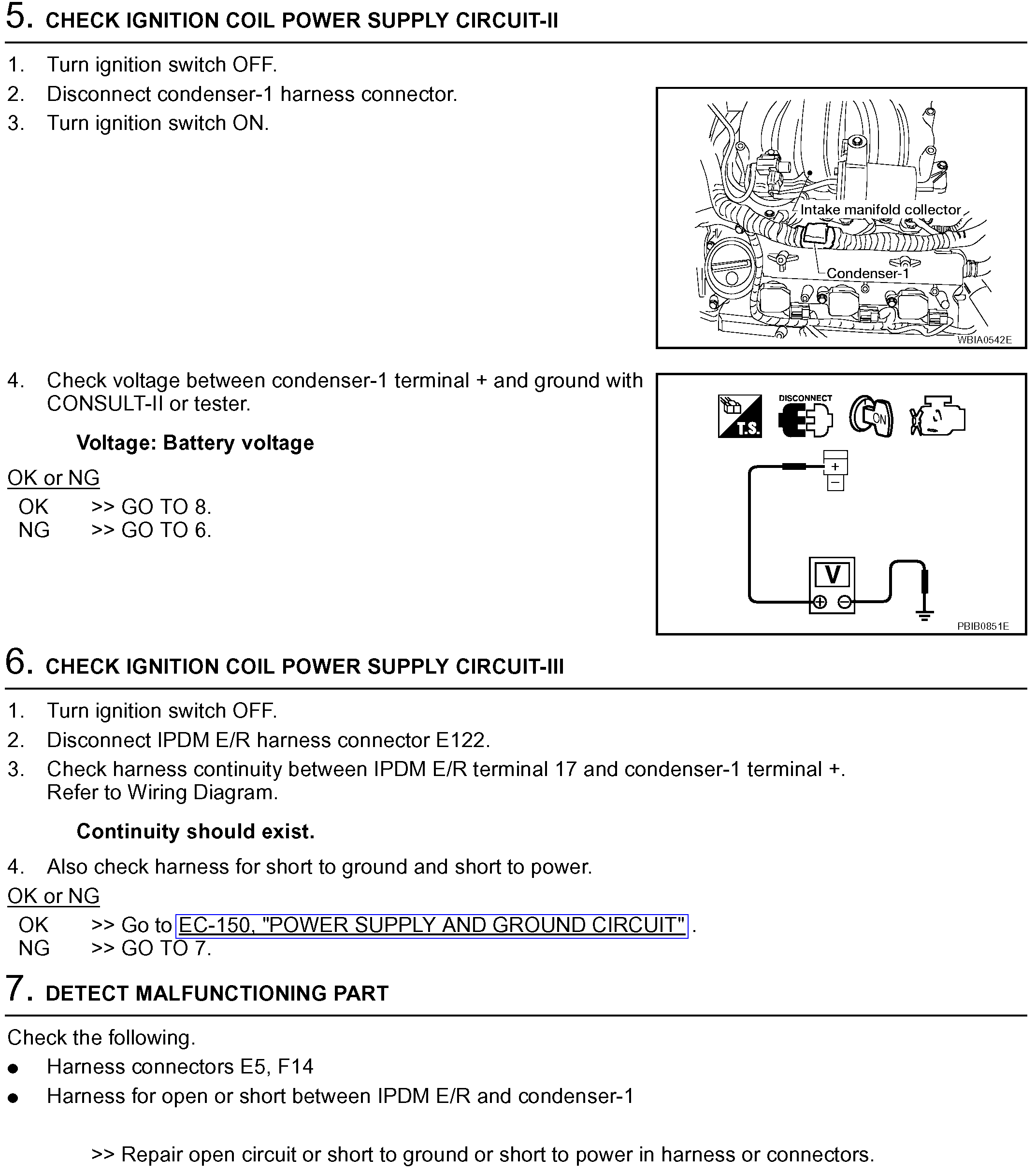

Tested the pulse from CPU and it wasn't pulsing. Power but no pulse.
Nov 21, 2020 at 6:14 PM
Interesting it is only affecting one bank. I attached the diagnostics below. Take a look through them and let me know how much you have already done and if it is at all helpful.
________________________________
2007 Nissan-Datsun Truck Quest V6-3.5L (VQ35DE)
Diagnostic Procedure
Vehicle Powertrain Management Ignition System Testing and Inspection Component Tests and General Diagnostics Diagnostic Procedure
DIAGNOSTIC PROCEDURE
Step 1-2
Pic 1
Step 3-4
pic 2
Step 5-7
Pic 3
Step 8-11
pic 4
Step 12-17
pic 5
