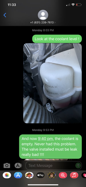

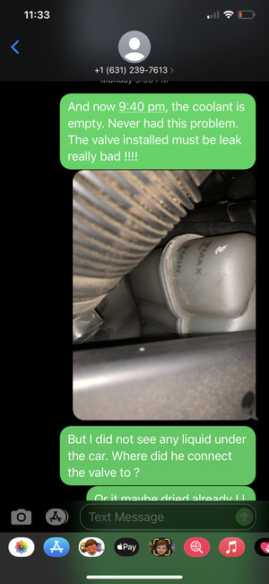

home, I check and found only half of the coolant left in the tank. 1 hour later,
the coolant tank is empty. There's no visible leak anywhere (must be internal
coolant leak). Next morning, the dealer towed my car back, check everything

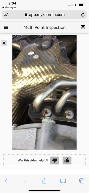

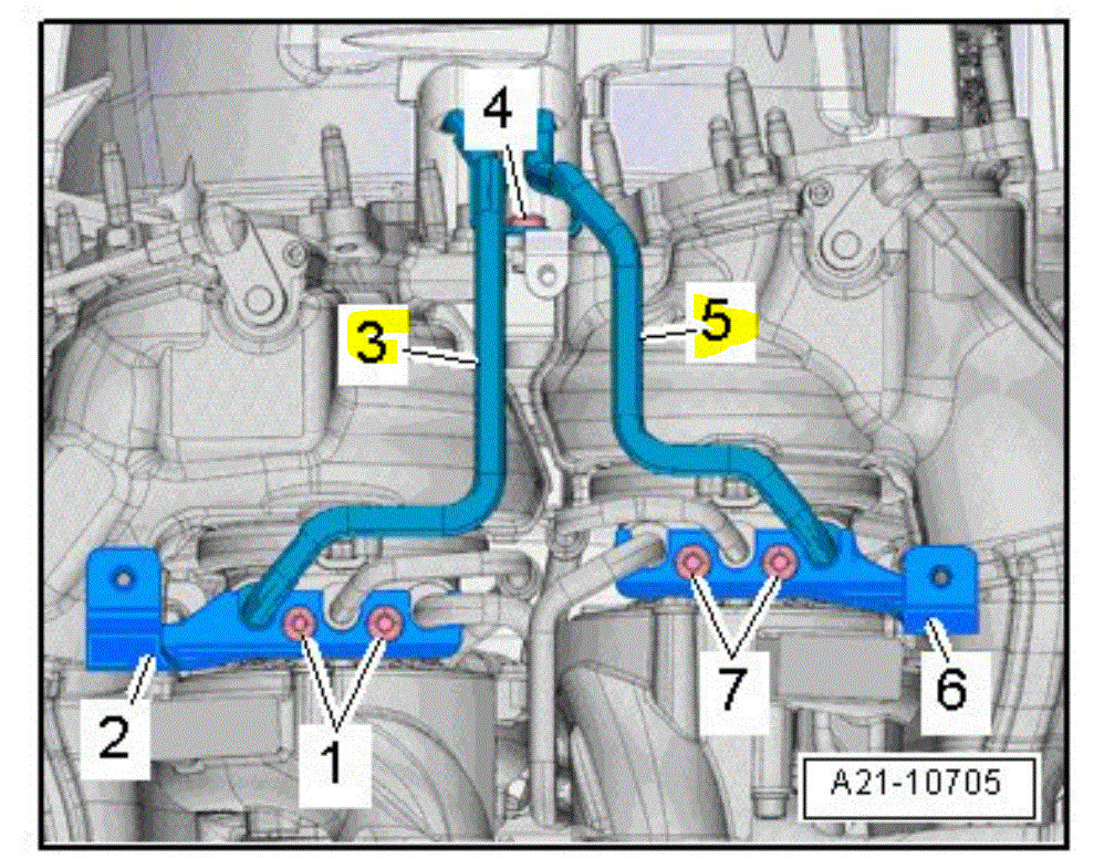

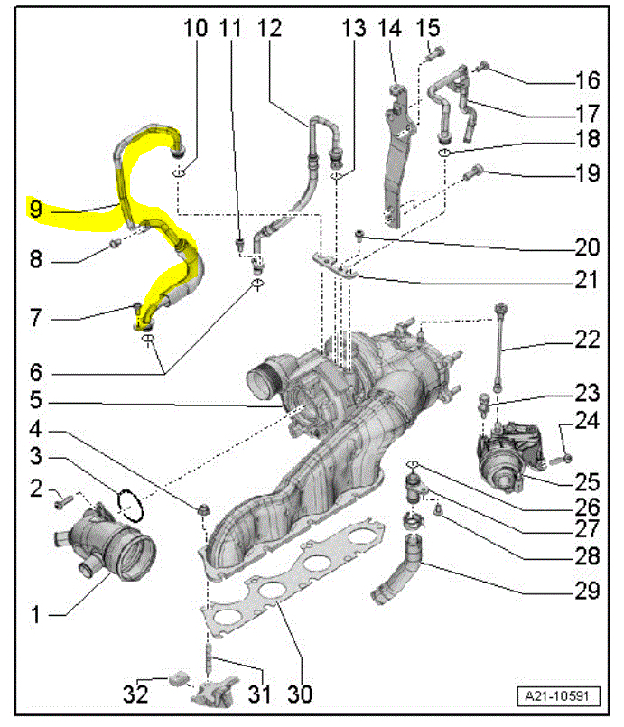

I believe the valve they replaced was the heater control valve. Basically, it diverts coolant to the vehicle's heater core allowing heat to enter the cabin.
That problem really has nothing to do with the turbo. However, what I feel may have caused the problem was a lack of coolant. If there was an air blockage preventing coolant from reaching the turbo, it may have caused damage.
If you look at pic 1, I highlighted a coolant line to one of the turbos. In pic 2, I highlighted the numbers identifying both coolant supply lines to the turbos.
Please understand that I can't guarantee this is the cause, but if it was low on coolant and not properly bled, it certainly could have caused an issue with overheating the turbos and causing damage.

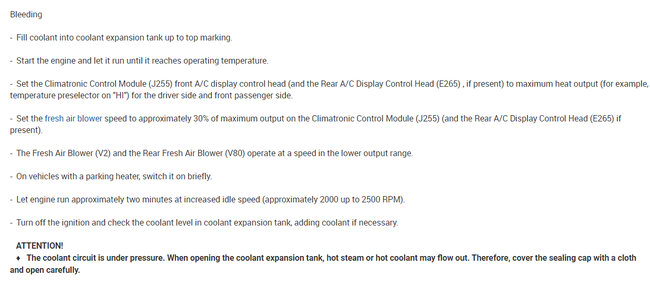

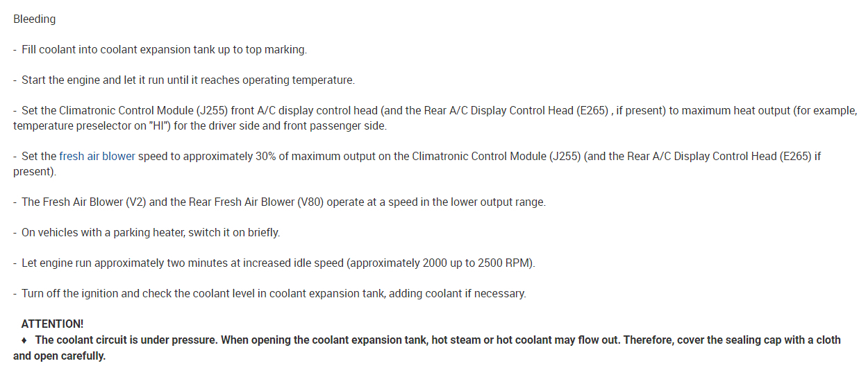

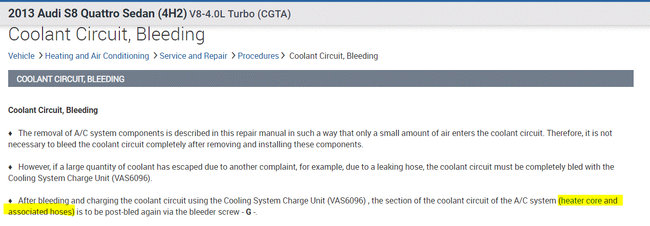

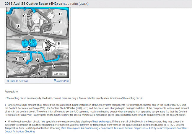

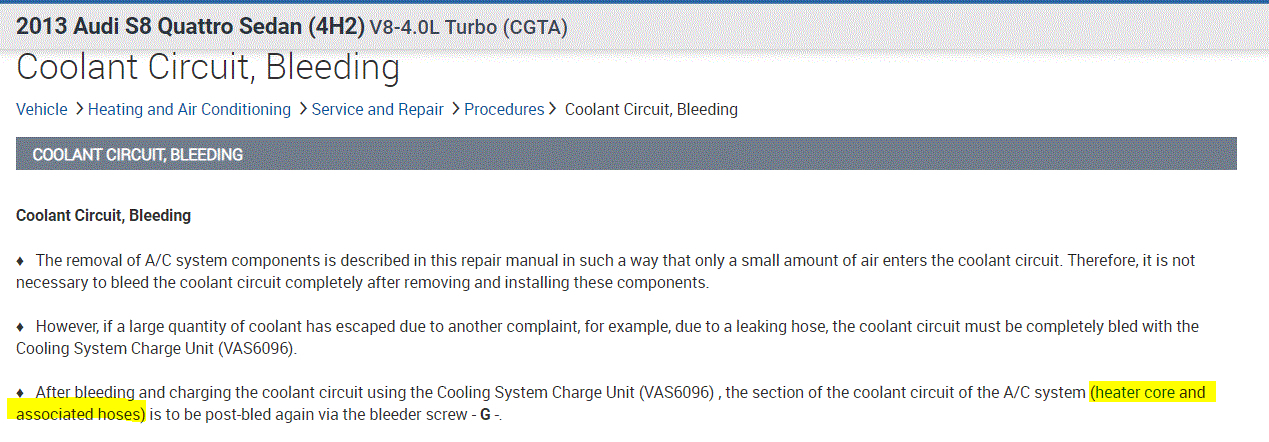

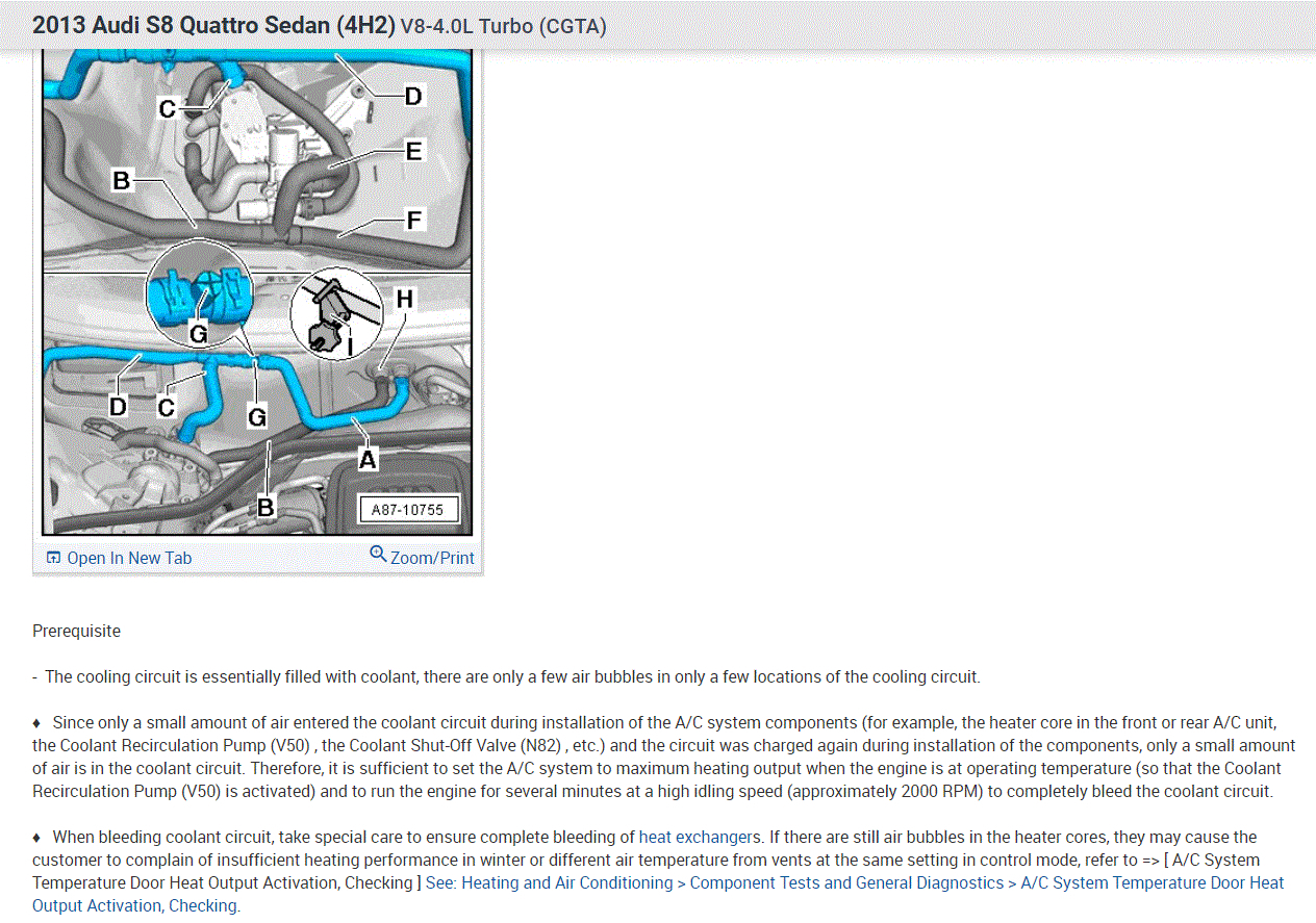

There is a procedure that needs to be completed if large amounts of coolant are lost. Take a look through the attachments below. They explain what needs to be done.
If there wasn't a coolant supply to the coolant-cooled turbo bearings, they would have been damaged.
When you open a cooling system, air enters it. When refilling the system, air can sometimes get trapped. That air can slow or prevent coolant flow. Oftentimes, it affects the heater. In this case, I feel it starved the turbos.
That is my theory at this point. Take a look through the procedure below and see if that was done.
