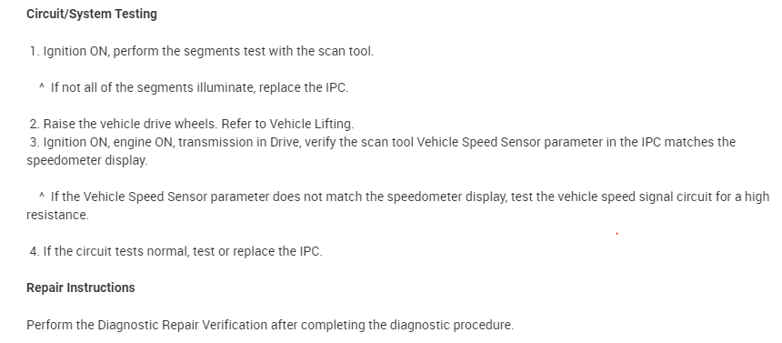

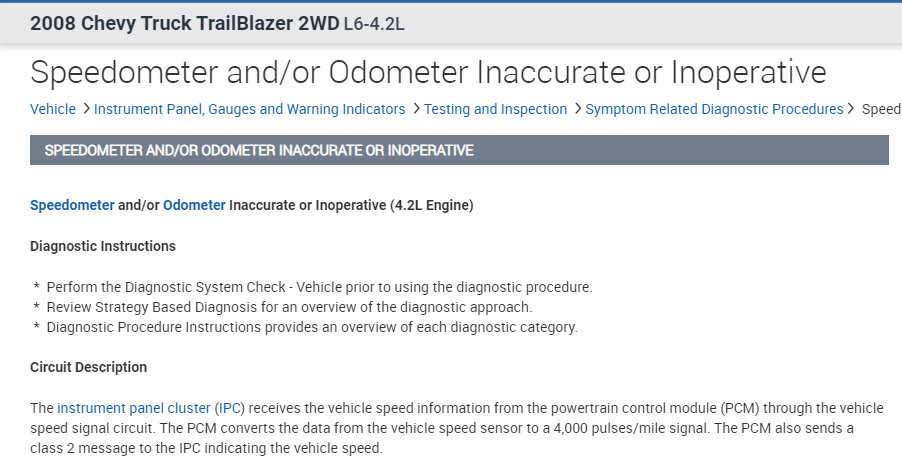

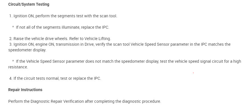

If you replaced the speed sensor, then either we have a wiring issue or the cluster itself is faulty.
If you look below, I attached the diagnostics related to a non-functional speedometer. Take a look through them and let me know if you are comfortable performing them.
Take care and let me know.
See pics below.
