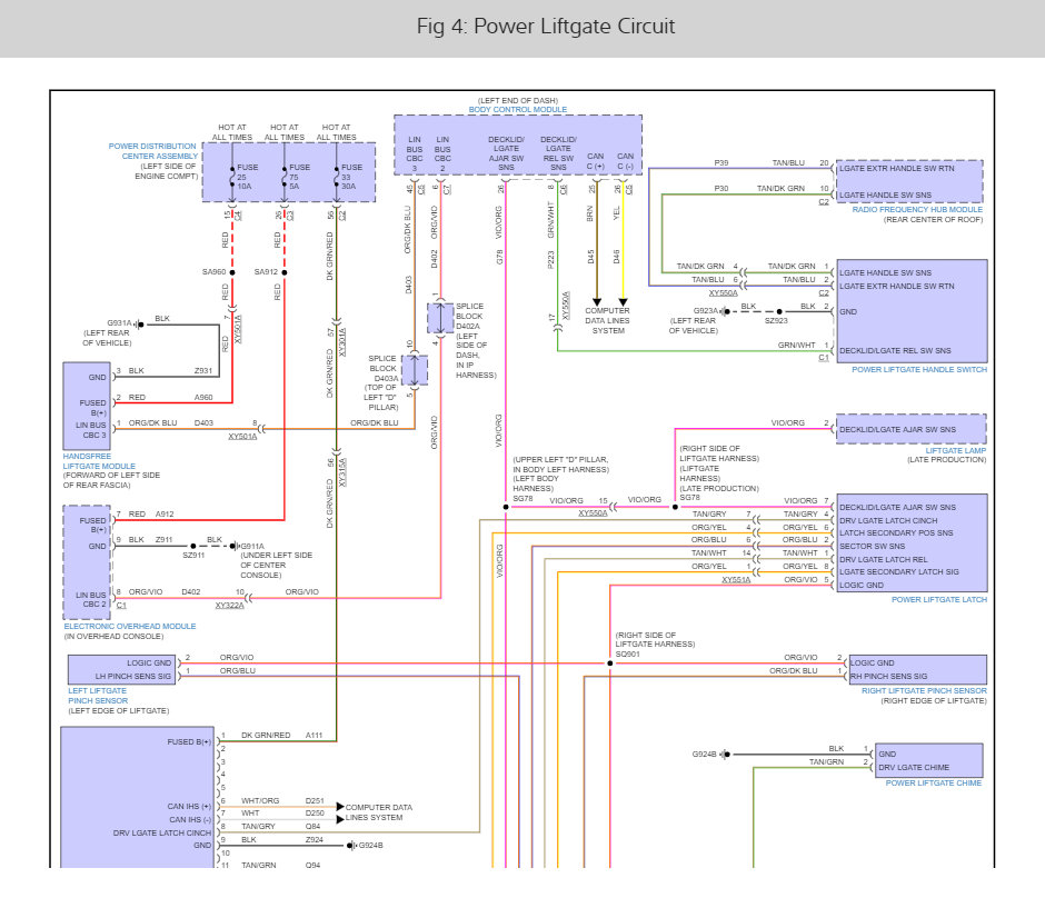

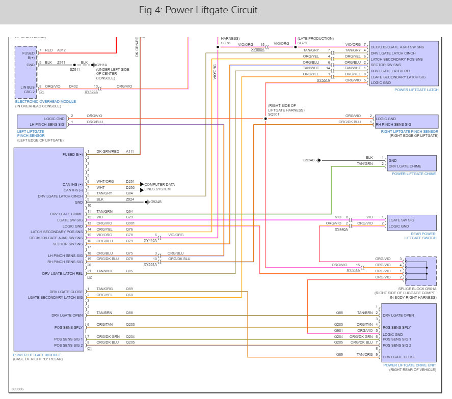

Do you have electrical schematics of this year model?
May 17, 2021 at 7:05 AM

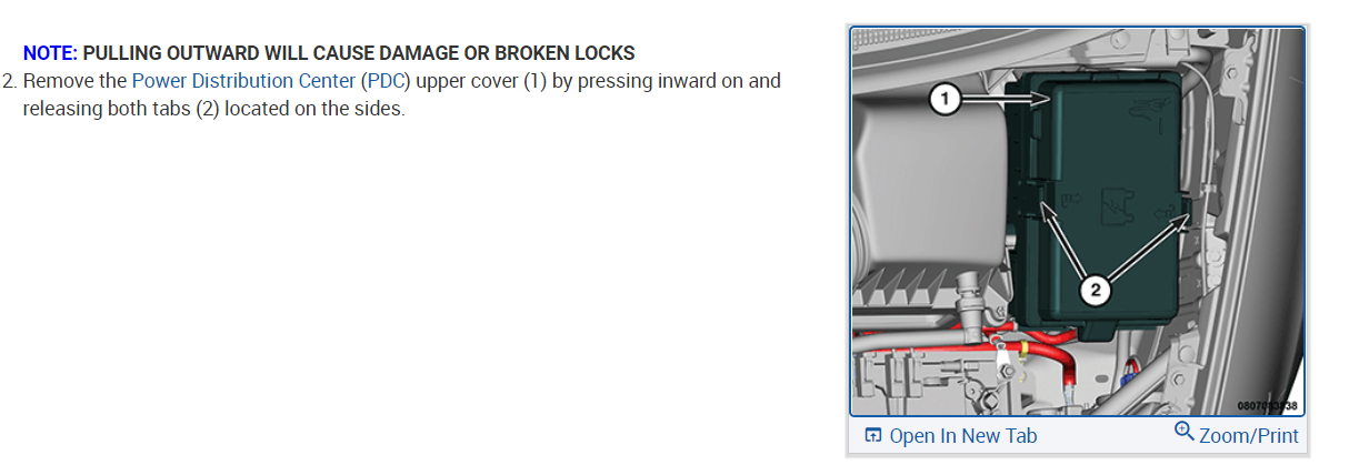

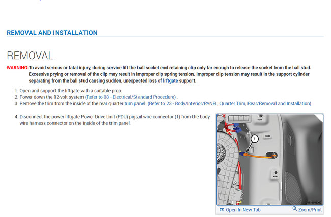

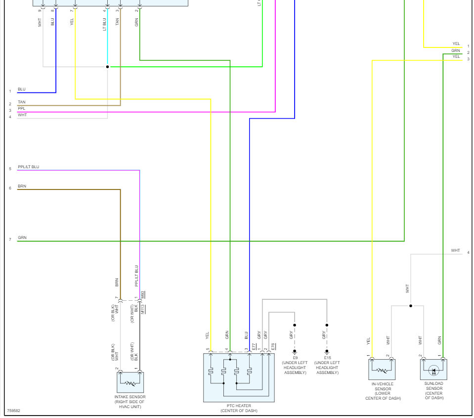

I would check fuses # 25, #75 and #33 in the under hood fuse panel. here is the wiring diagrams so you can see how the system works with a guide on how to check the uses with the fuse location in the diagrams below as well:

Thanks very much Ken those diagrams are exactly what I was wanting.I also did not think to use my Blue Driver scan tool. I guess it would work on this issue as well as engine problems. I am at work now so can't try anything but will let you know what I find. The fuses should be good because it goes right back to working after closing it manually. It never seems to fail with me when I want it to quit working but happens with my wife frequently.

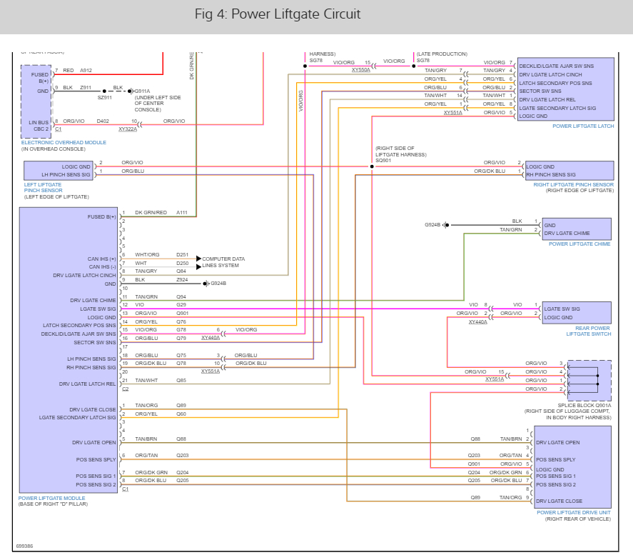

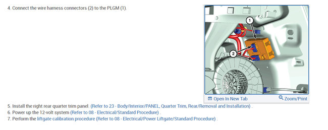

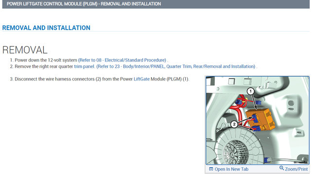

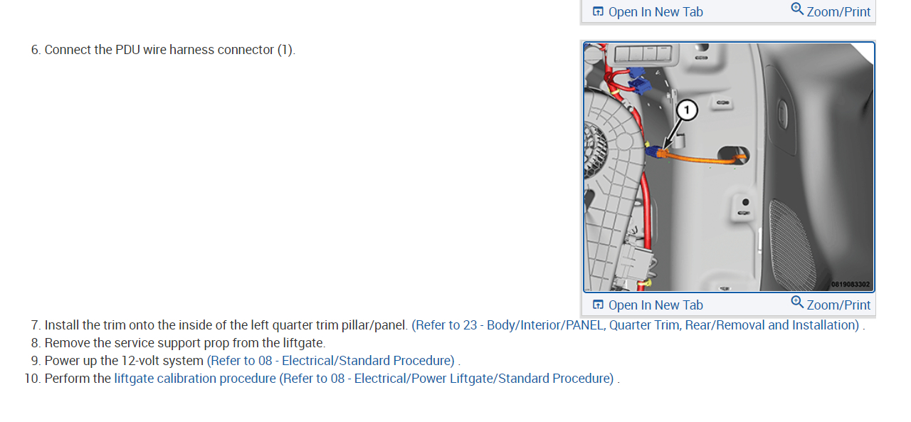

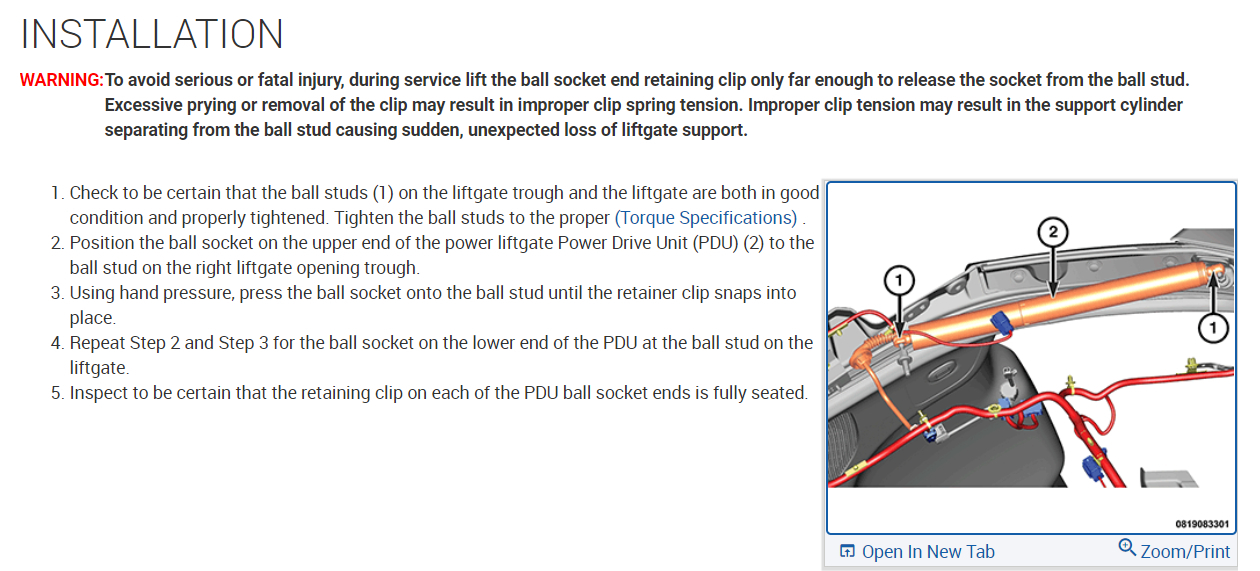

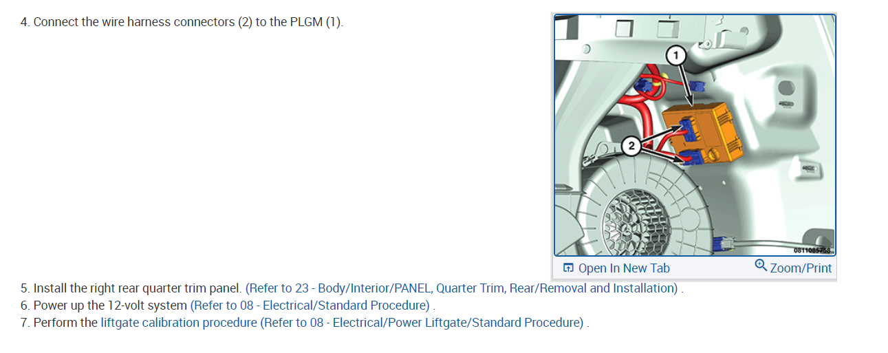

If the liftgate of your 2021 Chrysler Pacifica Hybrid is not closing after a timeout period, there are a few troubleshooting steps you can try:
Manual override:
Check for obstructions:
Power cycle the vehicle:

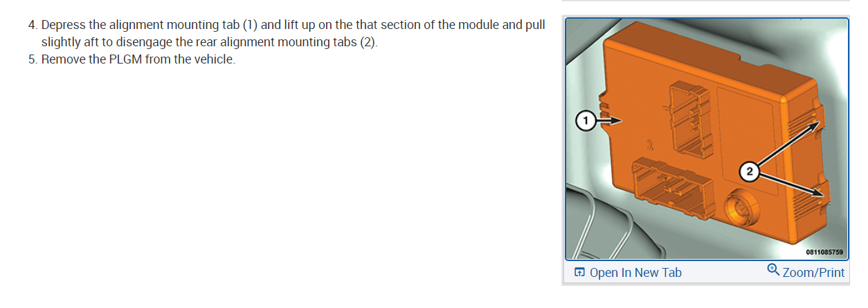

Here are the instructions in the diagrams below. I have included the control module as well.
May 30, 2021 at 11:30 AM

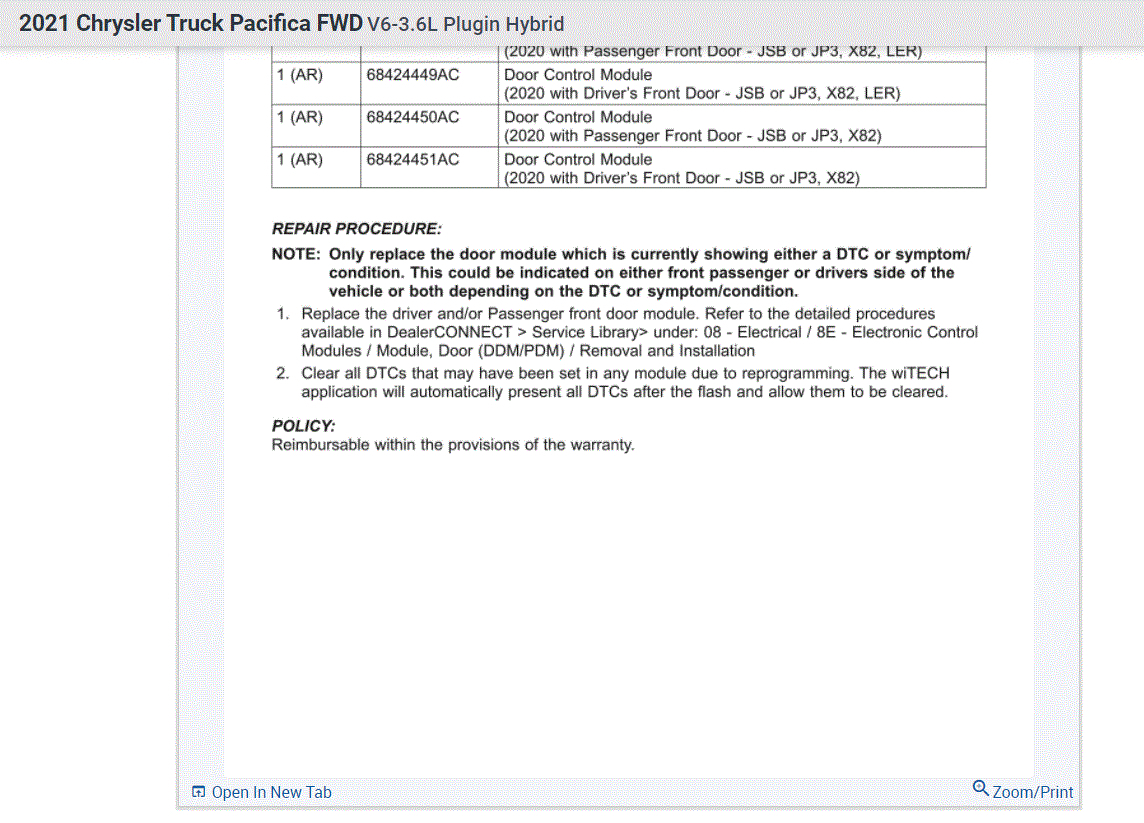

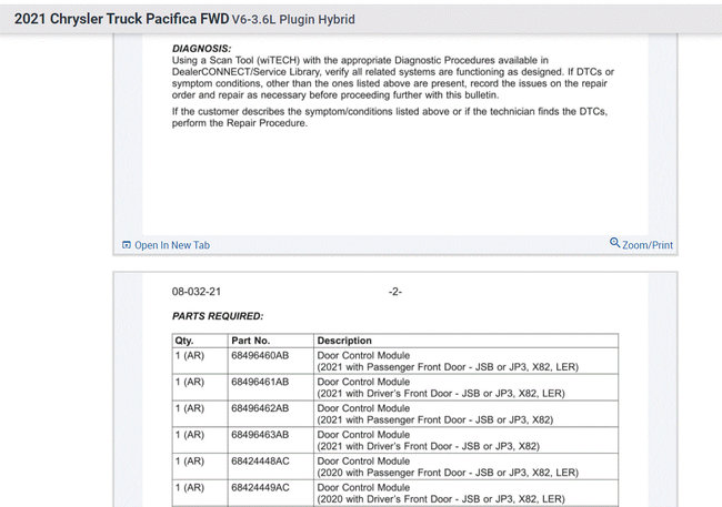

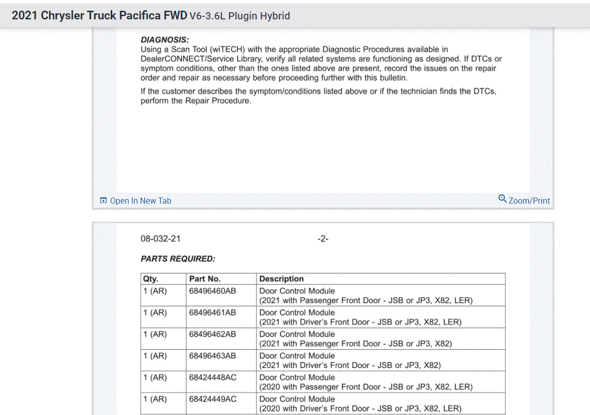

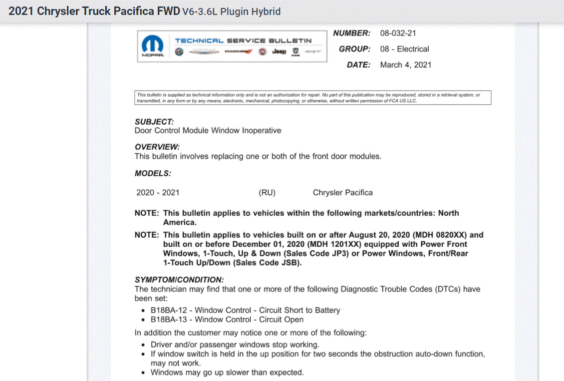

I'm not finding that TSB. It may have been from an earlier model year. The B1186 doesn't come up either, but the B1886 is. There is a TSB related to that code. I attached it below.
Let me know if that helps.
See pics below.
Jun 15, 2021 at 10:31 PM

Thanks for the info. I looked through the codes. They are related to the pinch sensor. The common thread is they all seem to involve a short to either ground or battery voltage.
It may have been when he repaired. Let me know if things change or if I can do anything to help.
