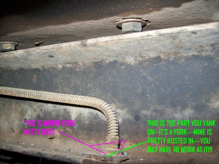

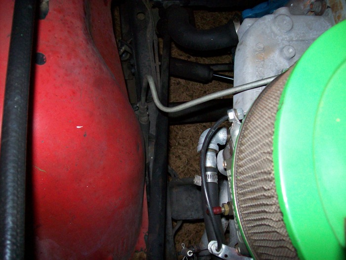

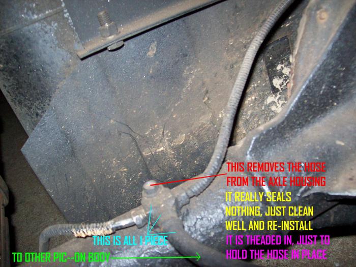

A MIRROR MAY HELP YOU SEE THIS----MINE HAS BEEN ON THERE FOR A WHILE!

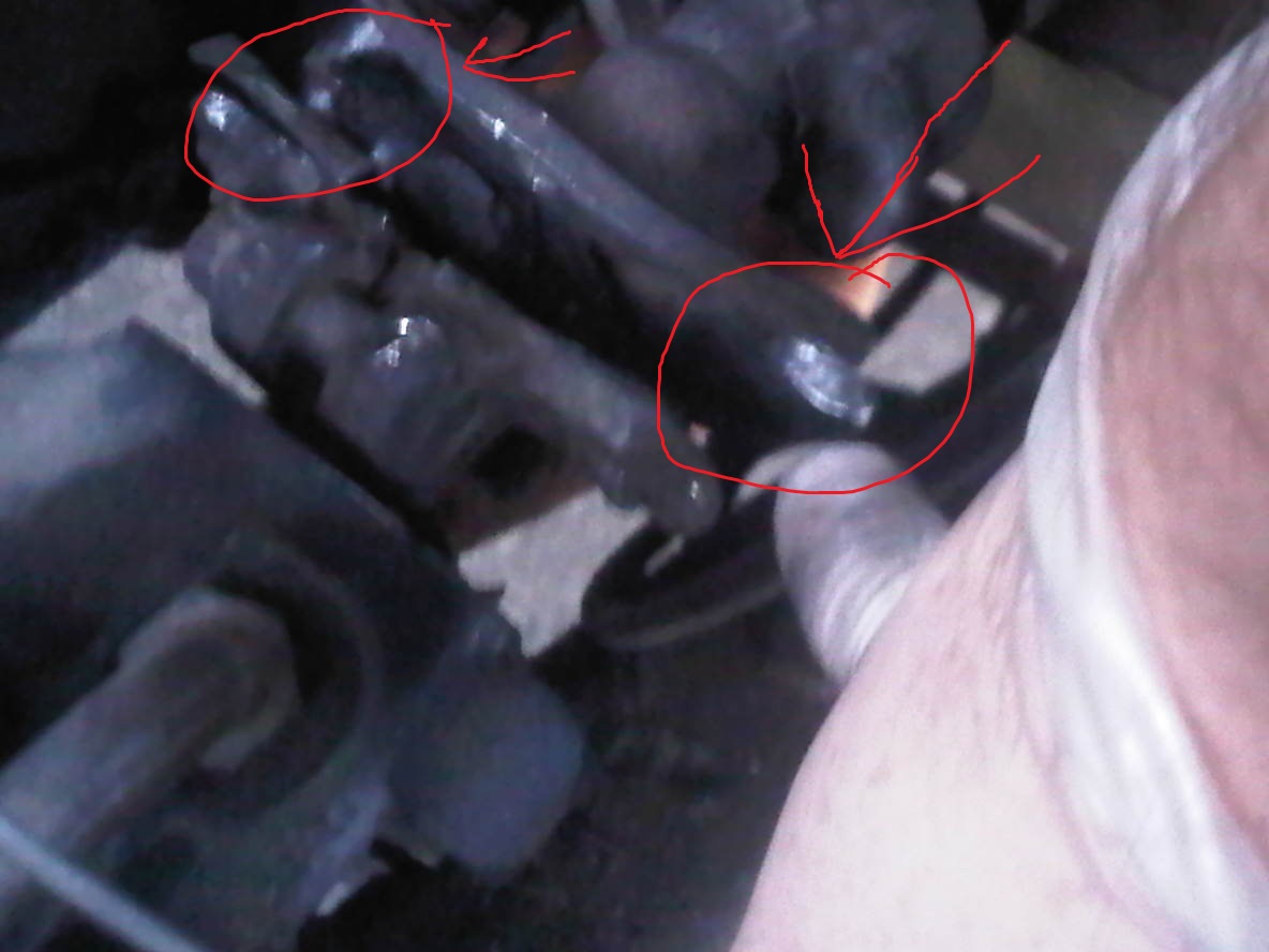

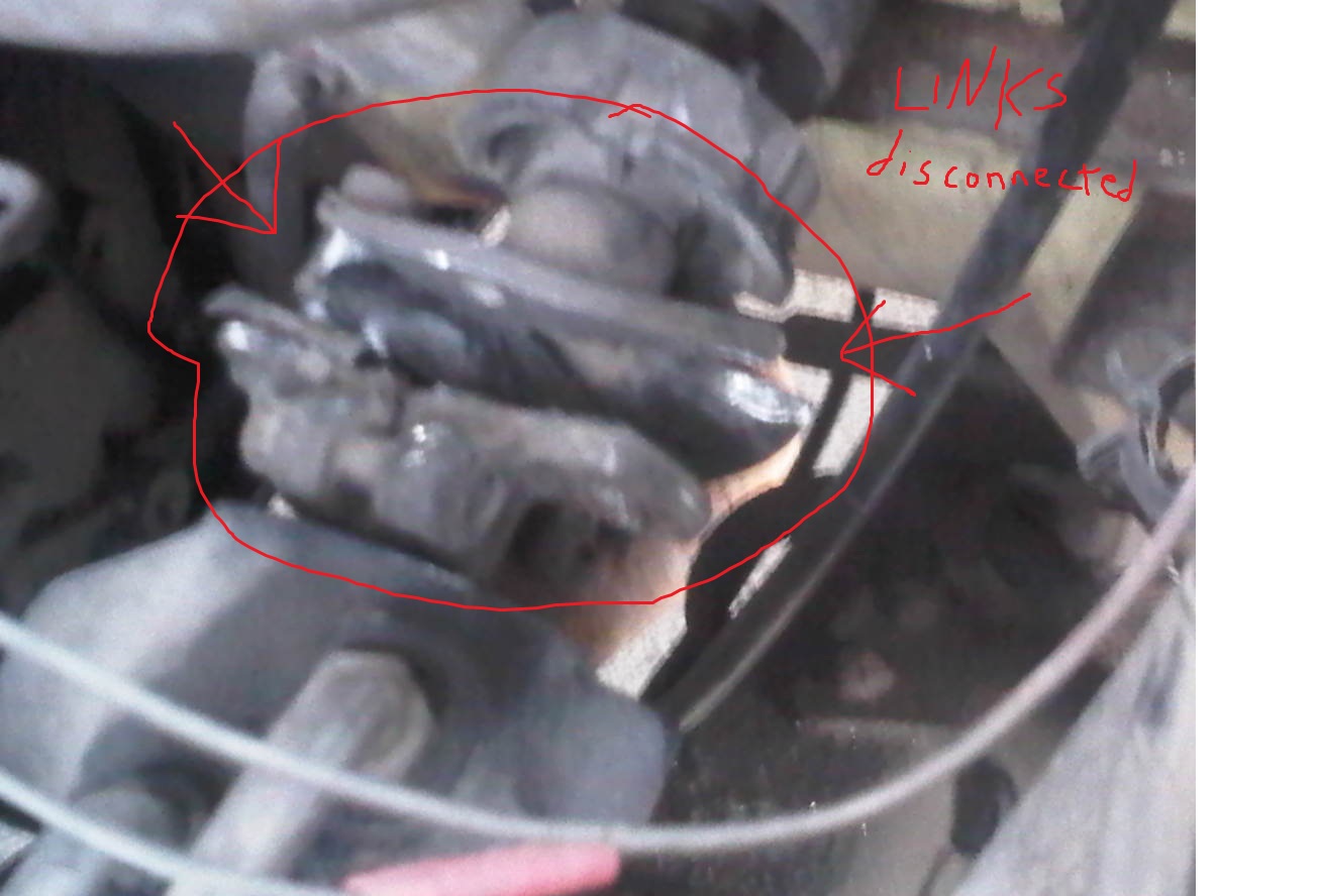

I JUST CAME BACK AND RE-READ THIS--I'M SORTA CONFUSED TO!
I THOUGHT WHEN YOU SAID "CHASSIS", YOU MEANT "BODY"
SO IF YOU MEANT "AXLE TUBE" OR "AXLE HOUSING"---I TOOK A PIC OF THAT TOO!......MINE IS A '77, DIFFERENT MANUFACTURERS, MAY DESIGN THE "BRASS PART" DIFFERENTLY.
THIS IS ON THE PASSENGER SIDE OF MINE----THE FUEL TANK LOOKS BIG (LOW), 'CAUSE IT'S A AFTER-MARKET 21 GALLON.
