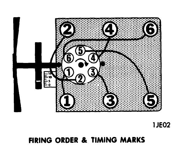

are you sure the firing order is correct? it may not be. and was it built with correct cam you shold find that out for sure. see pic for correct firing and try that then check for a carbon tracking or cracks in dist cap.
