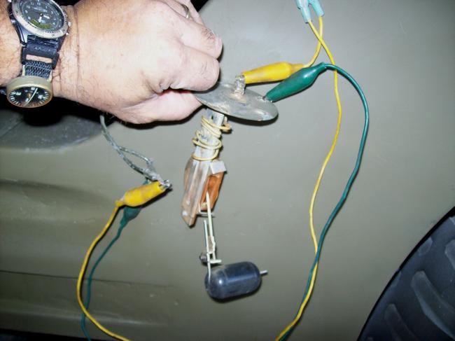

Hmac300, GOOD ADVISE ON THE SENDING UNIT---GROUNDING THE "SENDER WIRE"
----I BELIEVE THAT WOULD BE THE "PINK ONE" ATTACHED TO THE TOP OF THE SENDER, ON ALOT OF THE AMC VEHICLES, A "CONNECTOR" IS ON THE WIRE NEAR THE TANK, IT IS EZ TO ACCESS....THIS KEEPS YOU FROM CRAMMING YOU HAND ON TO OF THE TANK......SIMPLY DISCONNECT IT, THEN "TEMPORARILY" GROUND THE END HEADED BACK TOWARDS THE GAUGES..........WHAT ARE THE RESULTS WITH THE GAUGE?

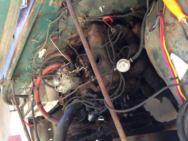

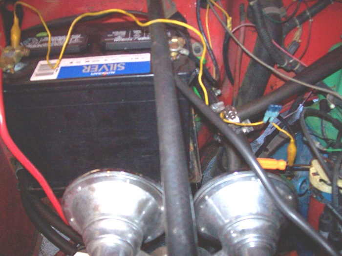

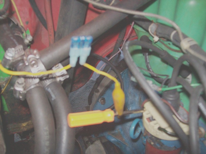

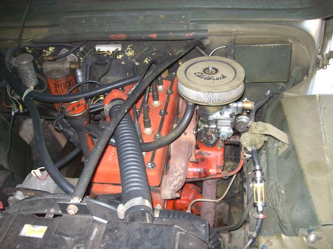

......IN MY JEEP PIC---THE GAUGE TEST WOULD MEAN I'D TAKE THE YELLOW ALLIGATOR CLIP OFF OF THE SENDER AND GROUND IT TO A GOOD GROUND (IN MY PIC, IT'S OUT OF THE TANK...PRETEND IT'S STILL IN THERE!).......'MEMBER, THE KEY HAS TO BE "ON" !!!
