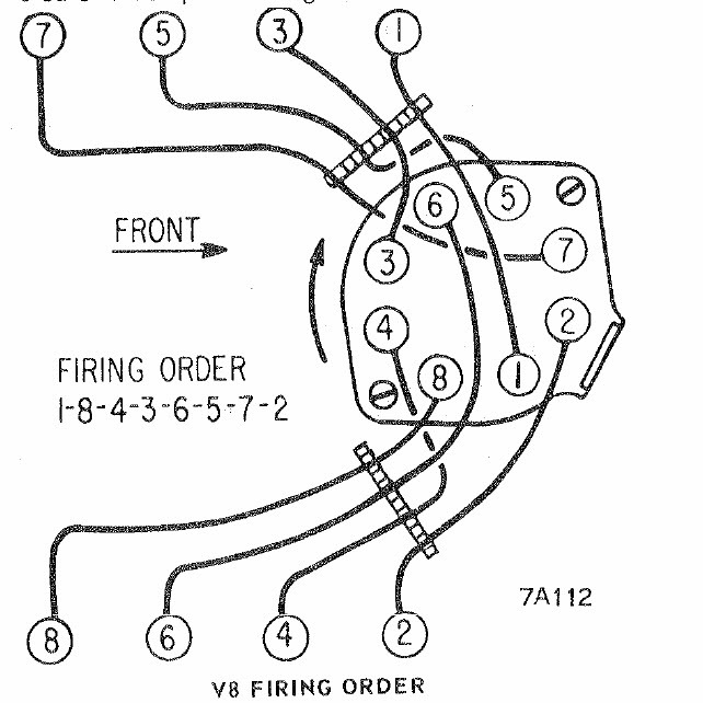

with these older cars it should have 12 volts cranking and 9 volts once it starts. points shold be set at about .016-.017 or 30 degrees dwell to run best. if it sounds funny when you turn it over check for a bad timing chain as these were prone to it. if it has lasted as long as it has with no timing chain it is an amazing feet normally at about 50k these went out. they were plastic cam gears. check to see if rotor points to #1 then check compression on a few cylinders if they are all like 75 or same compression like less than 90 probably the chain is bad. Also check to see I you are getting spark from coil if you are then check rotor inside distributor cap as that probably is the culprit. it should still start with 6 volts however. see pic for firing order etc.

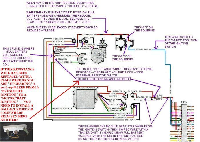

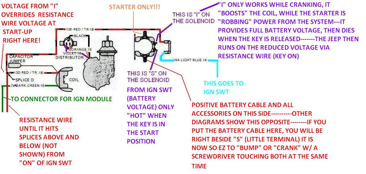

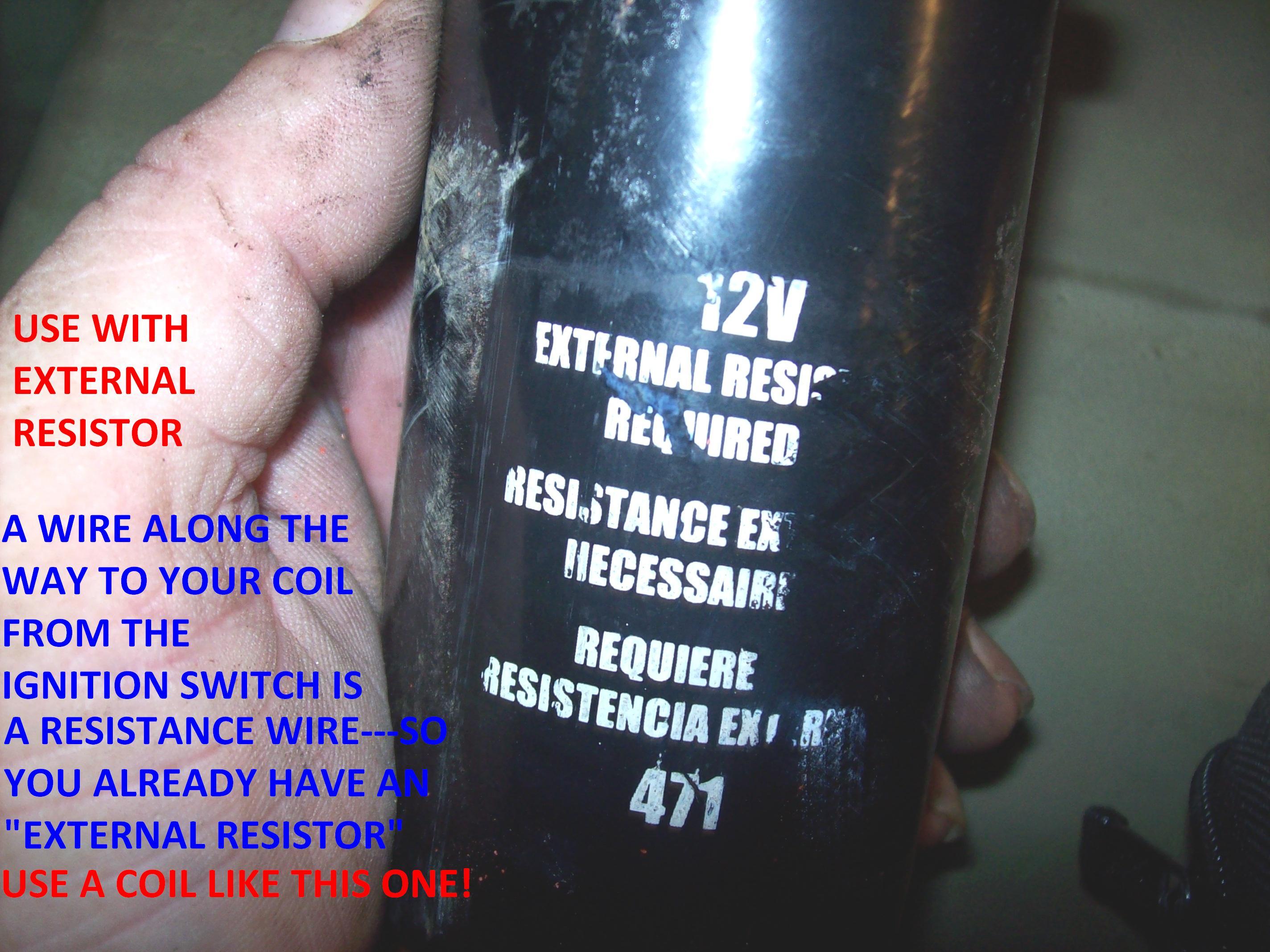

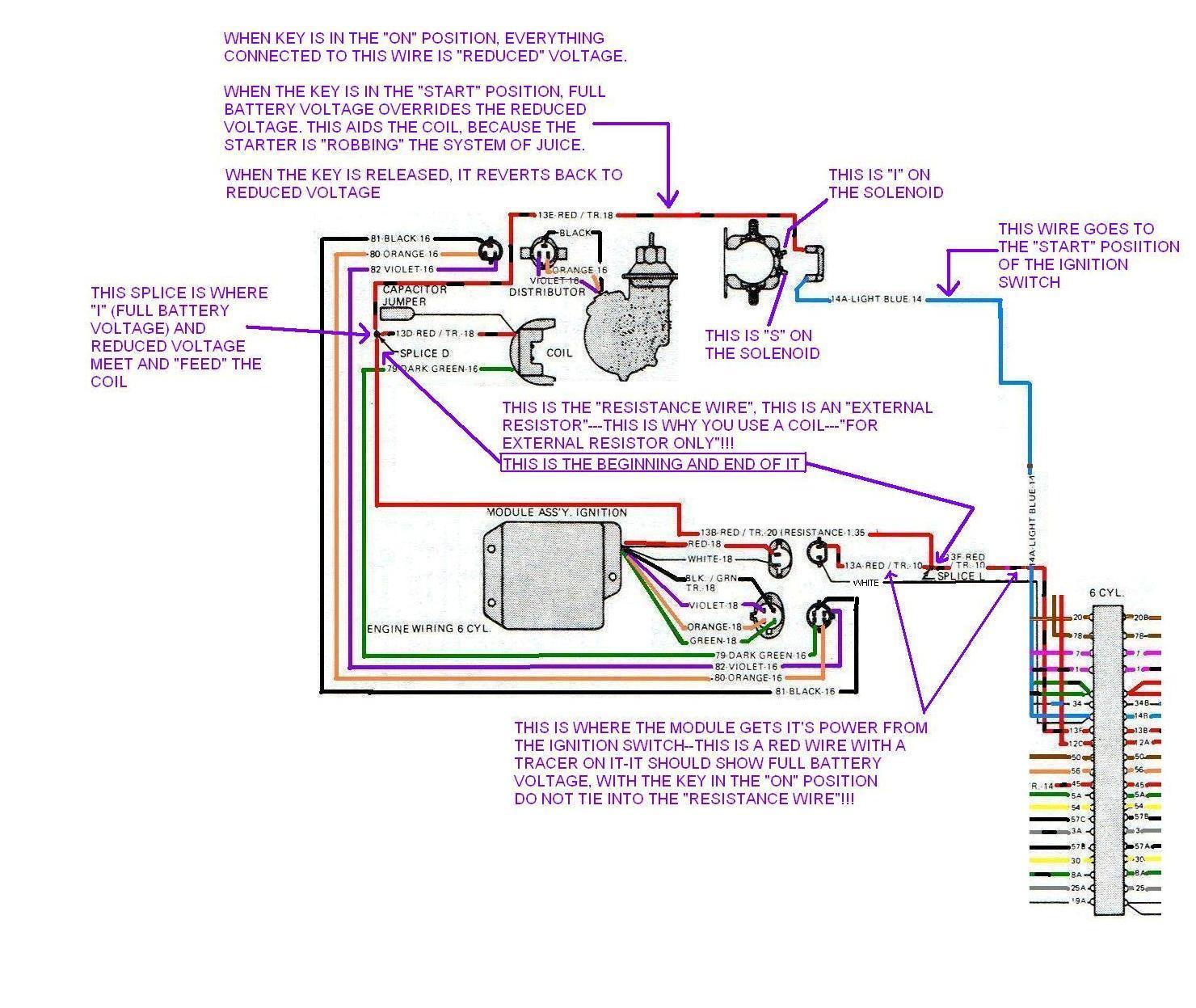

THE PERTRONICS SYSTEM USES FULL BATTERY VOLTAGE TO THE COIL, NO REDUCTION NEEDED
THE POINT'S SYSTEM NEEDS RESISTANCE ON THE COIL WIRE (A BALLAST RESISTOR IS WHAT WE USED ON OURS)
WE LEFT THE BALLAST RESISTORS MOUNTED IN PLACE (IN CASE WE NEEDED THE POINTS AGAIN) AND SIMPLY PIGGYBACKED THE WIRES ONTO ONE SIDE OF IT, SO IT WOULD HAVE FULL 12 VOLTS TO THE PERTRONICS

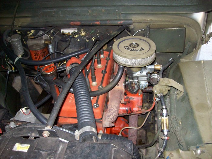

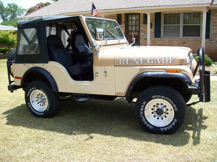

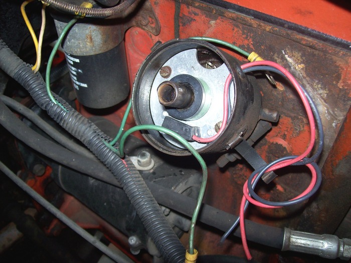

HERE'S A LINK SHOWING MY JEEP WITH A PERTRONICS W/ BLASTER COIL
