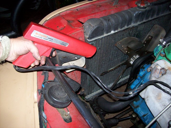

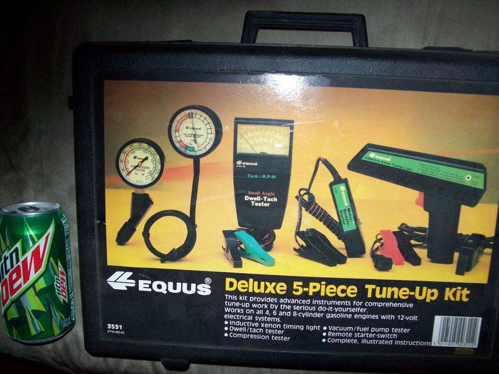

This is an inexpensive set, pretty much all of the Normal Stuff you will need to test/ adjust/ and tune an older vehicle (even on some of the newer cars too)
The cool thing is, it's all in one Compact Case, and less than $40 at "Harbor Freight".....A voltmeter is another item you should have, same place, $7 and under!
If you are gonna continue to work on this vehicle, each of the Items will make things EZer for you--decent instructions within!
We can help you figure things out too, Just continue to ask, here at this question!
