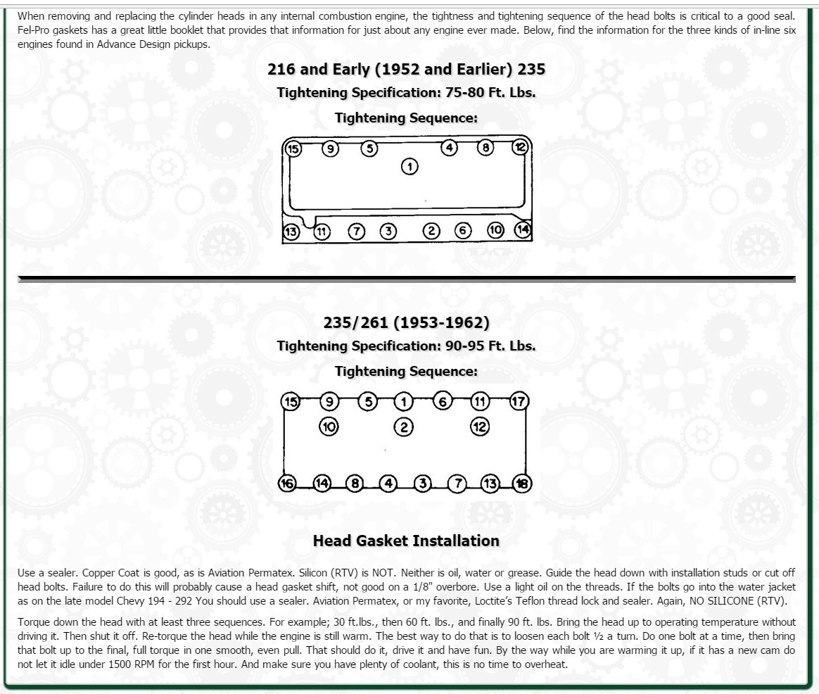

I am rebuilding my 1953 Bel Air 235 inline six cylinder. I need the torque specs for the bolts if you guys know any website will be much appreciated.

Hey SPIDERSOLIS,
Here is the information you need for your car, what a fun project! please post pictures of the job if you can.
Best, Ken
