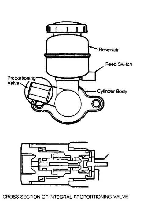

if the pedal goes down fairly easily with the engine running then the booster should be working. One thing is that this should have a proportioning valve on the system.if there isn't that will be part of your problem. Also the larger of the mastre resevoir should go to the disc brake side. there also should be a little valve in the line going to the drum side of the brakes. That is very important as drum brakes require constant pressure whereas disc brakes don't. If there is no proportioning valve there are adjustable ones sold that can be installed . you might try power bleeding this system to see if that fixes it. if not it may be a bad master cylinder or one of the other things i've mentioned. It sounds as this has been hacked fairly well. it might not have the correctmaster for this system either as the ford may have had disc brakes all the way around whereas you don't on yoursystem and you will run into the previous problem mentioned. if your master looks similar to the pic shown you have the pp valve already and that line should go to the rear.

thank you for your quick response. and yes i forgot to mention that there is an adjustable proportioning valve inline to the rear. also it looks like the master cyl you showed is the same one that was used. which i wondered what that fitting was on it. so if the cylinder has a built in valve then the inline one is not needed if i understand correctly. i will have to go back and look but i think the person who built the truck has that master cyl valve hooked to the frt brakes. so hopefully i have found the problem with your help thank you.
