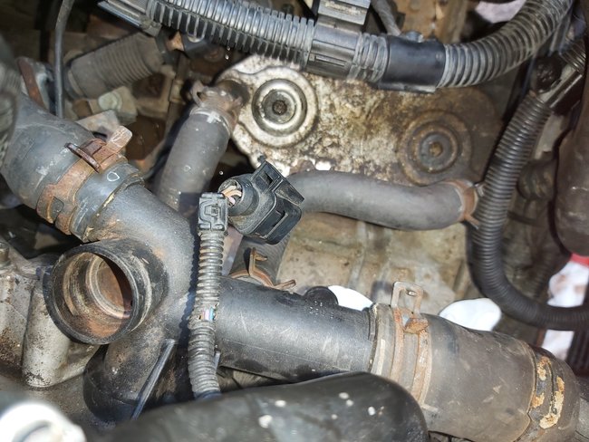

Car listed above has a 1.8t . The fans will not come on during warm up or driving and I have low compression code p0304 lead me to 30psi on pressure text.
The engine shakes like it wants to fall out the car
The coolant is bubbling. Steam shooting out the reservoir.Then when I shut it down the coolant disappeared.
I have to refill. There is a little bit of brown in the coolant it turned the new reservoir ball a slight shade of brown.
Thermostat is fine. Put it in boiling water, it opened.
Radiator is new.
water pump turns on.
Fans work with A/C on.
Oil is frothy.
Mayo on oil cap.
Can only drive around the block. Less than 2 miles since this started.
Replaced fuse box on battery.
Just brought car.
Power is at coil.
I love Beetles.
Help.
