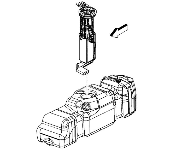

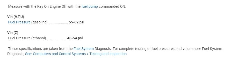

This sounds like a fuel pump issue. Low fuel pressure will cause the rough idle and the lean codes.
https://www.2carpros.com/articles/repair-lean-mixture-codes-p0171-or-p0174-on-some-manufacturers

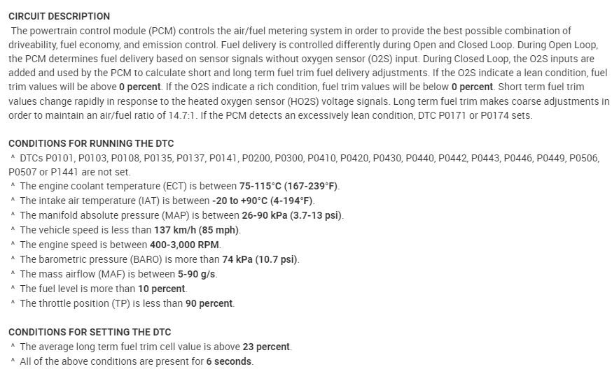

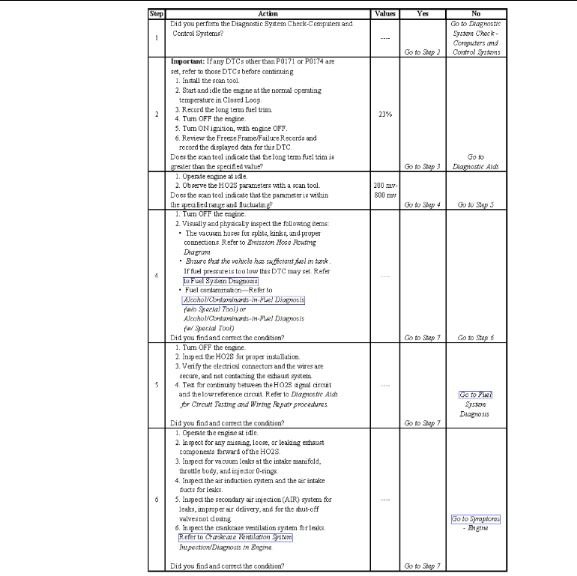

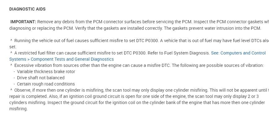

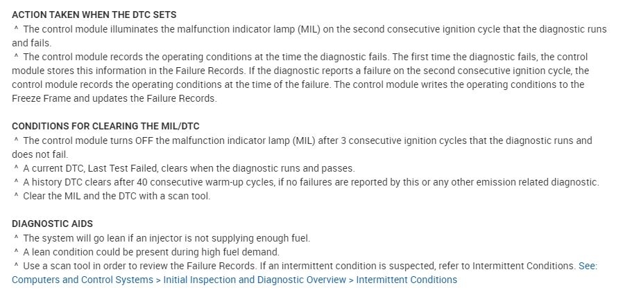

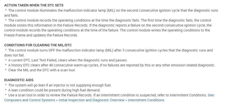

The most common cause is low fuel pressure. I attached the flow chart as well as the pressure spec for you. You can rent a pressure tester at a parts store.

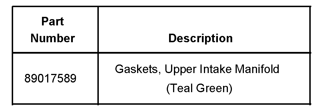

Replace the upper intake manifold gaskets with the teal green gasket material, P/N 89017589.

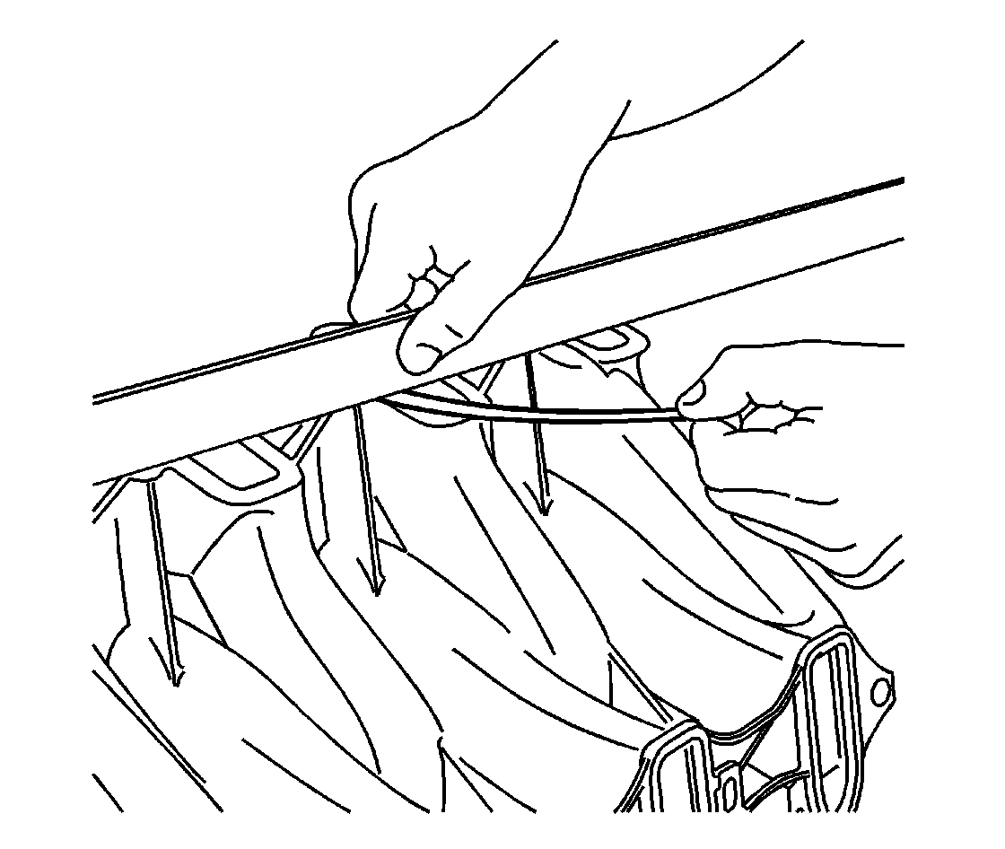

1.  Locate a straight edge across the intake manifold cylinder head deck surface. Position the straight edge across two runner port openings.
2.  Insert a feeler gauge between the intake manifold and the straight edge. An intake manifold with warpage in excess of 3 mm (0.118 in) over a 200 mm (7.87 in) area is warped and should be replaced. Do not replace intake manifolds with warpage that measures less than 3 mm (0.118 in) over a 200 mm (7.87 in).
