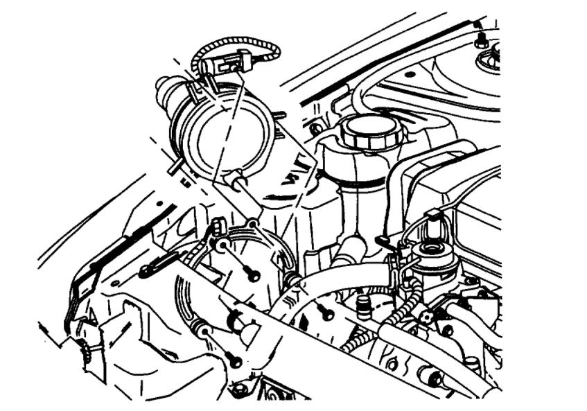

The 410 code is for the air pump not the O2 sensor. description below.
As far as the engine, you may have damaged a ring installing the piston into the cylinder. if that is not the case, then the cylinder itself may be the issue. if it is out of taper or out of round it would explain the oil usage.
did you have the block bored when the overhaul was done??
DTC P0410 determines if the Air Pump System is operating properly. During air pump operation, the PCM monitors the oxygen sensor output. The additional air pumped into the exhaust manifold causes the oxygen sensor to indicate a lean condition in a properly operating system. If the oxygen sensor does not indicate a lean condition for a fixed amount of time, it will fail the DTC P0410 diagnostic test.
DTC PARAMETERS
DTC P0410 will set when:
^ The oxygen sensor does not indicate a lean condition during air pump operation.
^ No MAP, TP EGR, O2S, Misfire or Fuel Trim DTCs are set.
The diagnostic for DTC P0410 will only run when the air pump is on. If the air pump runs only for a short period of time, the P0410 Diagnostic Test may not run.
DIAGNOSTIC AIDS
Use the Scan Tool Air Pump Special Test to verify if a problem exists. The Special Test turns on the air pump for 30 seconds and forces the DTC P0410 Diagnostic Test to run.

Cylinders honed, machine shop pressure checked heads and block, said it was good. Tearing down engine this weekend to change rings. Cannot find a air pump on the car. It is not on the passenger side between engine and radiator where the internet says it is supposed to be. O'Reillys said only California cars came with them, but also say my car only came in a three door version. Lol. the fuse box has a slot for a air pump relay and fuse but no wires on the bottom.

And how do I make my scan tool do a air pump test? I have only used it to read and erase codes .
May 1, 2018 at 11:21 AM
Okay.
You need an advanced scan tool to activate the air pump.
you said they honed but not bored. the taper or out of round may be the issue. need to be checked.

Okay, picture below for the air pump.
No, to the valve seat. it is a cylinder issue as I have stated.

No air pump under my hood. Previous owner probably removed it. Never had a code until the rebuild. I found the wire for the rear O2 sensor zip tied. I appreciate all all of your help. I am almost convinced rock auto sent the wrong rings or sent defective ones. Will not be able to tell until I pull it back apart.
