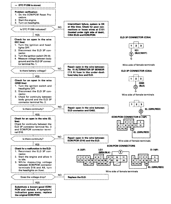

I am trying to get my car to smog. no check engine light is on, but if you hook up scanner the P1298 code comes up. so i replaced it and still doing it, but if i turn the headlights on and scan it there is no codes. i am stumped i have replaced the ELD two times thinking the one i got was bad but same thing.
Oct 27, 2017 at 2:29 AM
HARRY P
  • 2,292 POSTS
P1298 should not keep the car from passing emissions. You also might try leaving the headlights on when you take it in for inspection. And a code does not necessarily just mean to change a part. What it really means is that there is a problem somewhere in that circuit and further diagnosis is needed. According to AllData, since the code goes away when you turn the headlights on, check the connections at a junction box located under the dash, passenger side. I am including a diagnostic flow chart from AllData in an image file. Hopefully this helps you out. Good luck and keep us posted.
