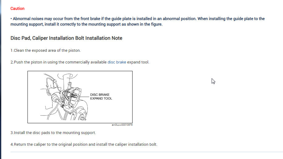

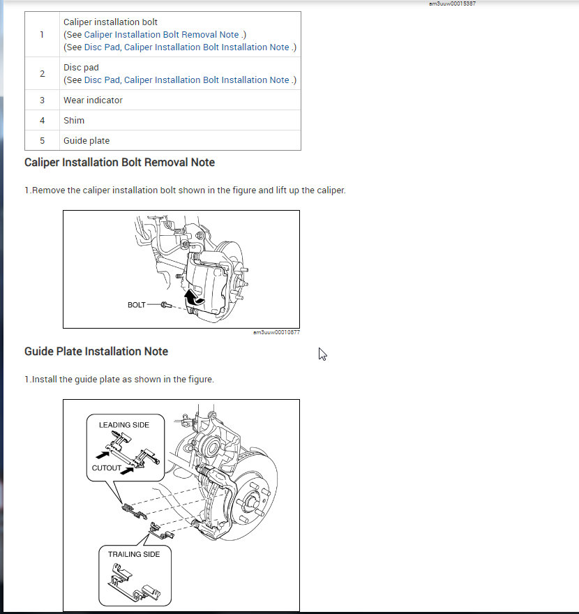

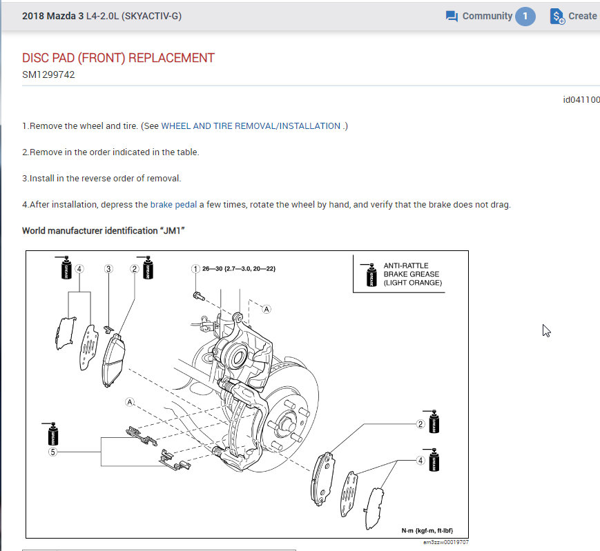

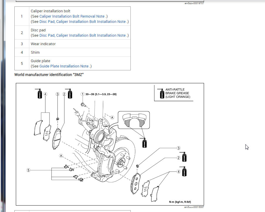

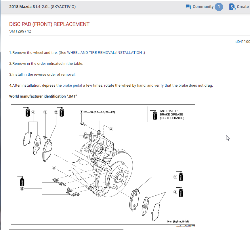

Below you will find the instructions from the manual on how to do this.
Let us know if you have questions. Thanks
