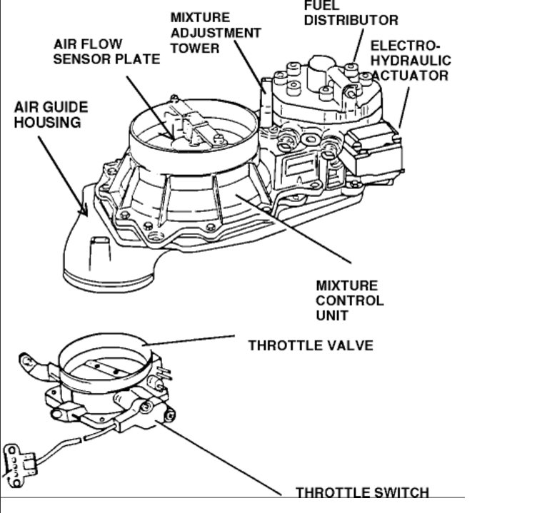

Your car might have a mixture control unit that can do the same thing. There is a year split. This unit wears causing the mixture to lean out.
You can drill the small plug out in the hat and use a long 2.5 mm Allan to readjust the mixture.
I did this all the time in the shop, back in the day.

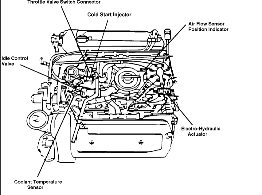

Its been a while since I worked one on of these. There is an idle control valve that sounds like is stuck or not working. Here is its locations so you can check it out.
Oct 7, 2017 at 10:53 AM
DAVID BEGGS
  • 10 POSTS
the Idle control valve was one of the first things i checked, It seems to be working good, It has been cleaned and will travel the full distance and if i apply a 9 volt battery, it closes and the car runs great. I am only getting 3.5 volts to it and when the RPM's go up to 1800 the voltage drops around 3.0 volts. When the car is running and i put a 9 volt battery on it it closes and i am measuring 4.3 volts with the battery applied and the car runs good. That was why i thought it was the computer control module and changed it out. then the ignition control module, oxygen sensor, coolant temperature, over protection relay.
it's still weird that during all this the Check engine light does not come on when the car is running and the sensors unplugged. The Image you sent is correct for this vehicle. I did most all the simple testing i think one would do. Was wondering what the MASS computer module does on this car, Also what controls and tells the warning and check engine light to come on. Still trying to get car running correctly.

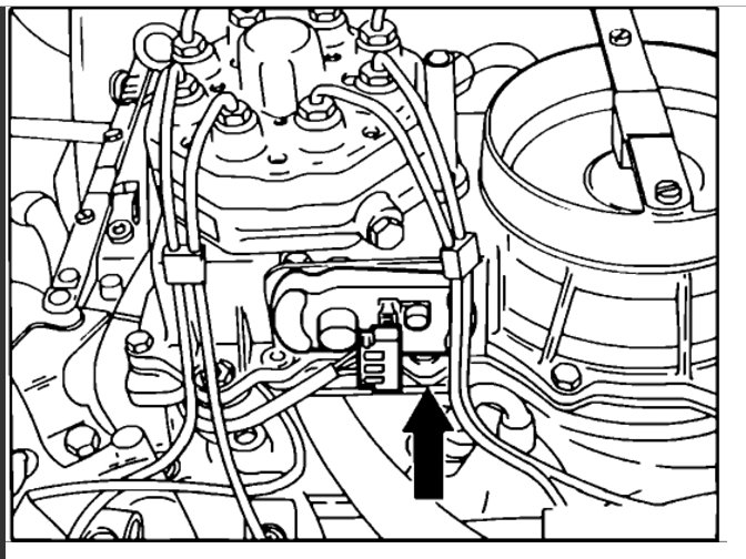

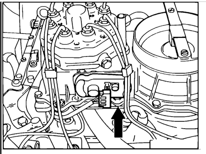

Sorry about that, I get a lot of questions. Did you try adjusting the injector hat? There is a small plug that needs to be drilled out and adjusted which controls the idle. This adjust changes as the engine ages and the vacuum changes.
Oct 10, 2017 at 11:05 AM
DAVID BEGGS
  • 10 POSTS
I drilled the plug and the very small screw was backed out or broken. I tried but can not get it to go back in. not sure if it is broken or not, i can not pull it get it out to inspect it. Is it made into the Air flow position sensor or part of the fuel hat. I will have to remove the sensor to locate the part number in case i have to order one.
