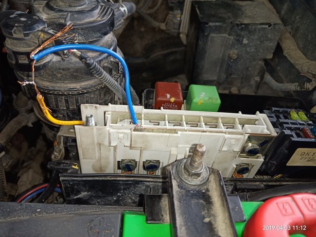

My Toyota Hilux D4D alternator fuse 100amp blows every time i start the engine. it's about two to three seconds.. The fuselink with 100amp blown.

Good morning,
Can I have your Vin number?
Where is the link located?

The problem was solved sir. thank you for replied back. it was a shorted wire, see the image below.
