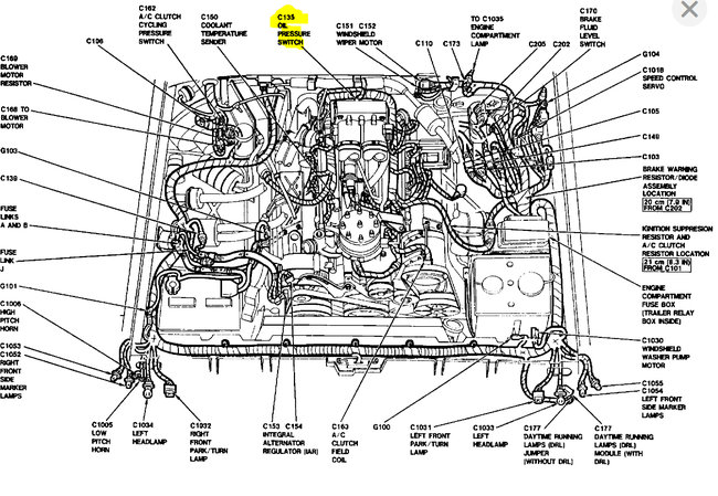

My gauge is erratic. Good oil level, low or erratic reading. Where is the sending unit located? Please
Jun 8, 2022 at 10:50 AM
SQM
CERTIFIED EXPERT
6,383 POSTS
The oil pressure sending unit is located on the back of the engine between the engine and firewall.
https://www.2carpros.com/articles/high-or-low-engine-oil-pressure
I have attached a diagram below for your reference.
Let me know of any questions.
Thank you.
Image (Click to enlarge)
Jun 8, 2022 at 2:43 PM
[email protected]
MEMBER
3 POSTS
That says it's a pressure switch. I have a gauge though. Are the switch and the sensor in the same place?
Jun 8, 2022 at 3:35 PM
SQM
CERTIFIED EXPERT
6,383 POSTS
It is the same sensor. It does not call for a secondary sensor.
Jun 8, 2022 at 4:44 PM
[email protected]
MEMBER
3 POSTS
I found it. thanks
