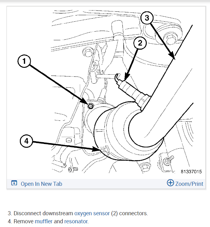

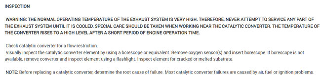

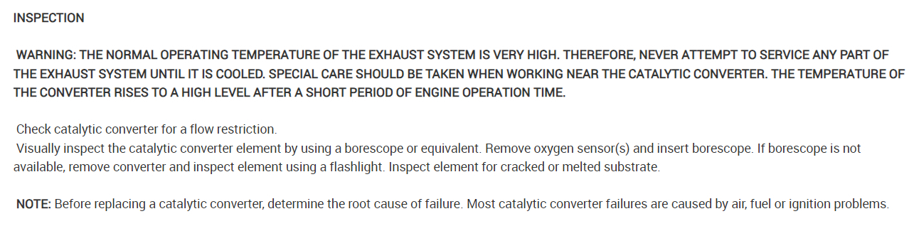

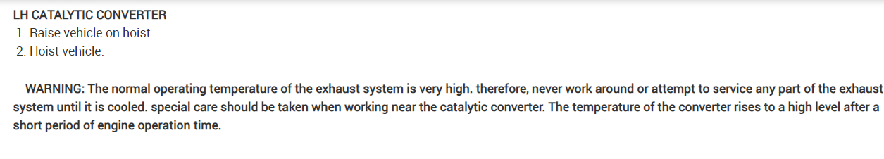

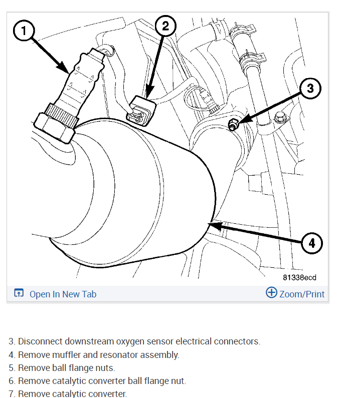

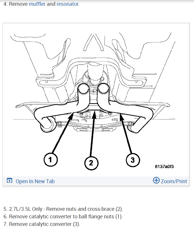

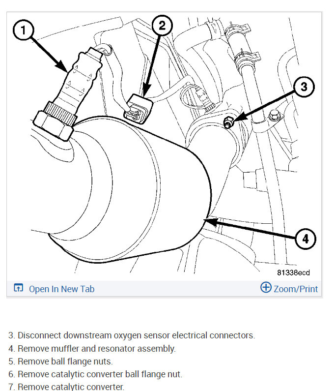

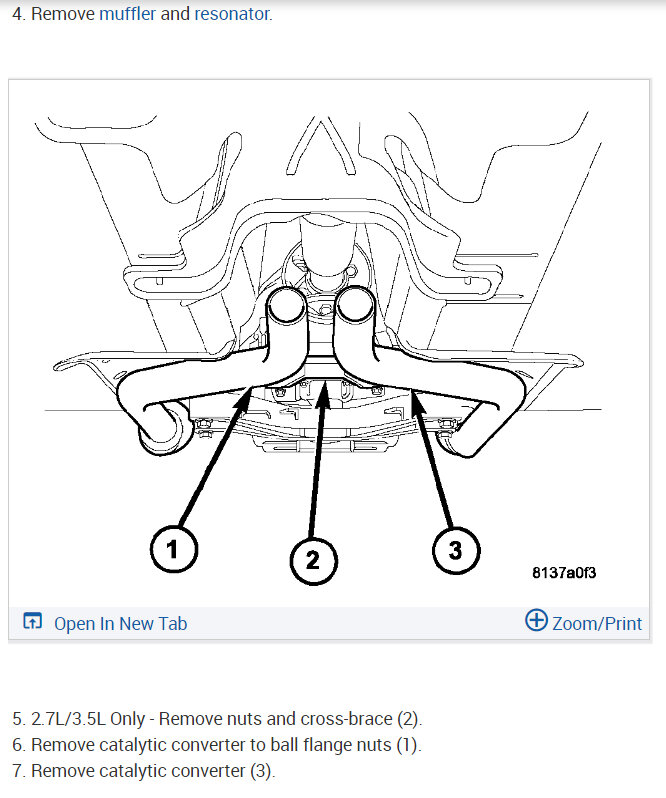

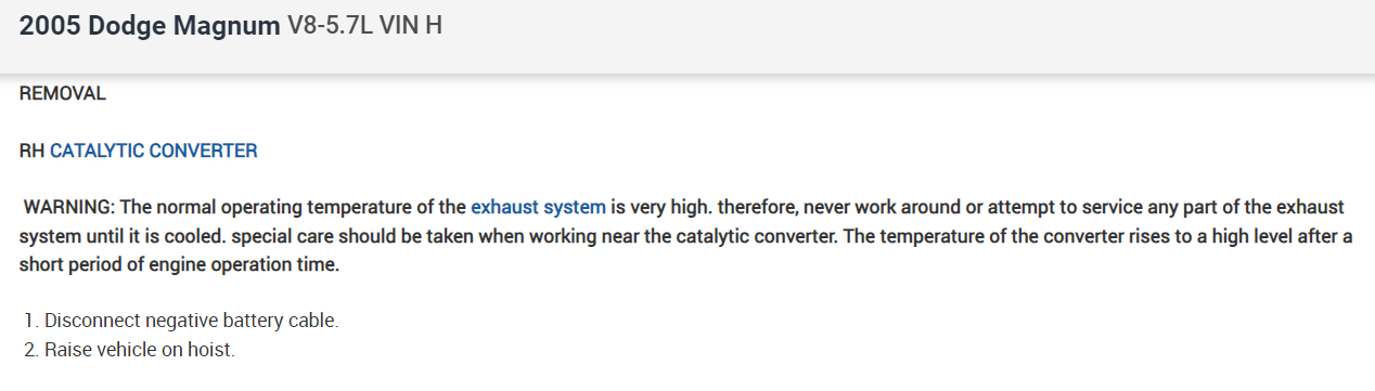

This happens when the catalytic converter falls apart internally and cloggs the outlet, one has two primary catalytic converters so you will need to check both of them, here is how to do the job physically. Check out the images (below). Please let us know what happens.
Apr 7, 2024 at 7:30 PM
