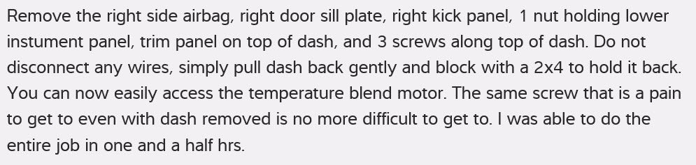

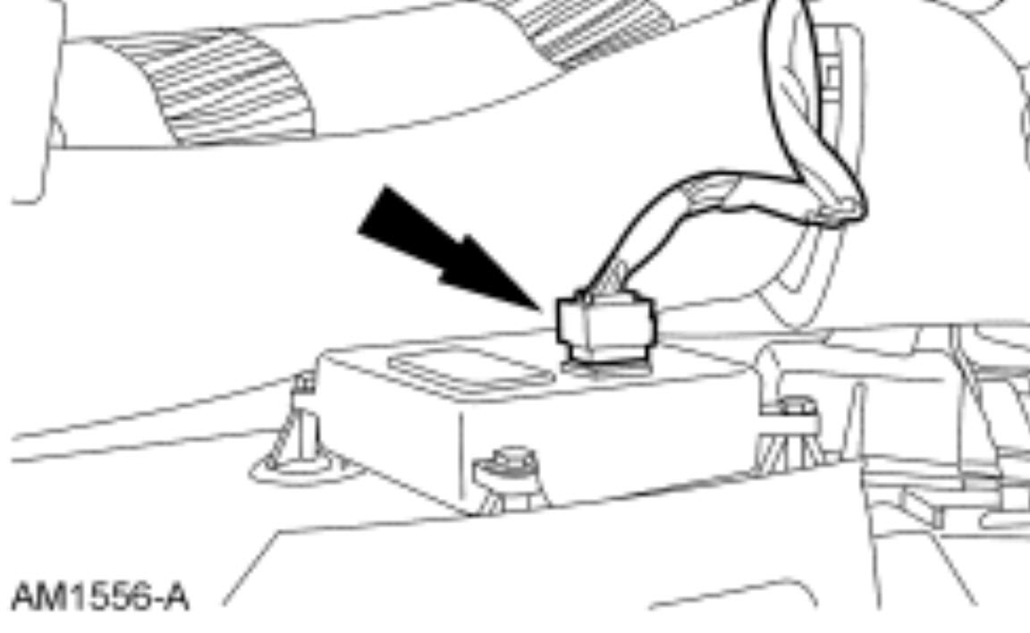

try pulling fuse with key on first it may reset. then check for a broken door which dash and HVAC unit will need to come out to fix that. manual says to remove dash and console, but picture shows a shortcut, but you have to remove the airbag on right side. so if not familiar with working with those I would advise having it done professionally.
