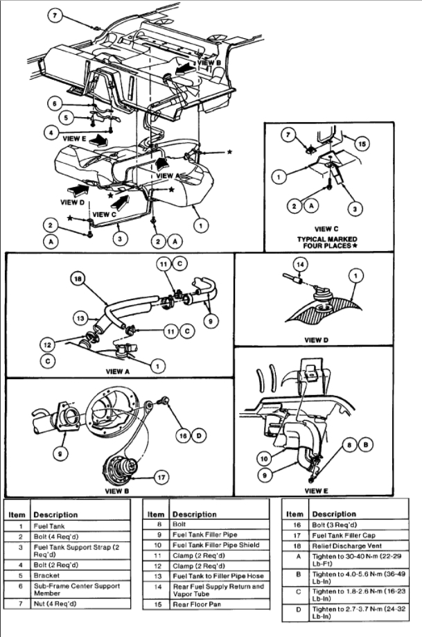

Yes, it sounds like you need to replace the fuel pump.
Here is a guide and some diagrams to help you get the job done:
You will need to raise the car up safely to begin.
and this guide will give you an idea of what you are in for when doing the job.
Diagram (below)
Please let us know what happens and upload pictures or videos of the problem.
