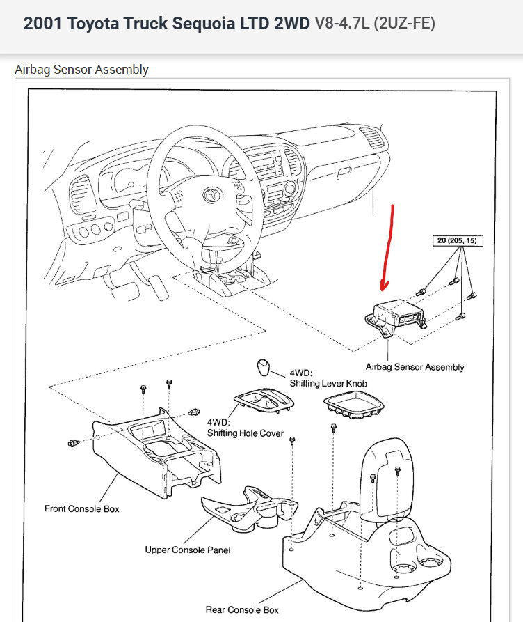

I would remove the connector at the LH airbag and the module to look for corrosion. If everything looks okay, I would replace the module. Here is the location of the module. Check out the images (below). Let us know how it goes.
