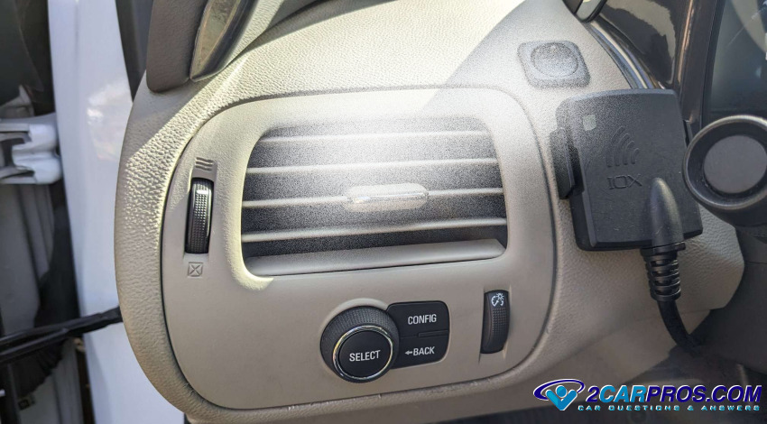

Lets say you are driving along and you notice the air flow from the HVAC system vents starts to slow down, you also noticed a light fog with the problem as well. If you let the problem go the air flow stops while the ice/fog increases. This seems like the system would be working too well and you are correct, but this only lasts for a few minutes until the evaporator ices up completely so air can no long be passed through it nor out of the vents. You can shut off the system to allow the evaporator to thaw out which will allow it to start working, but it will soon ice up again. This guide can help us fix the problem which is easy to do in most cases.

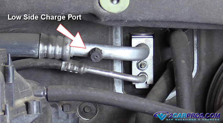

At the auto parts store or Amazon you can purchase a simple AC recharge kit to add a slight amount of refrigerant and follow this simple AC recharge guide. To help find the low side charge port on your car which is where the refrigerant is added use this video to show you how or ask one of our experts. This port is located on the low side or return line from the firewall to the compressor.
