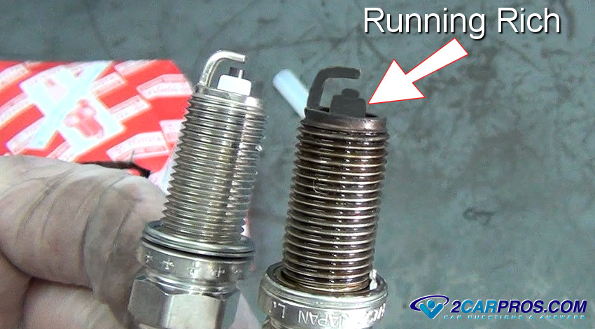

1. Leaky Fuel Injector: A fuel injector is meant to disperse fuel into the combustion chamber at the correct time and then shut off. If the internal valve inside the injector fails it will allow fuel to enter the engine continuously creating the rich condition. This is easily found by removing the spark plugs and look for one that is much darker than the rest. This will be the cylinder that is having the issue and needs the fuel injector replaced.

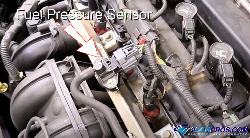

2. Bad Fuel Pressure Sensor: Newer cars are equipped with a fuel pressure sensor which helps the engine computer regulator the amount of the fuel entering the engine, when this part goes bad it can give a P0088 or P0191 trouble code. This sensor is located on the fuel rail most of the time and is easily changed.
