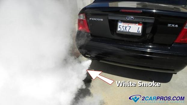

There are different levels of white smoke/steam which could be a normal occurrence. A small amount of water is produced as a normal bi product of the combustion process and until the exhaust system warms up the water evaporates and can be seen as steam. When an engine heats up under normal driving conditions the exhaust system will get hot as well. After the engine is shut off and allowed to cool the air inside the exhaust system becomes cooler as well which draws in moisture/water. This is normal and is why exhaust systems have small holes at the rear of the muffler to allow water to drip out. When the engine is again started the exhaust system will heat up evaporating the water causing steam. In cold weather a moderate amount of white smoke/steam the first 10 to 15 minutes of run time is not unusual. The image above shows an abnormal amount of steam which indicates a problem.
