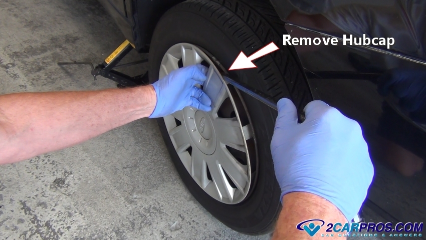

There are typically two types of wheel covers which can hinder the removal of the lug nuts and wheel. The first is the complete hubcap which needs to be removed to gain access to the lug nuts. Using the opposite side of the vehicle's lug wrench or a large flat blade (standard) screwdriver, wedge the tip in-between the cap and the rim of the tire. Twist the lug wrench or screwdriver back and forth to start the removal process.

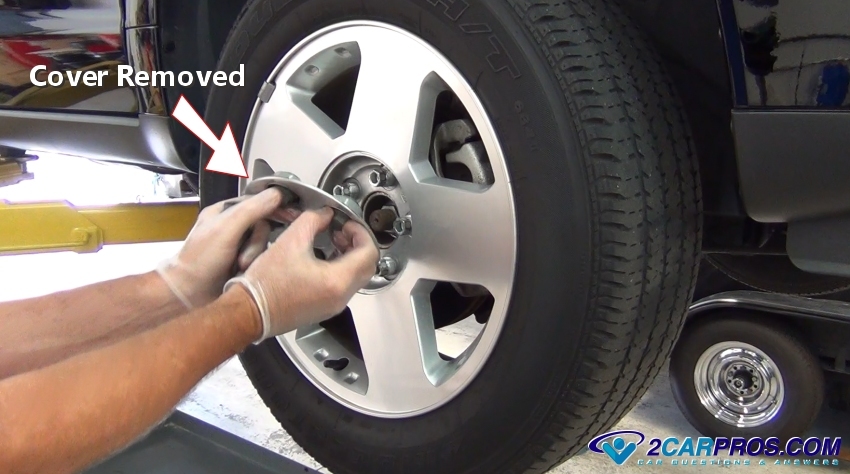

Here is an example of a lug nut cover on an aluminum wheel which has plastic covers over them which must be removed. These plastic covers can be made to resemble lug nuts and actually thread onto the metal lug nuts that hold the rim on. Each of these must be removed before the center cap will come off.
lug nut cover removed

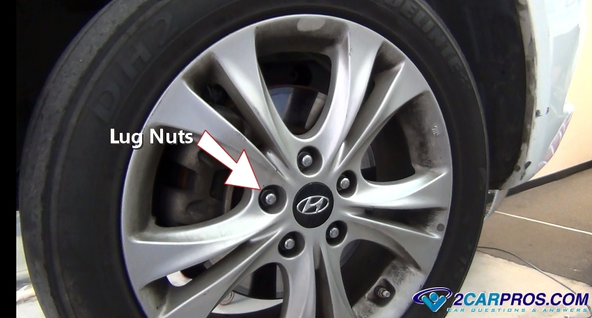

This style of alloy or aluminum wheel has the lug nuts already exposed and is ready for removal without any additional preparation.
lug nuts on an aluminum wheel

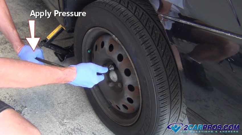

The first step in removing the lug nuts is obtaining a tool capable of doing so. This could be a lug wrench which is supplied in most cars by the spare tire. Most mechanics prefer to use a breaker bar which is basically a large socket wrench that will give you additional leverage over a traditional wrench or socket and ratchet. This bar is usually not included in a typical tool set and will need to be purchased separately along with a set of 1/2 drive deep well sockets. Wheel lugs sizes can range from 17mm, 18mm, 19mm, 21mm or 3/4 inch or 13/16 inch in most cases. Set the jack in place and lift the car slightly, this will allow the suspension to travel downward from the vehicle but not enough to lift the tire off of the ground. While the tire is touching the ground, apply downward pressure to the lug wrench while holding the pivot point of the wrench steady. One thing you do not want to do is pull upward on the lug wrench, this will cause uneven pressure to your lower back and can cause pain. To remove the lug nuts turn them counterclockwise, these nuts will be tight so be ready.

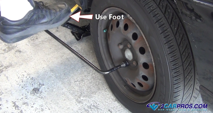

Some lugs can be rusted or over tightened. In this case you may need to use your full body weight to step on the lug wrench. Make sure the lug wrench or breaker bar is fully seated to avoid rounding. Be careful doing this because there is much more pressure being applied. Continue breaking the lugs loose until all are done, then loosen about one full turn. This will ensure that once the tire is in the air you will have no problem completely removing the nuts, do not remove the nuts fully at this time.
use foot to remove lugs

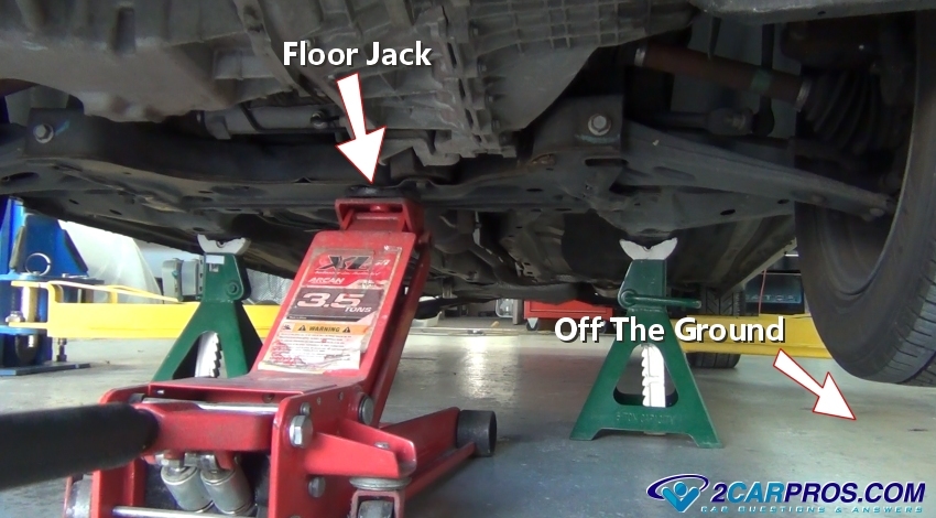

Continue lifting the car until the tire is no longer touching the ground, in this instance we are using a hydraulic floor jack which is more stable than a scissor jack that is supplied with most vehicles, stabilizing by using jack stands for safety.
tire off the ground

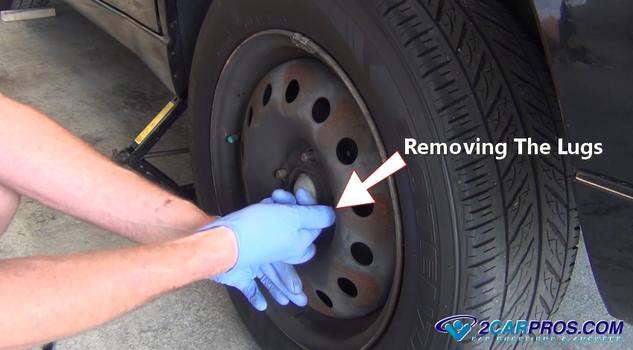

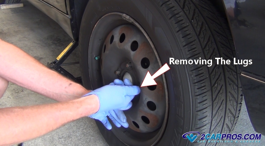

Continue to remove all of the lug nuts either be hand or using the lug wrench or breaker bar, a regular socket and ratchet can be used at this time. Some European models such as Mercedes Benz, BMW and Porsche will use lug bolts which when removed will allow the tire to fall because there is no wheel stud to hold the rim in place, be ready to grasp the wheel when removing the lugs. If the wheel seems stuck this is because rust has accumulated between the hub and rim, using your foot, give the tire a swift kick, this should break the wheel loose from the hub.

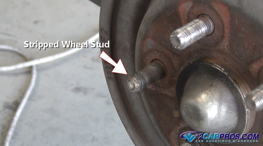

Check the lug studs and replace any that are damaged. Also, wipe off the mounting surface on both the wheel, rotor or drum, clean any dirt, rust or grease before the wheel is reinstalled.
stripped wheel stud

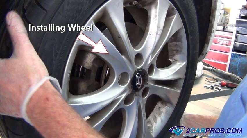

Reinstallation: Grasp the tire and gently reinstall it onto the wheel studs so as to not damage the threads. Some European cars you will need to hold the tire in place on the wheel hub and then align the rim with the threaded lug bolt holes, you may need to jockey the rim around a bit to line up the holes.

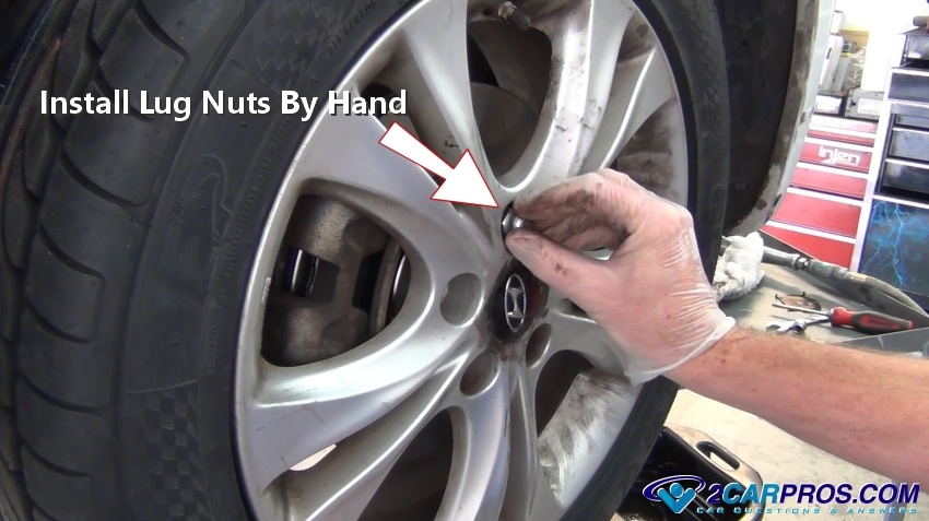

Push the wheel on until it rests flush against the rotor or drum flange, install the lug nuts onto the studs by turning them clockwise. Do not start the lugs with a socket or impact gun, this can cause cross threading. Continue installing the lug nuts until all have been started at least two turns. Do not use grease on the lug nuts, if rust exists on the wheel studs use a wire brush to remove it before installation.

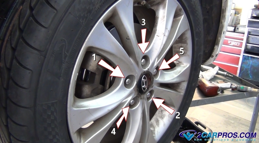

Start the initial tightening by following a star pattern. This will ensure the wheel will be tightened evenly which will avoid warping. You can use a normal ratchet and socket for this while holding the tire by hand. In the next step the wheel will be tightened completely.
tighten lug nuts in a star pattern

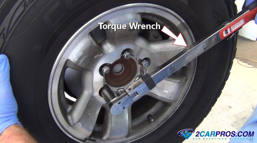

Lower the car just enough for the tire to touch the ground which will hold it from spinning while it's being tightened. Use a torque wrench and set it to manufacturer's specifications which is usually 70 to 90 foot pounds for passenger cars, and 100 to 120 foot pounds for pickup trucks and large SUVs. Finish tightening the lugs in a star pattern while listening and feeling for the torque wrench to click signaling the proper tightness has been achieved. If a torque wrench is not available, tighten the lugs evenly in a star pattern, go over the lugs twice to ensure they are all tight. Reinstall the hubcap or lug nut cover and remove the jack. A hub cap will have a relief for the valve stem, take note and install it correctly. Be careful not to apply excessive pressure on the cover to avoid breakage. Once the job is complete listen for any strange noises while the vehicle is in use. A loose wheel will make a clicking or ticking noise when rolling at low speeds. Recheck the lug nuts after a day or two of driving to make sure they are secure. After installation is complete check the tire air pressure, this will help the tire perform its best.
torque wrench
