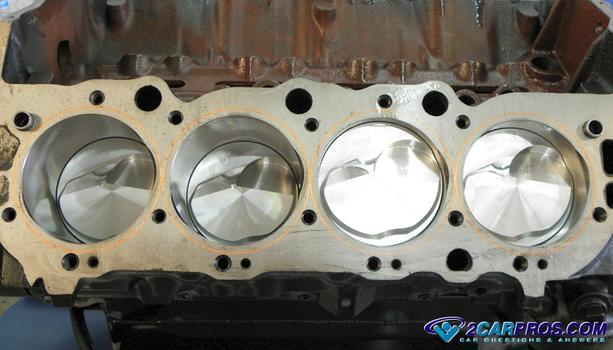

Engine Compression
Engine cylinder compression is the pressure generated within the engine's cylinders when the piston compresses the air-fuel mixture. This compressed mixture is then ignited, producing the power needed to drive the engine. In general the more compression an engine has, the more power it will produce, but there is catch, if compression is too high it will cause the engine to "ping" or "knock" as the control burn of the fuel becomes unstable.
The compression ratio of an engine is determined by the cylinder bore volume divided by the cylinder head combustion chamber volume which can be 8:1, (eight parts volume in the cylinder, to one part volume inside the combustion chamber). With direct fuel injection engines, for both gasoline and diesel fuels, the compression ratio can be 13:1 and up to 25:1.

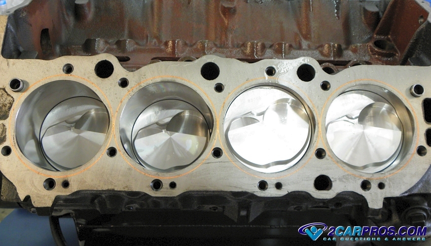

Factors That Influence Cylinder Compression
Several factors contribute to engine cylinder compression, including:
  • Piston Rings: These seal the piston to the cylinder wall. Worn or damaged piston rings can allow compression to escape.
  • Valves and Valve Seals: Intake and exhaust valves need to close completely to maintain compression. Leaking valves or seals can reduce compression.
  • Cylinder Head Gasket: A damaged head gasket can lead to compression loss between cylinders.
  • Cylinder Wall Condition: Worn or scored cylinder walls prevent effective sealing, reducing compression.
  • Combustion Chamber and Piston Dome Designs: These factors are directly related to the compression ratio.
