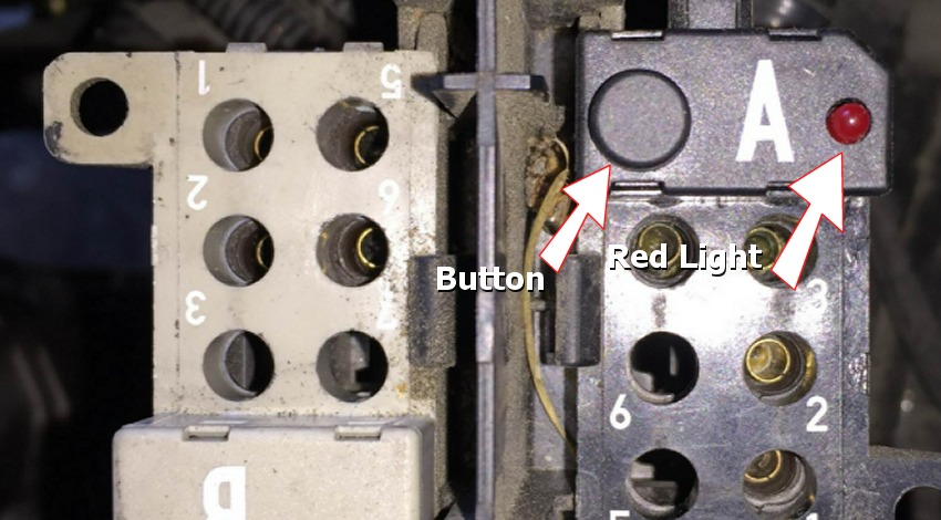

Locate the diagnostic box which is usually under the hood near the left strut, this box is about two inches by four inches.
vovlo obd1 code box
Remove the protective cover and locate a button next to a red led light, start the code gathering procedure by turning the ignition key to the on position without starting the engine, push the button down for three seconds.
The check engine light will flash a number of times, followed by a three second pause dividing the trouble code digits. For example; the light blinks once, then pauses, blinks two more times, and pauses and then finishes with five more blinks, the trouble codes will be 125.
After repairs have been made, clear the codes by turning the key to the on position without starting the engine, push the button down for five seconds and release, after three seconds the light will illuminate, press the button for five more seconds and release, the codes should be cleared, the codes can also be cleared by disconnecting the battery for 2 minutes.
