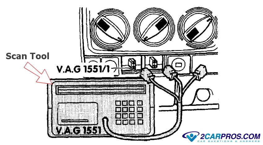

We are a team of ASE certified mechanics who have created this guide to help you retrieve OBD1 trouble codes for your Volkswagen with the definitions below. To start you must locate the diagnostic connector located in the center console or the trunk, you will also need two wire jumpers. Some vehicles will not allow the codes to be read without using the manufacturer's scan tool.
obd1 volkswagen scan tool

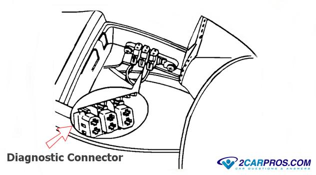

Insert a jumper wire into the black connector and run it to the other black connector, do the same for the white diagnostic connector. It must maintain the connection for 5 seconds, then remove the jumper wires.
obd1 diagnostic connector volkswagen
