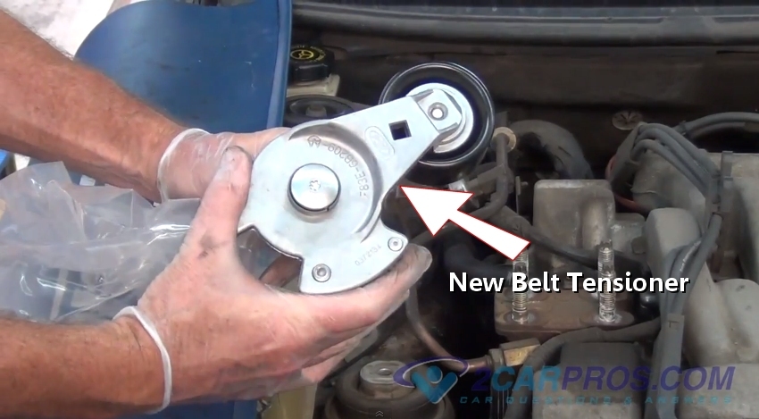

A serpentine belt tensioner is designed to keep the belt tight during the engine operation and to take up the slack as the belt naturally wears. This spring loaded pivot based part can wear allowing the belt to "bounce" as it loses and gains traction among the drive and accessory pulleys which can be seen by observing the tensioner while the engine is running, it should be relatively smooth. If you notice a large vibration the serpentine belt tensioner needs to be replaced, the serpentine belt should be replaced as well.
new serpentine belt tensioner

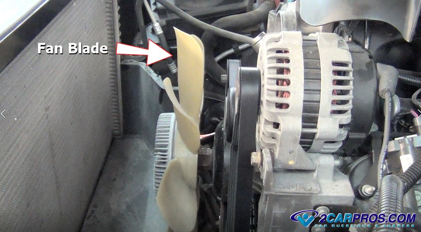

An engine cooling fan can be driven by the engine or powered electrically, both configurations can cause a vibration. Inspect the fan's integrity to ensure the blades are intact and there are no missing parts, this will cause the fan to rotate out of round which produces a vibration. Also, when a fan clutch or fan motor wears it can fail to hold the fan blade true, with the engine not running (key off) grasp the fan to check for play.

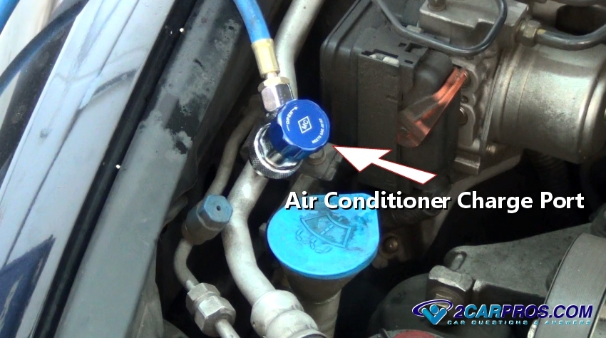

When an air conditioner is overcharged it can cause an engine vibration when the HVAC system is on due to higher than normal pressures, this causes the compressor to overwork itself creating a vibration. This can also be caused by too much compressor oil in the system. Check the internal pressures of the air conditioner system and adjust and lower the high side pressure.

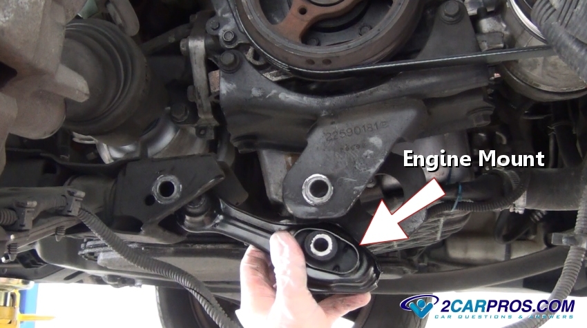

Engine mounts are a vulcanized rubber mount that the engine and transmission rests upon to shield the car frame and body from the natural operational vibrations. These mounts are two pieces of preformed metal held together by a piece of vulcanized rubber and are subject to wear and stress as the engine torques when accelerating allowing the engine and transmission to rest against the frame of the vehicle causing a noticeable vibration. The best way to inspect an engine mount is from under the vehicle using a flashlight to check the integrity of the mount, the failure will be obvious as the rubber part will be blown out, torn or missing which warrants an engine mount replacement to fix the problem. Some mounts are oil filled which will be leaking, another indication of failure.

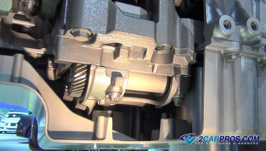

A balance shaft mechanism consists of two counter weighted shafts driven by the crankshaft, a balance shaft belt or chain is used to rotate the shafts to counteract vibrations created by the natural characteristics of the engine's operation. The belt or chain can break or become out of synchronization with the crankshaft either by worn timing components, or a possible misalignment when assembled. To inspect for this problem, remove the timing belt cover and inspect timing belt or chain marks for proper alignment. These shafts can also be driven from an independent balance shaft belt or chain which can be separate from the camshaft timing belt or chain. If the balance shafts are non-operational due to mechanical failure or wear the engine will vibrate, here is an image of the engine balance shafts which can cause a rattling noise when bad as well.
balance shafts

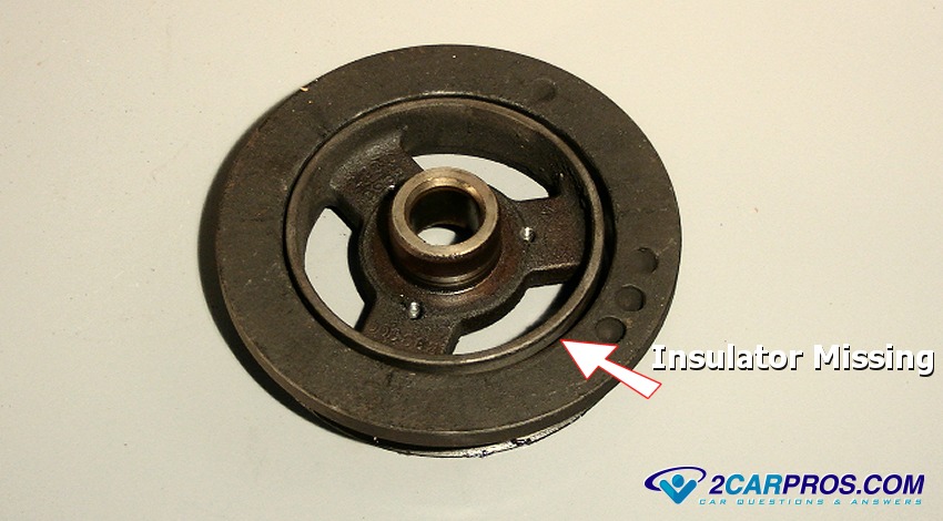

Engines are designed to be internally or externally balanced, this is achieved by counter balances in the harmonic balancer or the flywheel-flex plate. If one of them has a problem or the incorrect parts have been installed the engine will have a noticeable vibration. Below is an image that shows a harmonic balancer that has come apart which can produce an abnormal noise.
failed dampner

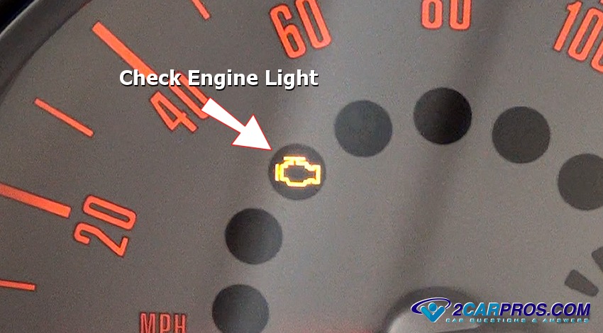

When an engine misfire occurs it will cause a vibration which will begin happening when the engine under load or acceleration, all engines are symmetrical and when part of the cycle is missing the engine becomes off balanced. This can trigger a check engine light which can help detect the particular cylinder having the issue.

Front wheel drive vehicles are designed with an additional engine mount called a torque mount, this mount helps control side movement of the engine while under acceleration. When a torque or support mount fails it will start allowing the engine to move excessively causing damage to the CV axles while producing a vibration. To check for this problem lift the hood and observe the engine, then have a helper start the engine and while applying the brakes shift the transmission from reverse to drive, the engine should move slightly. If excessive movement is noticed the torque mount is bad and needs to be replaced.

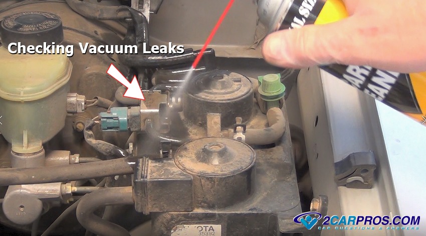

Vacuum leaks are a major source of engine idle vibrations, this is because when an engine is at idle it depends on the intake system to hold said vacuum more than any other time of the engine's operation, (when an engine is under load, the vacuum is reduced). Most of the time a broken vacuum line can be easily observed. To test for a vacuum leak start with the engine cool and allow to idle, use carburetor cleaner and lightly spray around the vacuum hoses (avoid exhaust manifolds) if the idle speed increases you have located the source of the leak.
checking for vacuum leaks

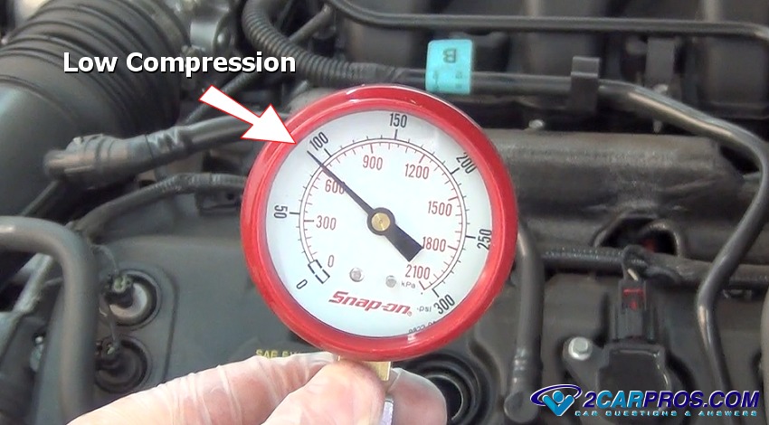

Low compression in one cylinder can cause an engine vibration at idle, this is because an engine depends on an equal amount of compression in each cylinder to run smoothly. If a tune up has been done recently and you think this can be the problem a compression test needs to be performed.
low compression

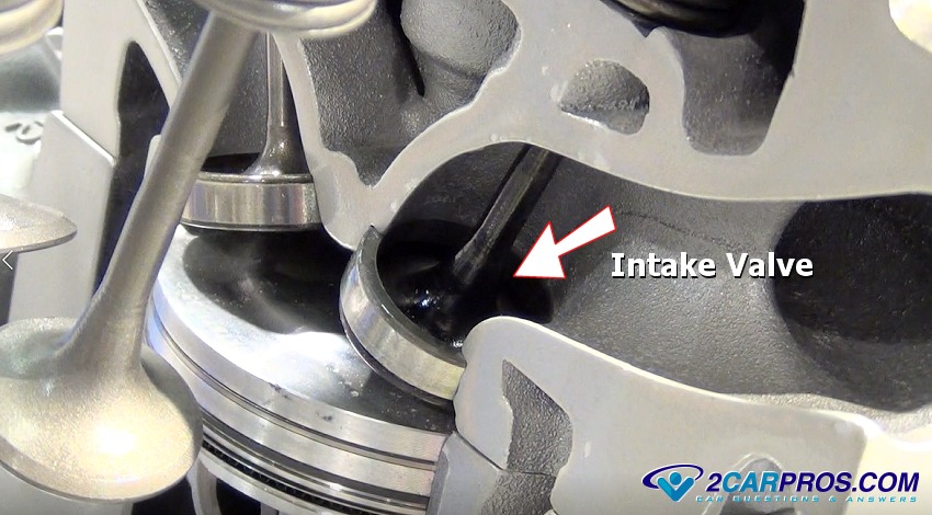

The intake valve must seal completely for the engine to run smoothly at idle, if an intake valve leaks it will allow exhaust gases to enter the intake manifold and into the intake charge of the additional cylinders causing a vibration at idle. To test this condition a leak down test must be performed, if positive results are produced for leakage, a valve job is required.
intake valve
