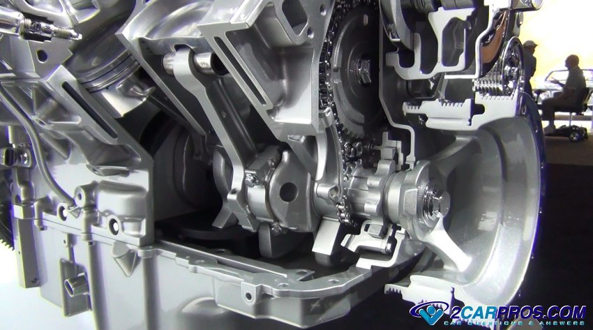

engine scraping noise
A scraping sound is typically created when metal is contacting metal during linear or rotational movement. Rotating objects are generally prone to scraping noises because they have close tolerances and are positioned near stationary objects. Some scrapping noises are easily fixed by re-positioning a particular brace or shield while bearing failures need to be replaced.
