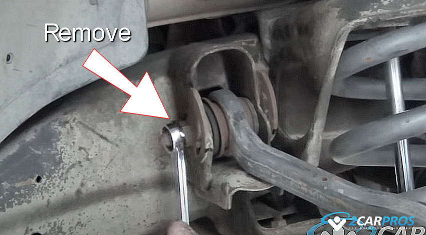

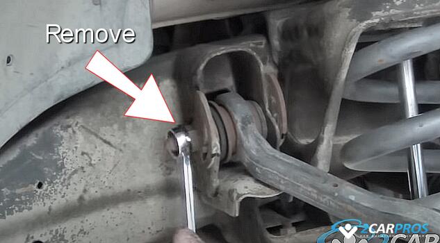

3. Remove Upper Control Arm Bushing Bolts: Mark the alignment adjusters using a felt pen and reference these marks when reassembling. Other designs will use a shim or a series of shims which must be reinstalled as they were removed. Use a 18mm wrench or socket (size may vary) to loosen and remove the nut on either side of the arm.
remove upper control arm frame bolt

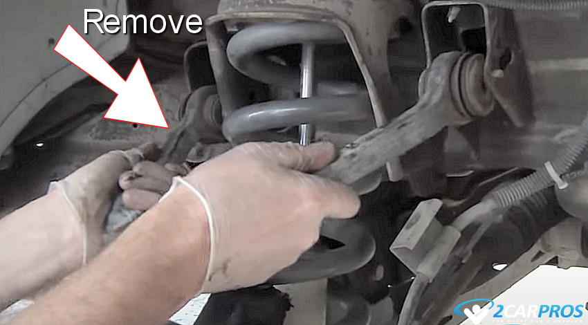

4. Remove the Upper Control Arm: After both nuts have been removed, slide the bolts from the control arm mounts while keeping the adjusters in order. To remove the control arm use a upward motion on the arm while pulling outward.
remove front suspension upper control arm

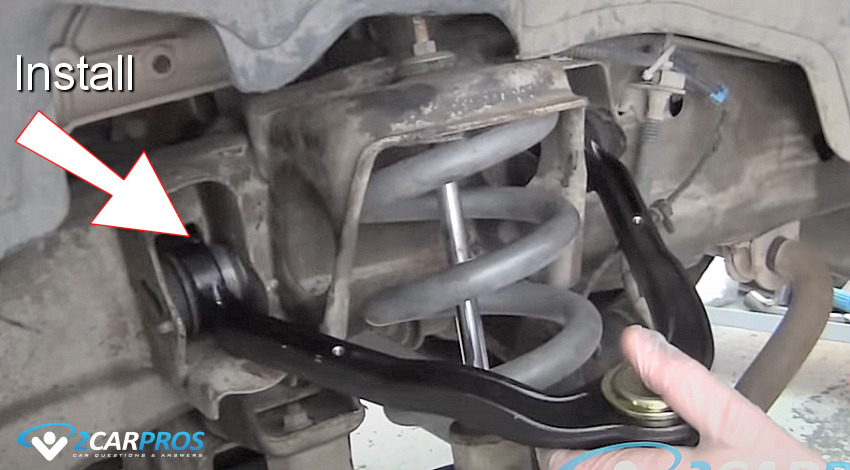

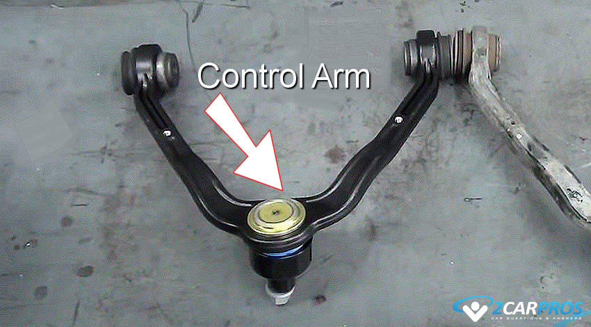

5. Install the New Upper Control Arm: Once the control arm has been removed match it against the old part to ensure a proper installation. Some control arms are designed using Zirk fittings to allow lubricant (grease) to be injected. Install the fitting and tighten it using an 8mm wrench. Install the new control arm into the frame mounts. This might take some doing while moving the arm up and down and pushing inward to line up the mounting bolts.
While aligning the bolt holes, install both mounting bolts in the same position as they were removed. Use a wrench or socket to tighten the both mounting bolts while keeping the alignment adjusters or shims in place. These bolts might be difficult to get a torque wrench on, but you want to tighten these bolts to manufacturer's specifications which are usually between 65 and 75 foot pounds.
install new front suspension upper control arm
