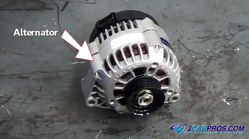

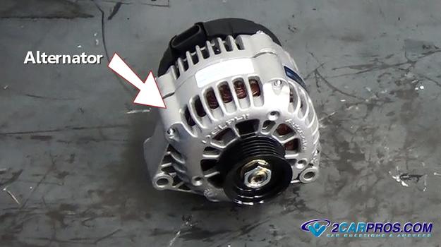

Here is what a typical alternator looks like:
alternator

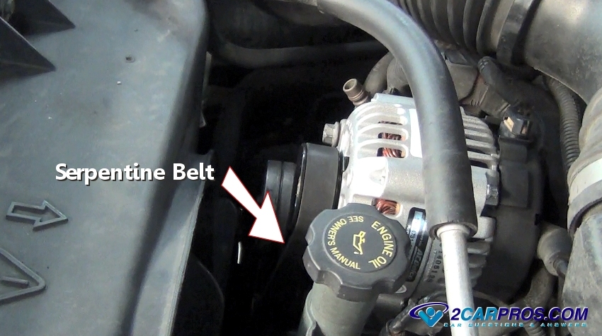

A serpentine belt is used to deliver rotation energy from the engine via the main drive pulley.
serpentine belt alternator

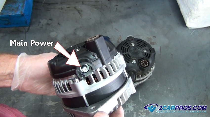

A large power terminal is used as the main voltage feed to the electrical system which is usually connected to the positive battery post or fuse box.
alternator main power lug

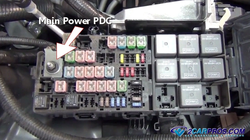

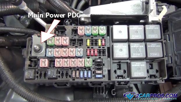

This main power feed is used to power circuits throughout the vehicle.
power distribution center pdc

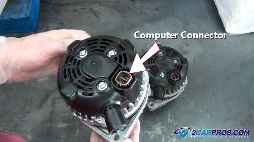

Most units are designed with a built in voltage regulator which help stabilize the voltage output.  A wiring harness connector is used by the computer PCM to control and monitor the voltage regulator during variable engine speeds (RPM's) and voltage demands.
alternator computer connector

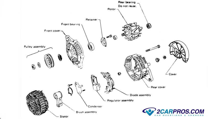

The alternator works on the principle of electromagnetism, by turning the magnetic armature inside a wire field which has been electrified to produce AC (alternating currant) voltage. A series of diodes (6) convert AC to DC voltage which is needed for the electrical system. An armature is supported by two roller bearings on either end of the alternator housing, voltage is transferred to terminals at the rear of the housing via a spring loaded brush set.
Alternator Expanded View
