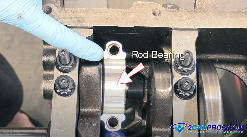

1. One of the most popular failures to cause engine knocking is a spun piston rod bearing, This can be due to normal engine wear (high mileage) or low oil pressure, dirty oil, low oil level, or overheating. In the following failures the engine will need to be disassembled and re-machined.

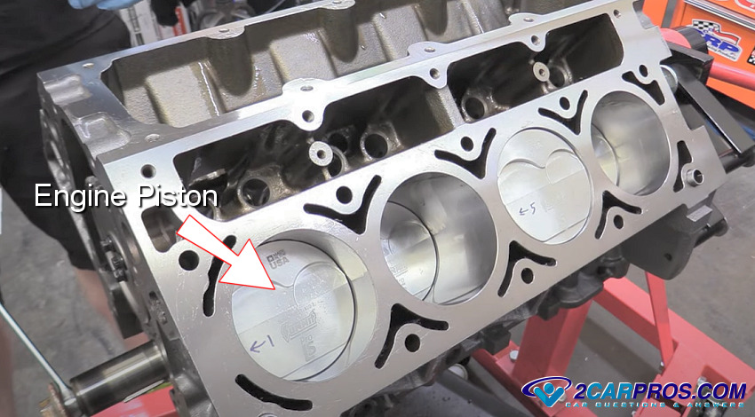

A piston can fracture and crack, affectively working in separate pieces which will cause a knocking sound when in operation, this must be repaired with a new piston.

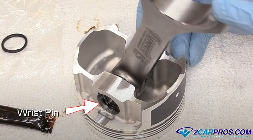

A wrist pin is used to serve is a pivot while attaching the piston to the piston rod. These pins can seize not allowing the isolating motion of the piston while traveling inside the cylinder bore. When this happens a knocking noise will be produced as the piston is slapping (knocking) against the cylinder wall.

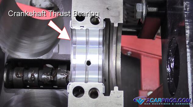

The crankshaft thrust bearing is used to retain the crankshaft in the center of the engine block while rotating. When this bearing degrades excessive clearance is obtained and the crankshaft will "wonder" back and forth inside the engine block while producing a knocking noise. This sound will not be as prominent as the aforementioned failures.

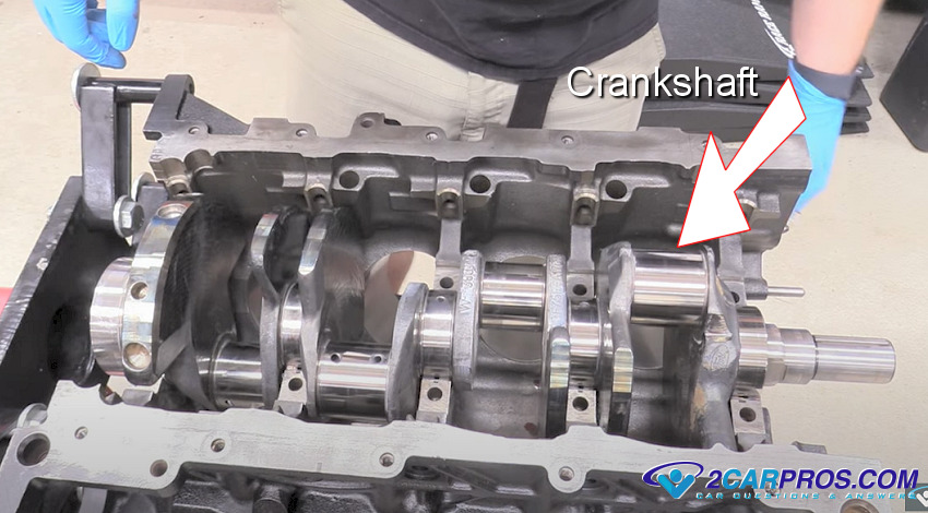

A cracked crankshaft, though rare, can fracture in half at a main or piston rod journal. This failure is difficult to detect without a complete engine teardown and will require a new or re-machined replacement crankshaft with new rod and main bearings.
